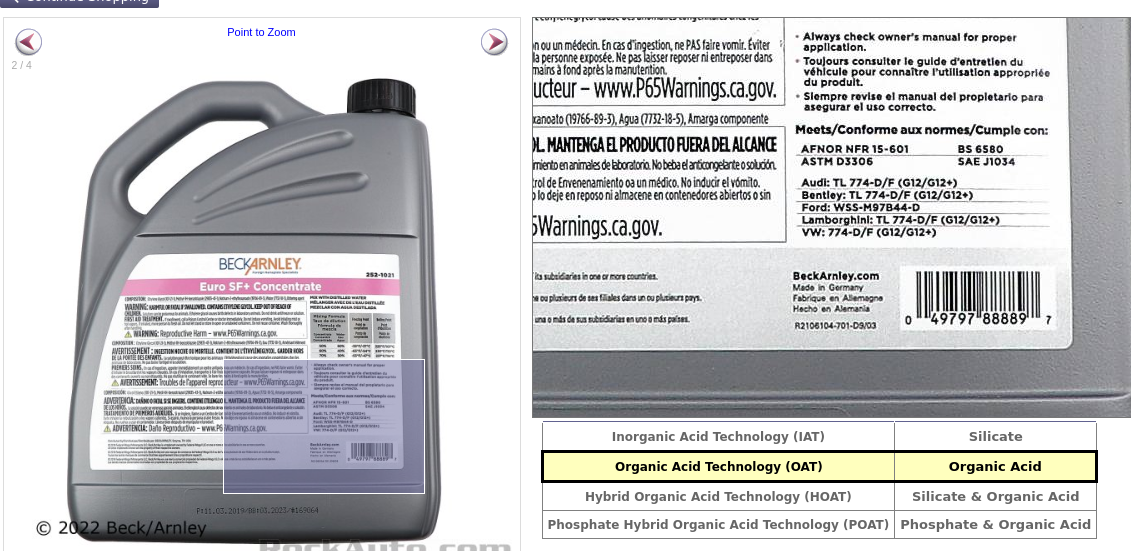

Lesson two - grab a ford spec coolant - WSS (it is pink in color). Without trying to find the exact spec for the particular engine I had this was good enough as long as I was doing a full flush.
I got the BECK/ARNLEY 2521021 (252-1021) concentrate from rock auto and in the few months since I've been using it the cars been working great.
Select a coolant is more art than science, get a coolant that is a ford spec and don't mix coolants. One can over think step 1 and worry about it endlessly.

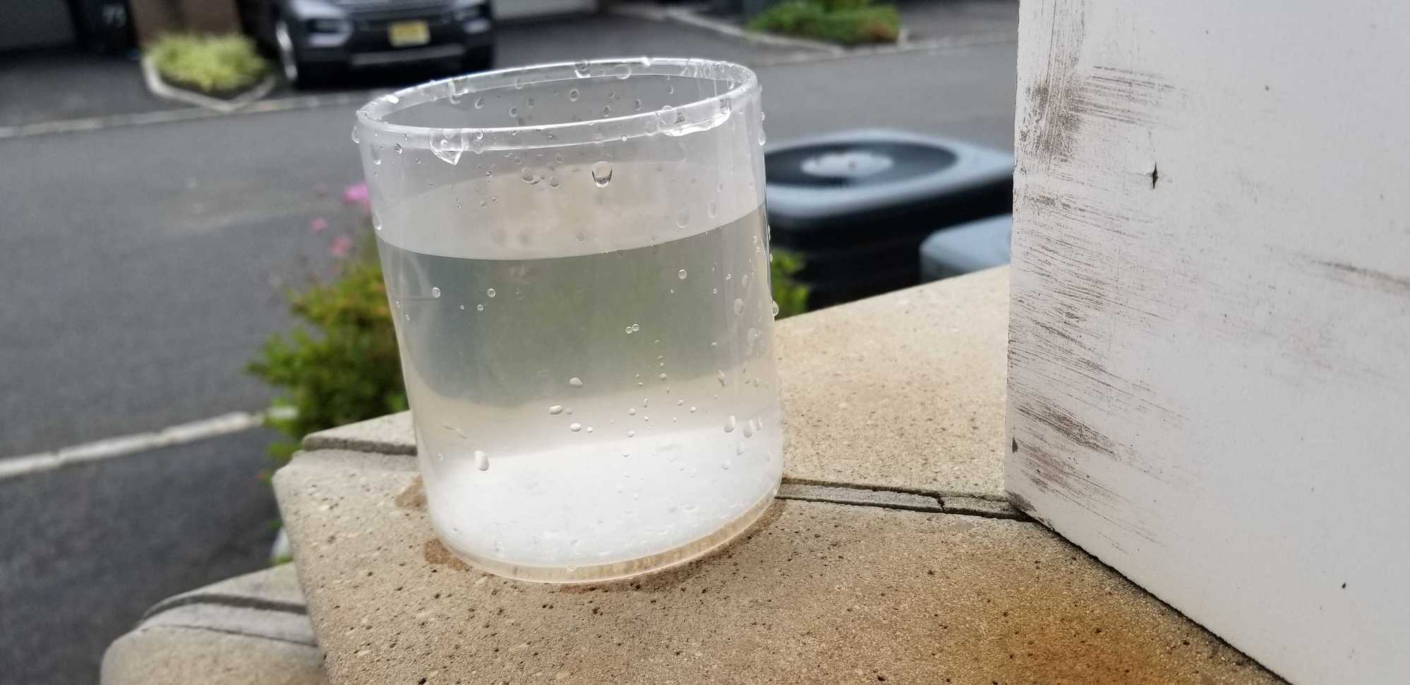

After a while about 4 flushes I started making progress, the liquid coming out was beginning to clear but was hazy. At this point I was back on the forum - there must be a better way to flush the coolant in the engine block. There was

Lesson three - flushing the coolant is going to need patience and repetition.
Back to the internet to see if there is a way to speed this up the 30-40 minute cycles, using jack stands was both tiring and tedious. At this point I noticed on YT (channel chrisfix) video when doing the flush chris removed the thermostat to speed up the flush. Seems like a good idea and I went ahead and did that. Can't say that I thought this through at the time, would running coolant thru a cold engine cause issue? Well, it didn't and it did speed thing up. Was it worth it? NO - I don't think I saved more than a couple of drains - I wouldn't recommend it, but it caused no harm to my car.
You can see pictures of my progress with each flush on some of my previous posts. Here is the result of the final flush - this took me about 10 flushes. Looks clear enough for me.

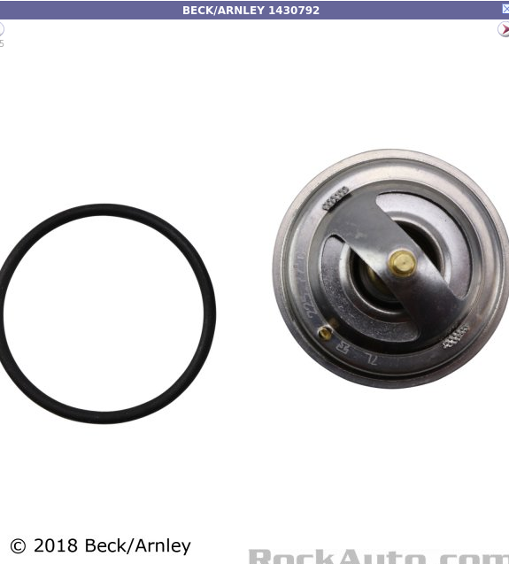

I went ahead and purchased a new thermostat. Nothing but the most expensive thermostat I could find on rockauto for my car - (it was only $2 more than the rest)
This wasn't a great choice. On the existing thermostat the gasket had a slit in the center and went around the edge on the thermostat. This made the thermostat and gasket sit nicely in the housing. This one had a gasket that just sat on top, making it difficult to hold it in place vertically while you installed the thermostat cover, it also resulted in a little bit of play in the thermostat when placed. So it was going to have to be the old gasket with the new thermostat.
Lesson five - watch out for small issues that ain't quite right even when you spend the most and will cause pain if you miss them.

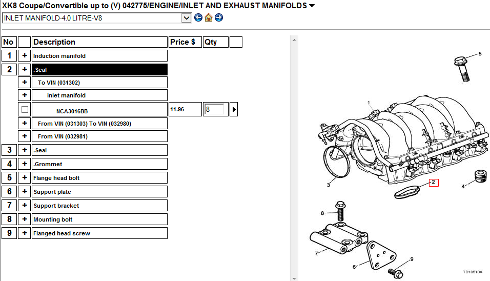

Now this is where the fun really begin. The back bolts holding the thermostat housing down aren't easy to get it. The intake manifold gets in the way. Off to the forums and YT videos to do a lot of research. I've seen a lot of videos by @O&DR on xk8 and had learnt quite bit from those so that was the first place to look. Sure enough they had a video, which starts with - this is the intake manifold method recommended by bob motorcarman on the jaguar forms. Release a few bolts lift the intake manifold and get access the back bolts, easy enough. Lets do this.
And ... the intake manifold won't budge a millimeter. I want to be careful with this, avoid digging myself a bigger hole, back to the forum and other YT videos. I find another video where it is clear that what was in the video from o&dr isn't adequate may be even right. O&DR asks me to confirm that my engine model is correct - the vacuum actuator on the top same as in the video it is an AJ-26.
At this point @michaelh responsed to one of my queries
There are two bolts on the throttle body elbow, one each side, that may be what ungn is referring to. There is a support bracket with a triangular piece on each side, secured with three bolts. One needs to be removed and the other two just slackened. This snip from the JEPC should help, although the elbow itself isn't shown:

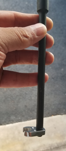

I was ready to give up and get the car towed have a professional fix it for me. But I'd already spent 3 weekends on something that should have been a few hours of work. Time to drown my sorrows in more youtube videos of people working on their xk8's. I few days in i run into an obscure 90 second video with few views of someone demonstrating the removal of the thermostat housing using a crowfoot - hell ya to the youtube recommendation algorith, hell no to how long it took to teach itself what i was looking for. Turns out, the bolts don't actually get stuck on the intake manifold there is just enough (a millimeter or two) of clearance for the bolts to come off.
After a couple of experiments with the right drive (3/8 th vs 1/4 th). I find myself a crowfoot that fits perfectly. That single crowfoot cost me $20
Amazon Amazon
But it was worth every penny. It was the only place and the only one I could find.
Lesson seven: Find the right tool and you'll make more progress and faster.
