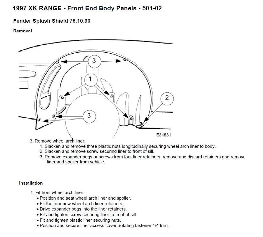

Old Aug 4, 2018 | 01:34 PM
Likes: 17,006
From the XK8 - Body Preparation for Repainting manual:
The expander pegs are the awkward ones. The centre peg has to be pulled back (NOT out!) to take the tension off the expander and the whole fitting then pulls out.
Old Aug 4, 2018 | 01:43 PM
Johnken's Avatar
Posts: 5,457
Likes: 1,816
From: New Jersey USA
Graham, thank you. The diagram is wonderful.
