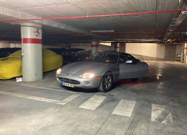

Dear Jag community,
I’m new in this forum and I certainly need your help… my father recently bought his dream car (XK8 NA coupe), the car is in very nice condition, 80.000km, but a month or two ago something odd happened when we were on vacation with the car.
The car, when he switched the ignition ON (car not running) the throttle body was making a ticking noise, like the valve was opening and closing too fast, ok it’s own.
When he started the car, it made full throttle on its own… of course we were a bit scared and put it in a mechanics garage. I know a thing or two about mechanics, though the mechanic that was supervising the car told my father he needed a full new or refurbished throttle body…
But that didnt convinced me… that must be a way to change some sensor that is faulty, im not sure if they diagnosed throughly the car.
Does anyone has any clue on what the car might have and the troubleshooting that we need to do?
Thank you very much for your help.
