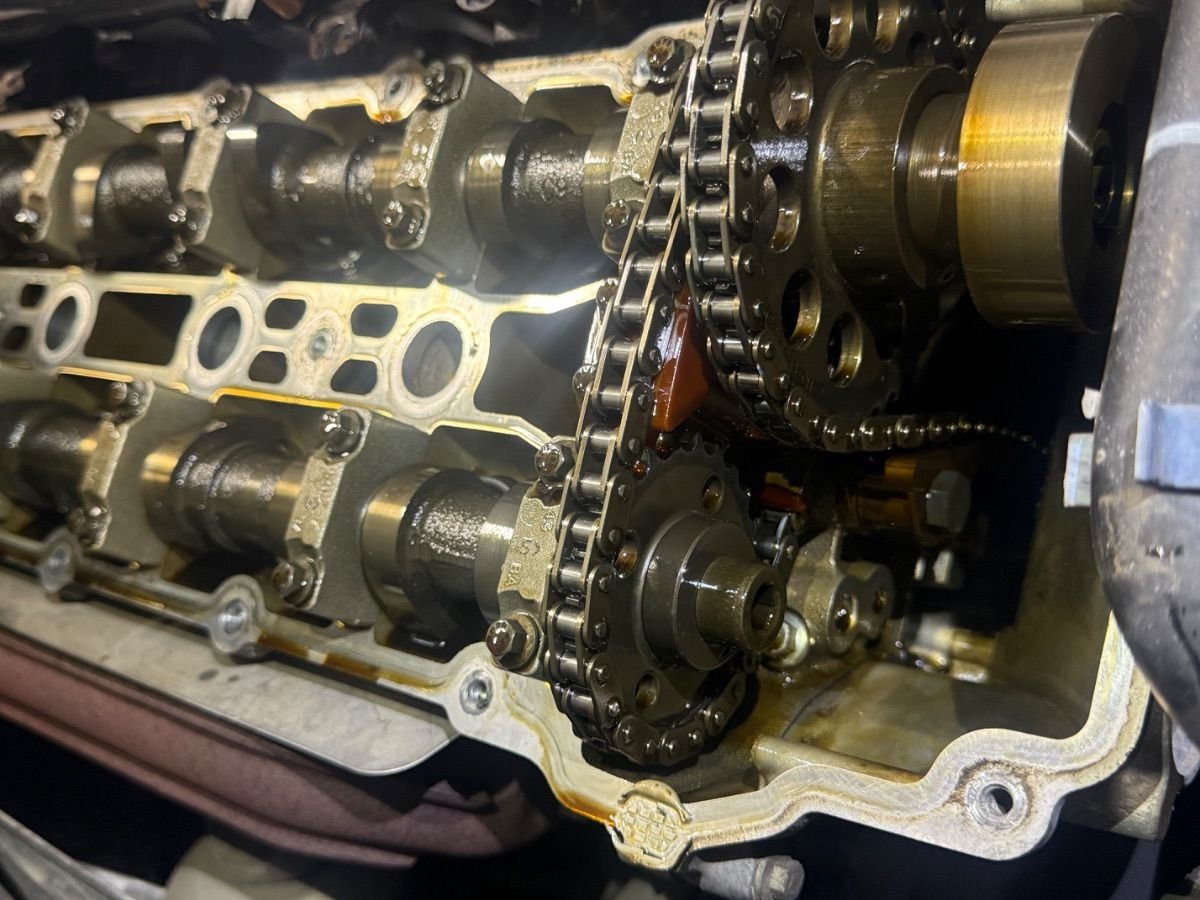

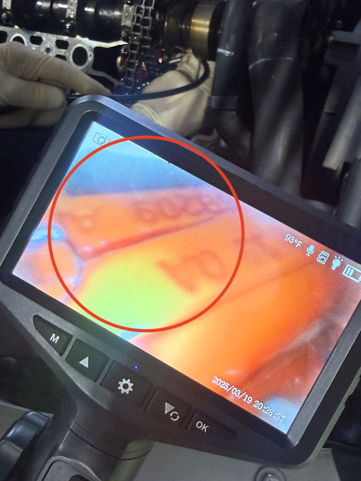

Does anyone know where I can find a breakdown for shop times on different repairs? I bought a 2001 XKR Silverstone knowing it might need the Timing Chain Tensioners done (I took a chance and got an appropriate discount on the purchase price of the vehicle). The car has driven wonderfully with the exception of an intermittent misfire. As the paranoia set in (regarding the tensioners), I recognized a slight oil leak in one of the spark plug wells (indication that the car needs a new set of valve cover gaskets). I figured having the valve cover gaskets would be a good time to have the tensioners inspected.
Sure enough, the mechanic removed the covers and ... Old tensioners which are starting to crack. The mechanic is charging me 5 hours of labor for the valve covers/ gaskets. Now with the covers off and knowing the tensioners need to be replaced they are saying it will be an additional 6 hours of labor. What is the
