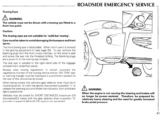

Front towing eye locations are here (one either side), and should have a blanking plug fitted:
I guess a PO omitted to return the eye to its nest at some point

michaelh Perfect! Found the front receiver points from your post!

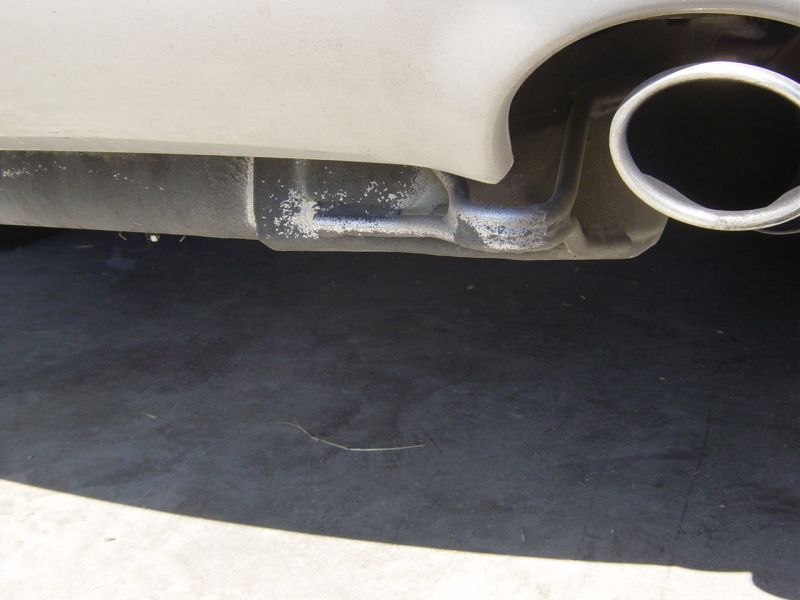

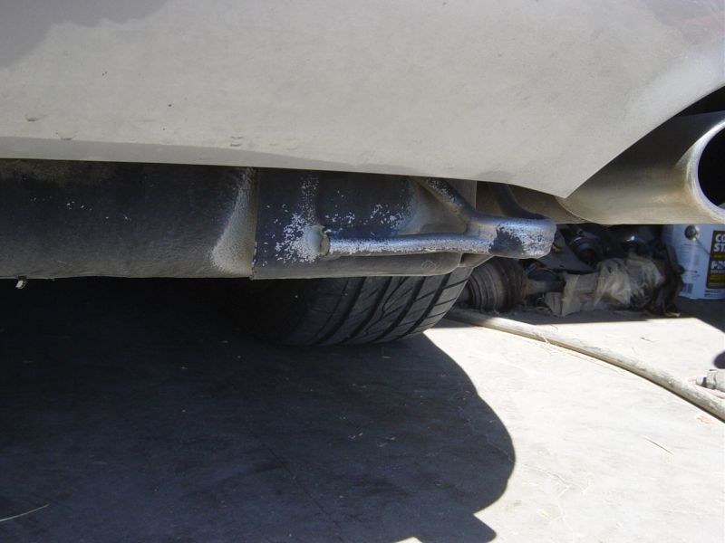

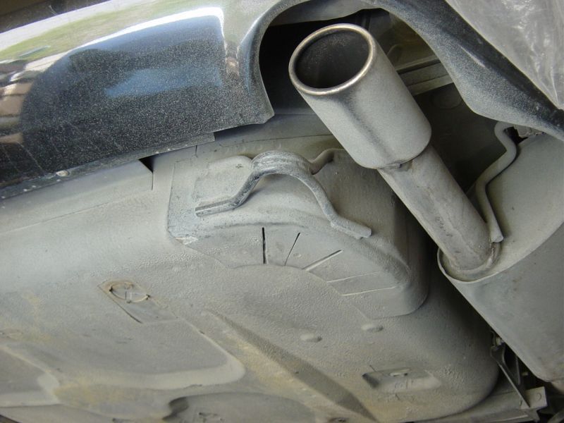

From my copy of the XK introduction JJM 18 15 14/70 August 1996...........
"The rear towing eye is a welded double loop on the right hand corner of the luggage floor."
Pics from two of my XKRs.
One on the floor and one on the lift in the air.

The front locations are attached to longitudinal box sections/front crossmember, so are pretty substantial.
For the rear., a welded loop attached to a somewhat-strengthened corner of the spare wheel well. Although the literature implies otherwise, I wouldn't use it for towing unless it was an emergency.

That's for the great pictures as I learned something about the earlier cars.
That's a substantial metal loop at any rate.
