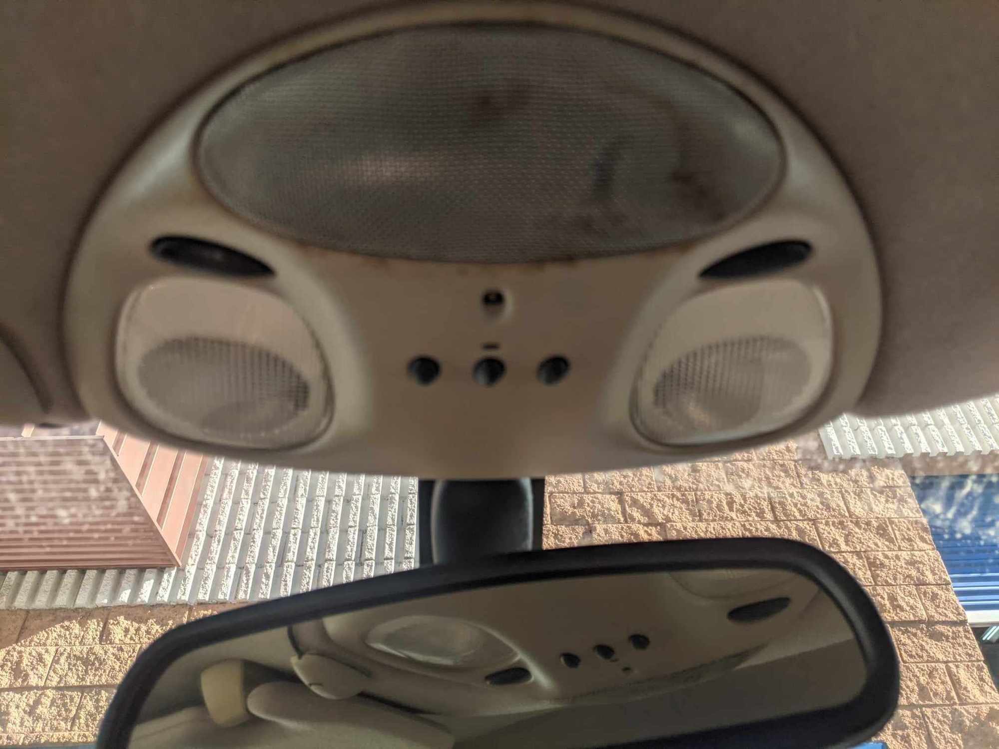

I have an oil leak coming from this overhead speaker. Any idea why this might be? I've had the car for 4 years and it has always dripped from there.

Search for Green Shower…..

That's not a speaker and that's not oil. The dreaded green shower is eminent. My car was bypassed before I got it and I have no problems operating the latch manually.
It's not a major fix but you need to know the right things to do. Search on this forum as advised above. TM

Oh, interesting. Not to hijack the thread, but mine looked a lot like that. Kind of gooey, and the lights looked as if they'd had some brownish stain or something. Nothing worked. I never thought that it might have been subject to the green shower. I know the PO had paid $5K for a new top just before the trans went out and he parked it. Since my top works fine, perhaps I can assume that the hoses were done as part of the top.
Anyway, concerning this, it took a while but I found a suitable replacement on eBay and just tossed my original into the trash.

I bought a 1998 XXK8 that had a 'weeping' hood latch/overhead console area and discovered NEW HOSES.
The latch itself was leaking but I had a repaired cylinder block assy from TOP HYDRAULICS in stock so I replaced it and topped up the fluid reservoir.
Don't assume hoses are all that leak.
