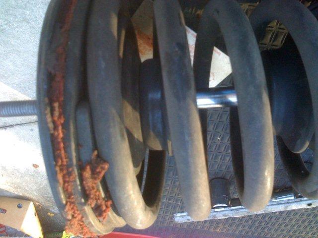

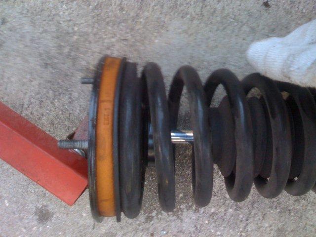

Here are some pictures of the shock absorber and upper-mounts that I just changed on one of my XK8 (1997). I have a friend that wanted to see them. I have heard others talk about how they disagrate. I had know idea how bad it could be. A picture says a thousand words. And yes the big bang sound in front is now gone ....

This is also the #1 reason front camber is off and why alot of shops that dont know jaguars want to put in adjustable bolts...lets just try to fix the problem ok and not bandaid it, we'll all be happier

i have yet in 13 years to really see springs need to be changed from sagging. Usually its the bushings that are the culprits. But you might consider lowering springs and then you will need the eccentric bolts to allow alittle bit of comphensation for the lowered ride height which is what they are for. Not to "fix" damaged or worn parts. Although if I was rebuilding suspension on a high miler say 150k^ I would probobly replace the springs then too. Youde be amazed how "used to" a crappy ride you become when it happens slowly over the years...kinda like a waistline

Are all the bushings/spring cushions orange?
I think mine are kinda aqua color!
Just curious if color means anything, 99 xk8 coupe.

Yah, must be tough living in hawaii Martigre. While he's under there, might as well do the lower shock bushings and the sway bar bushings...they can make some noise (clunks) on bumps. $15 a peice IIRC.
