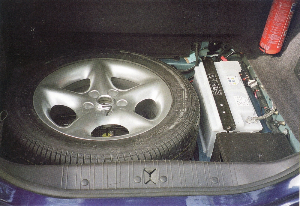

When supplied on the early XK8/XKR, it was fitted in the luggage compartment on both Coupe and Convertible.
Unobtrusive but not very practical.

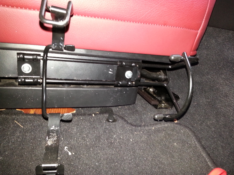

Hope this works, the pictures looked upside down in the forum app...
It's just a flat sheet of metal that bolts to the existing holes in the seat base under the cushion cover, then the extinguisher bracket bolts to the sheet.
Wow my seats look pink

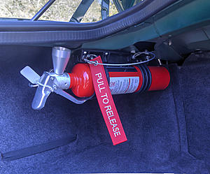

I just finished mounting a 2.5 lb HalGuard (halon) fire extinguisher in the trunk of my 2005 XKR coupe, under the left rear fender. I used the H3R NB300 "Extreme Duty" quick-release bracket, securing it with 6 sheet metal screws and 2 1"-long 1/4"x20 bolts with 1/4" nylon spacers. The bottom of the extinguisher is held in place by a metal rod that fits into a notch on a nylon bracket attached to the extinguisher; the top is held in place with a quick-release pin attached to red "PULL TO RELEASE" flag. Hope I never have to use it, but glad I have it just in case!
