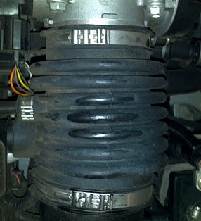

In case your talking about the quick release clamps (I can never remember all the various names for these clamps) shown here, you can squeeze the outside "humps" on the clamp towards each other. It will spring open. If not a gentle tug up on the retaining clip with a small screwdriver while squeezing should do it.

Yes its the quick release type, thank you!
