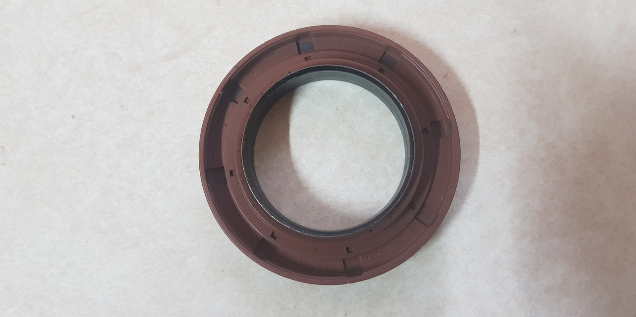

My rear dif has been leaking, is this seal correct for the front (pinion) output?
Motive Gear Performance Differential 5778 Motive Gear-Differential Pinion Seal Differential Pinion Seal Motive Gear Performance Differential 5778 Motive Gear-Differential Pinion Seal Differential Pinion Seal
I've seen pricing all over the place and need some advice.
thanks

As to the seal...since it is @ $9.00 usd I'm going to order it and do a side by side comparison with the one I remove.
Is there another 'seal' (O ring) that fits behind this seal?
wj

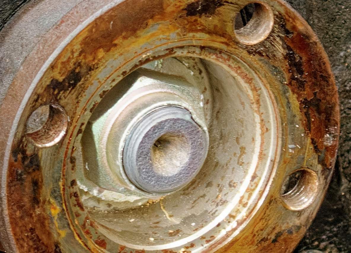

If I remember correctly it's just a conventional lip seal which runs along the outer surface of the flange which you pull out once you have removed the nut. Make sure that you check the removal and torque procedure for the nut before you remove it.

For simplicity, you can mark the nut and reuse. Put it back EXACTLY where it was with a little threadlocker to get the preload the way it was from the factory.

Just a heads up that when the diff pinion seal leaks, it can be an indication that the pinion bearings are worn. Check your pinion shaft for any discernible play and check the backlash between the pinion gear and the diff crown wheel/ring gear. I think the acceptable backlash is listed in the Workshop Manual, which you can download from the DIY Quick Links thread.
If the pinion bearings are worn, your new seal will not last long.

My understanding is Jaguar stopped selling the seal and you had to buy the whole flange assembly with Ryton ring for $300+, so for 9 bucks it's worth a try.
In the UK the cheapest i could find was £65. JLM20326.
