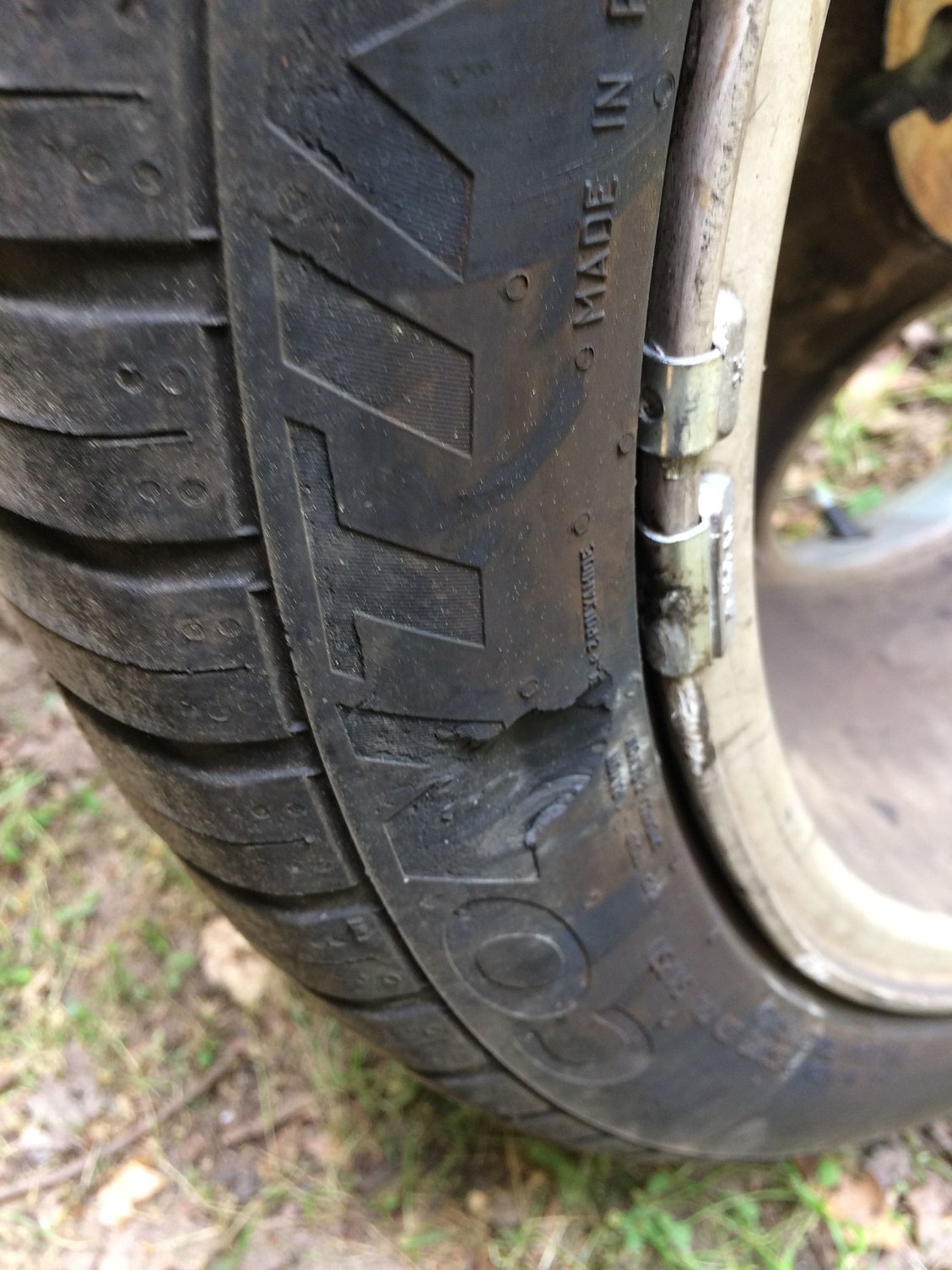

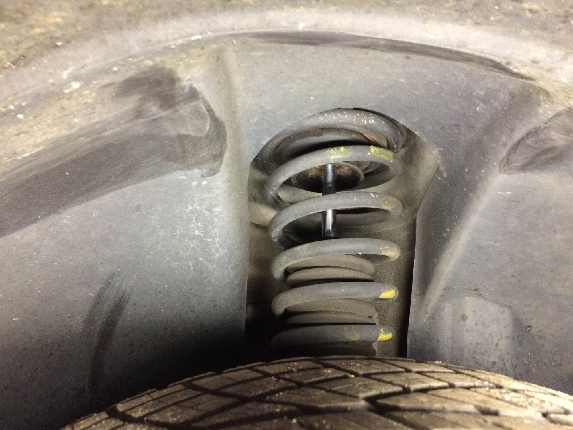

Well looks like I am going to have the fronts rims repaired (hopefully drop them off tomorrow). Went down to the garage today and I was going to pull the rear 9" Apollo rear and swap it to the front to see how it fit and take a pic or two for those who asked. Unfortunately things didn't go as planned. BOTH of my hydraulic trolley jacks wound up leaking! I finally got around the side quick enough to slide in a jack stand before the leak down beat me to it and as I was pulling the front right I noticed the impact had actually scrubbed the existing tire on the 8" rim against the wheel wheel liner!
Notice the darker scrub on both sides of the shock!
A check with a wheel fitment site showed that the 9" rear with the +35 offset would add about 10.7 mm to the inside of the rim and 14.7 mm to the outside of it, over the +33 offset of the existing 8" fronts. Since the impact had already scrubbed the liner with the 8" wheel, I didn't feel comfortable putting anything fatter up front. And since I still can't find any 8" fronts anywhere, it looks like a repair is my only option, short of completely replacing the Apollos. I really think the Apollos are the best looking of the factory rims that were put on the XK8. I didn't realize how rare these had apparently become. One national place I called hadn't even had one to refinish in the last 7 months!
And to make matters worse, once I pulled the right front, there was a chunk of sidewall about the size of my thumb that was missing! So looks like a new tire to boot!
One heck of a pot hole did that!
