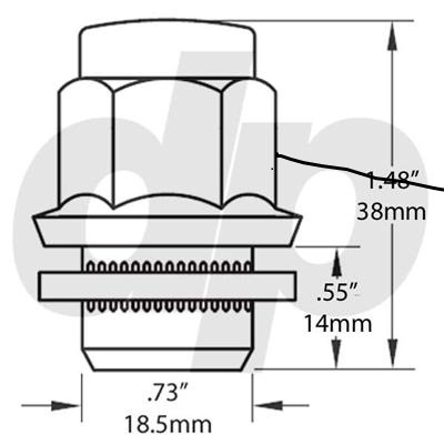

Old Mar 4, 2018 | 09:46 AM
MRomanik's Avatar
Veteran: Air Force
Joined: Sep 2009
Posts: 1,453
Likes: 202
From: Salt Lake City UT USA
This is what I got for my '97
Attached Thumbnails Replacement Lug Nut Quest-adamesh-early-xk8-wheel-nut.jpg   Replacement Lug Nut Quest-lugnut.jpg
