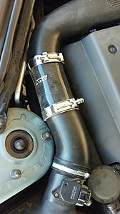

Here ya go...
I mistakenly put one of the clamps on backwards while I was fighting the hose on..I may go to a bigger hose in the future and flip the clamp around, but it certainly isn't in the top 10 things to do right now.
I do notice a little more air intake sound, since there's nothing to buffer the sound like the accordion did..nothing that bothers me though.
