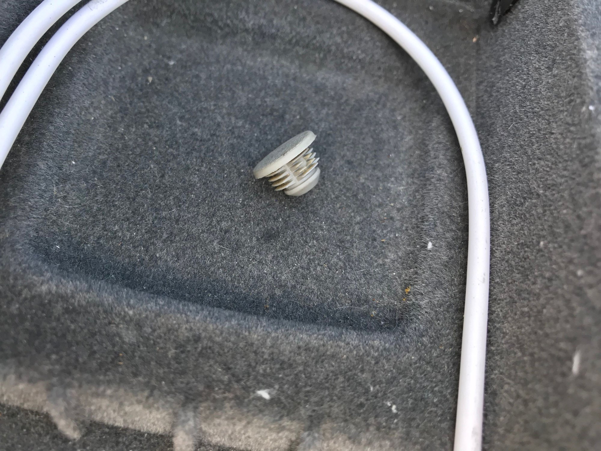

There were other issues. They covered the hole for the manual operation of the top.
And I found the plug in the console.

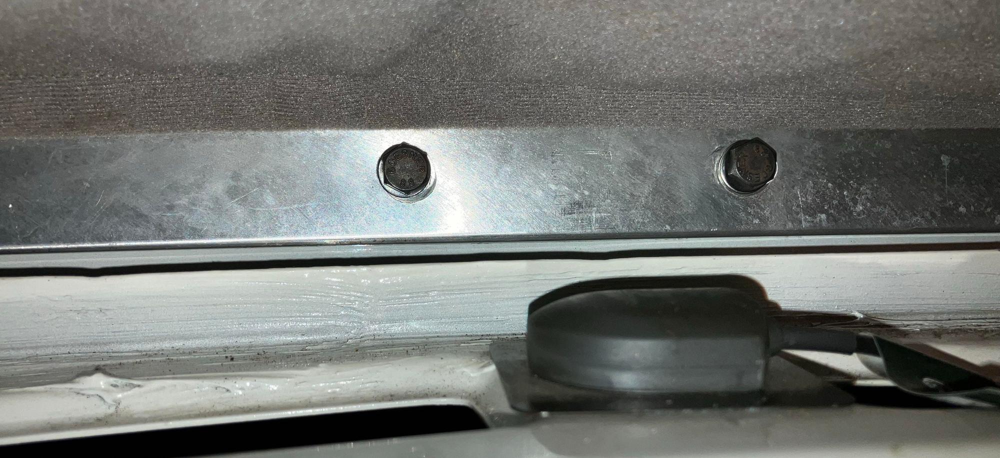

There were other issues and about a month later, when I lowered the top, the latch and the screws fell off the convertible top front rail. The other screws were all loose, too. And the fir plug was missing from the header rubber.

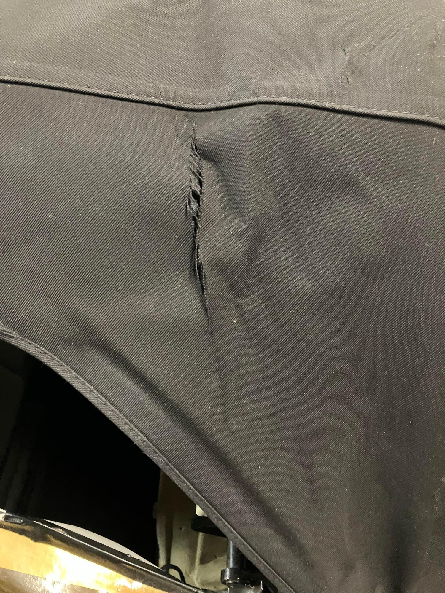

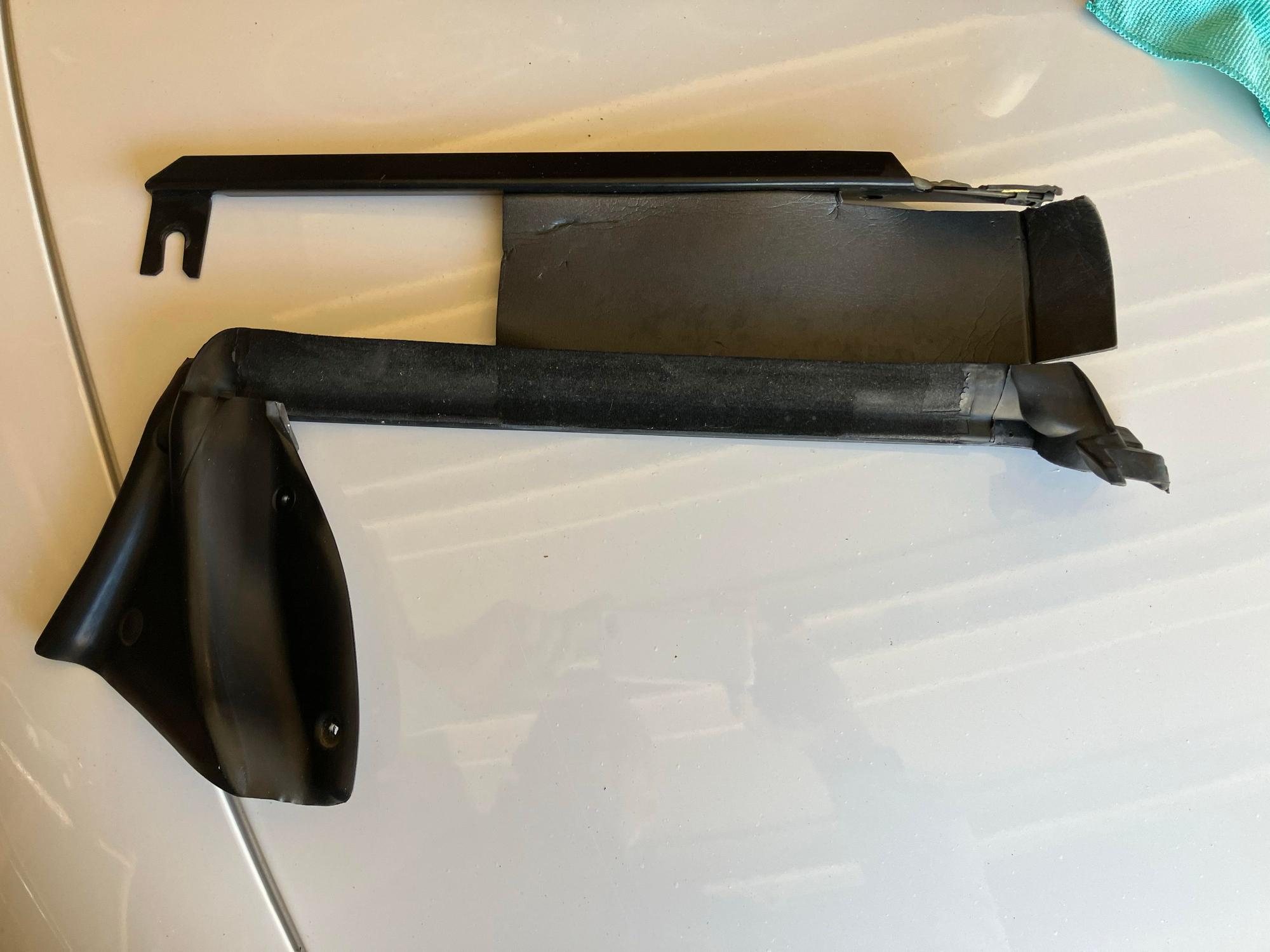

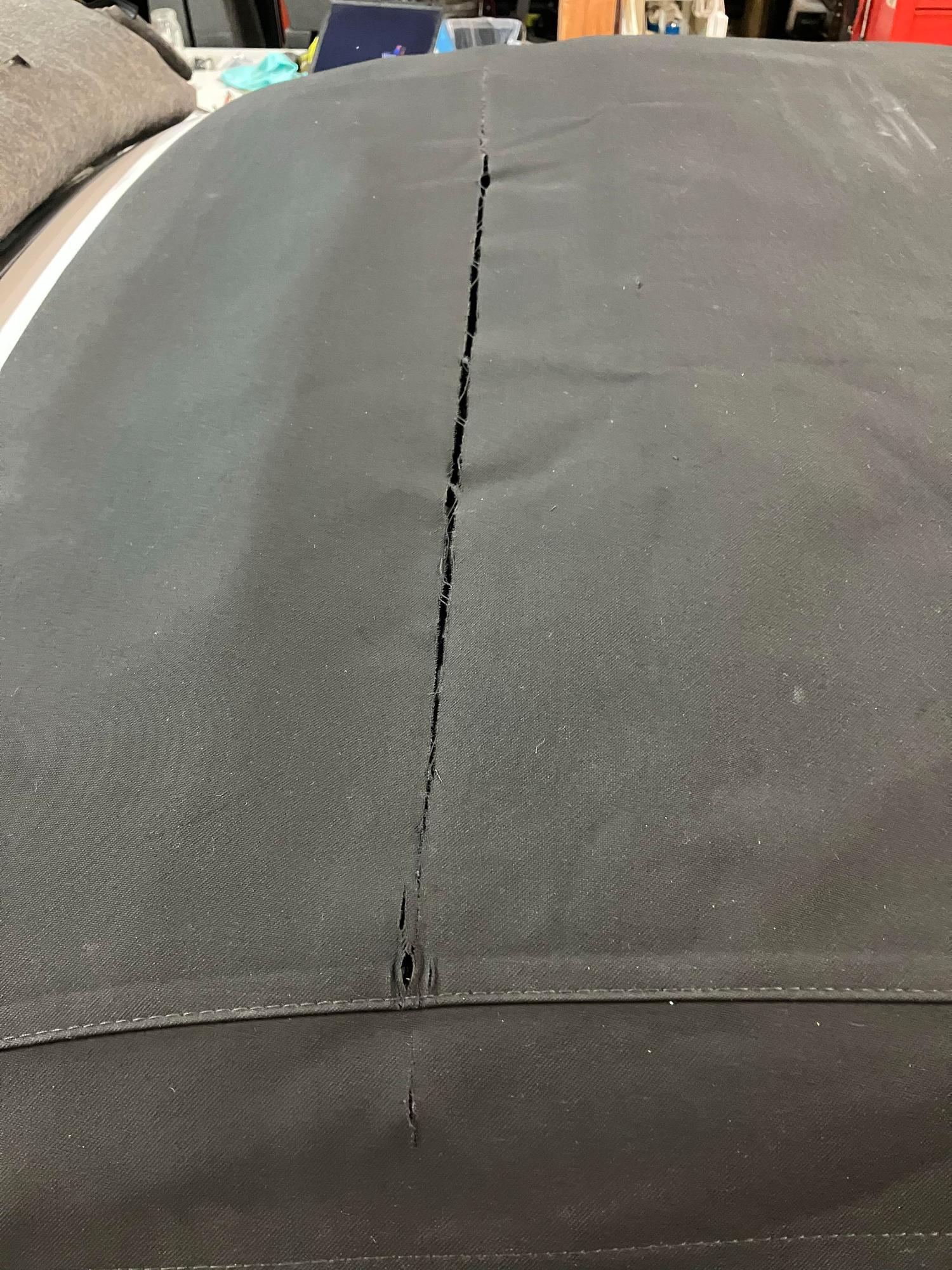

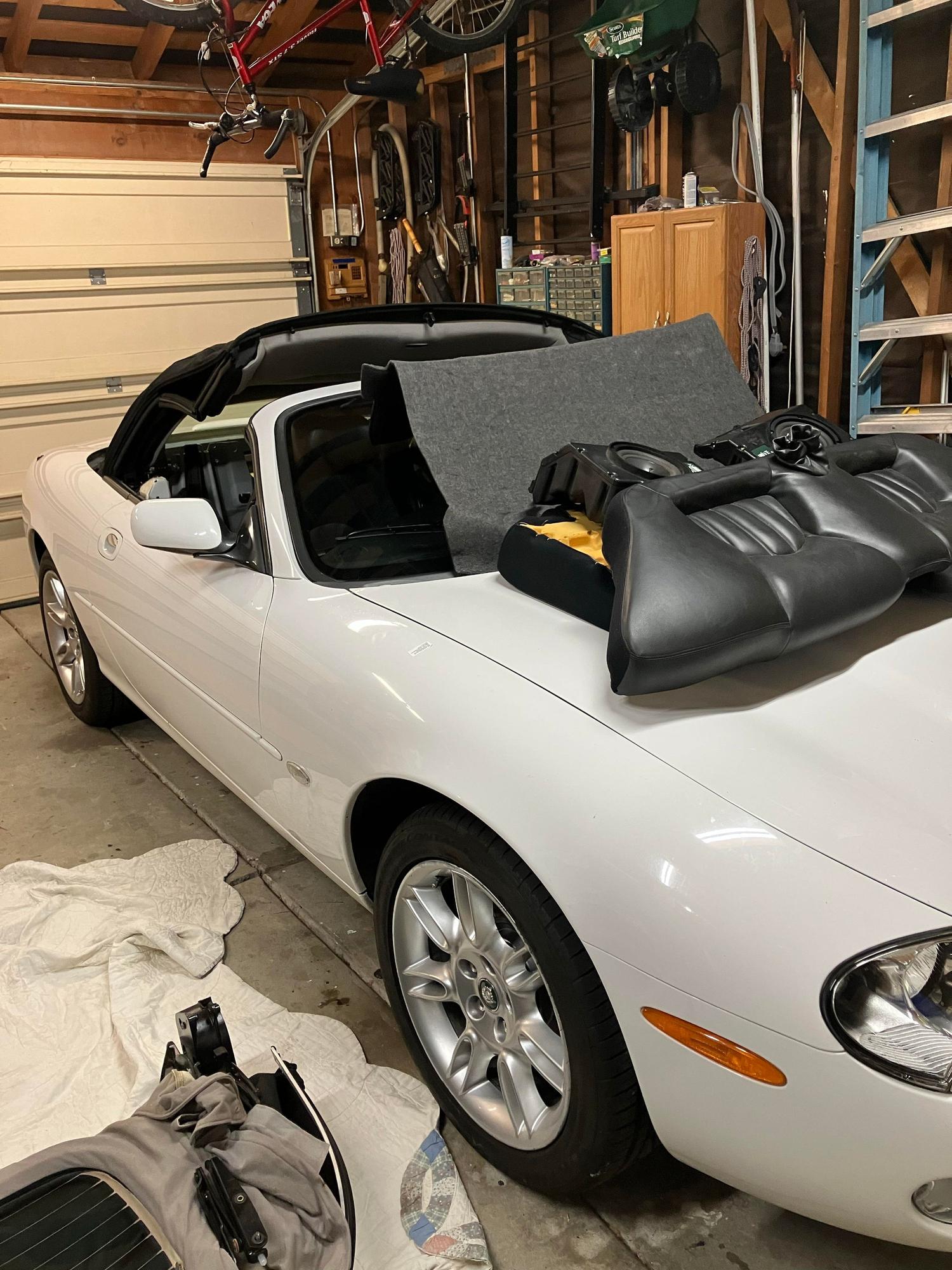

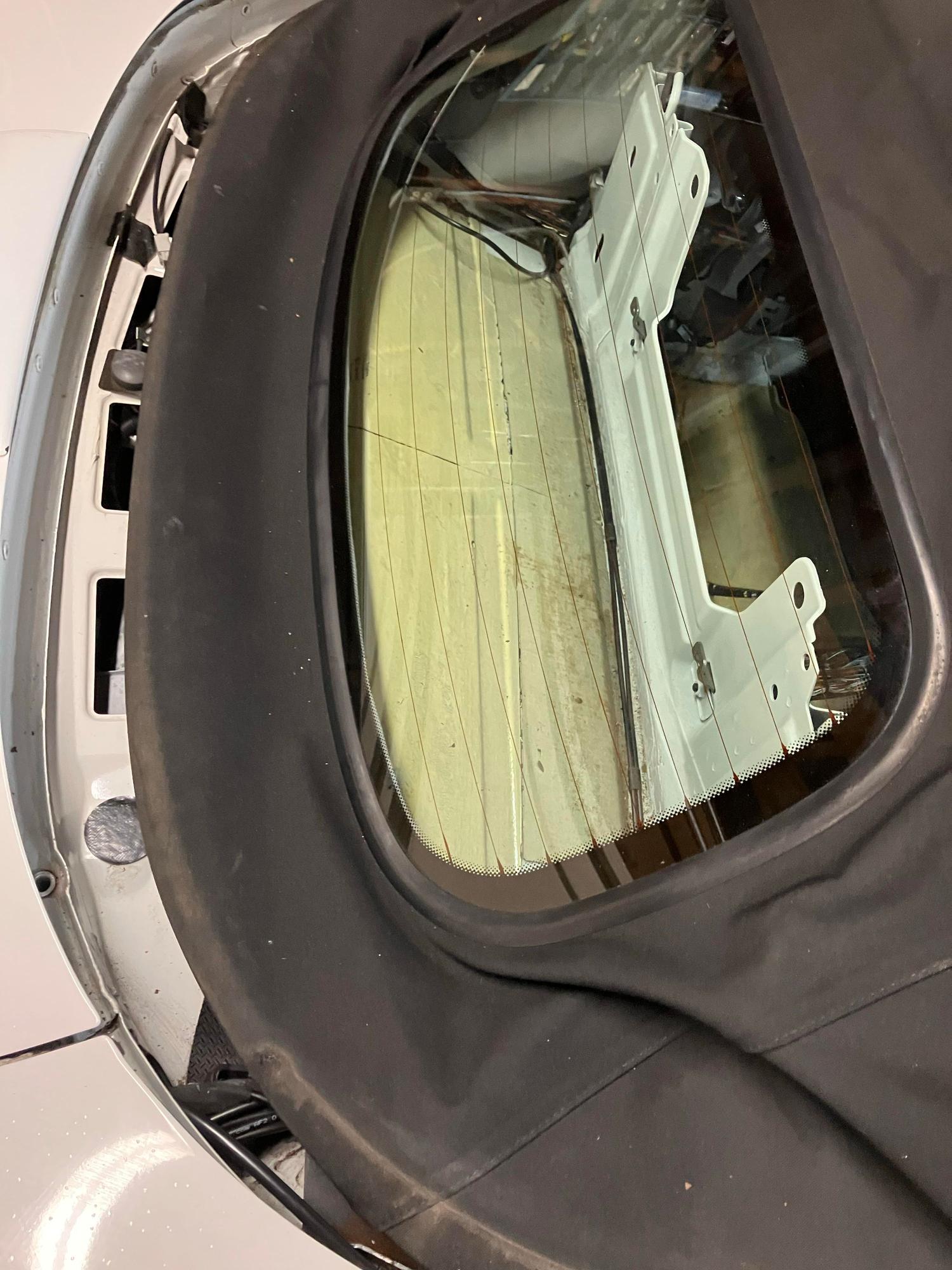

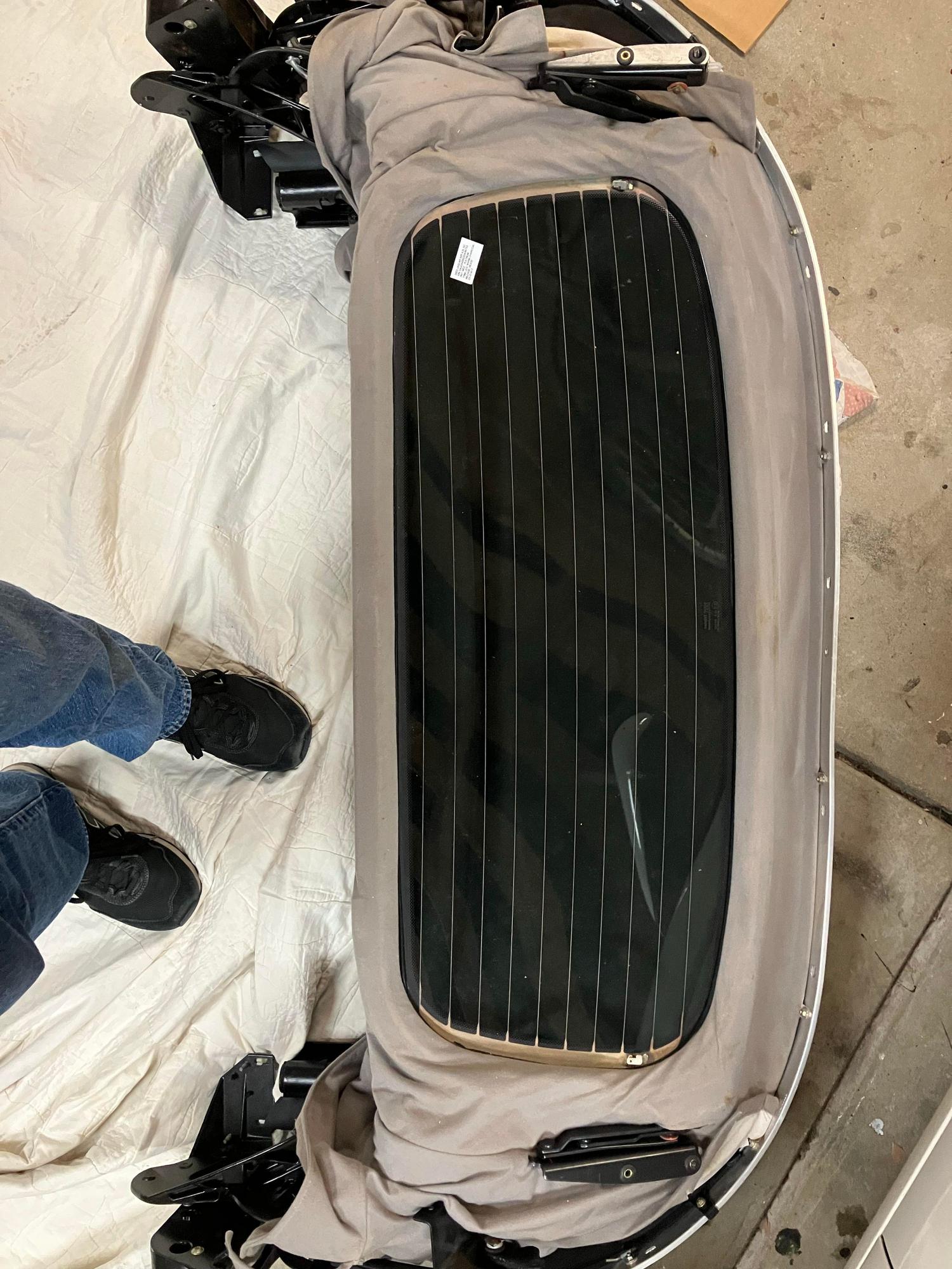

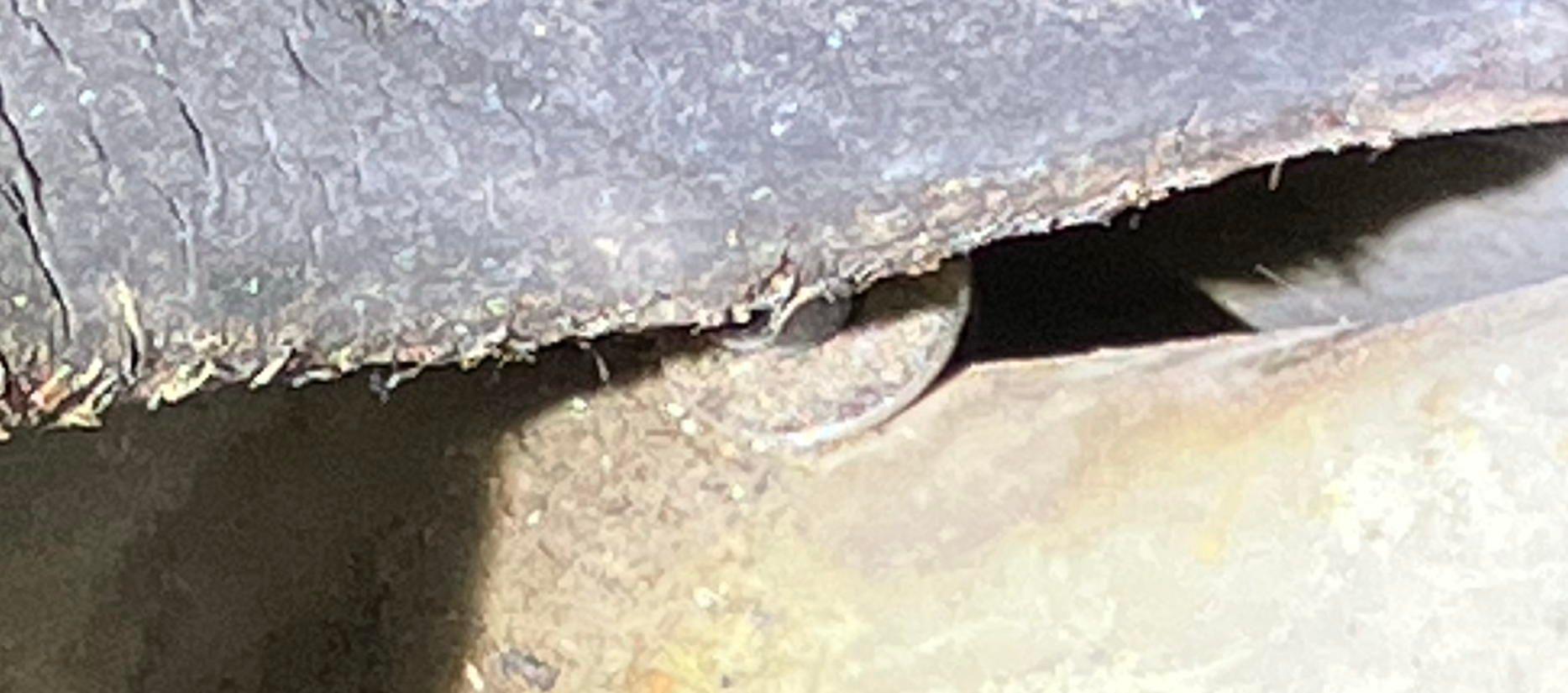

Did all the work to pull off the top. Here are pics of tears
I will add more pics when I get used top .

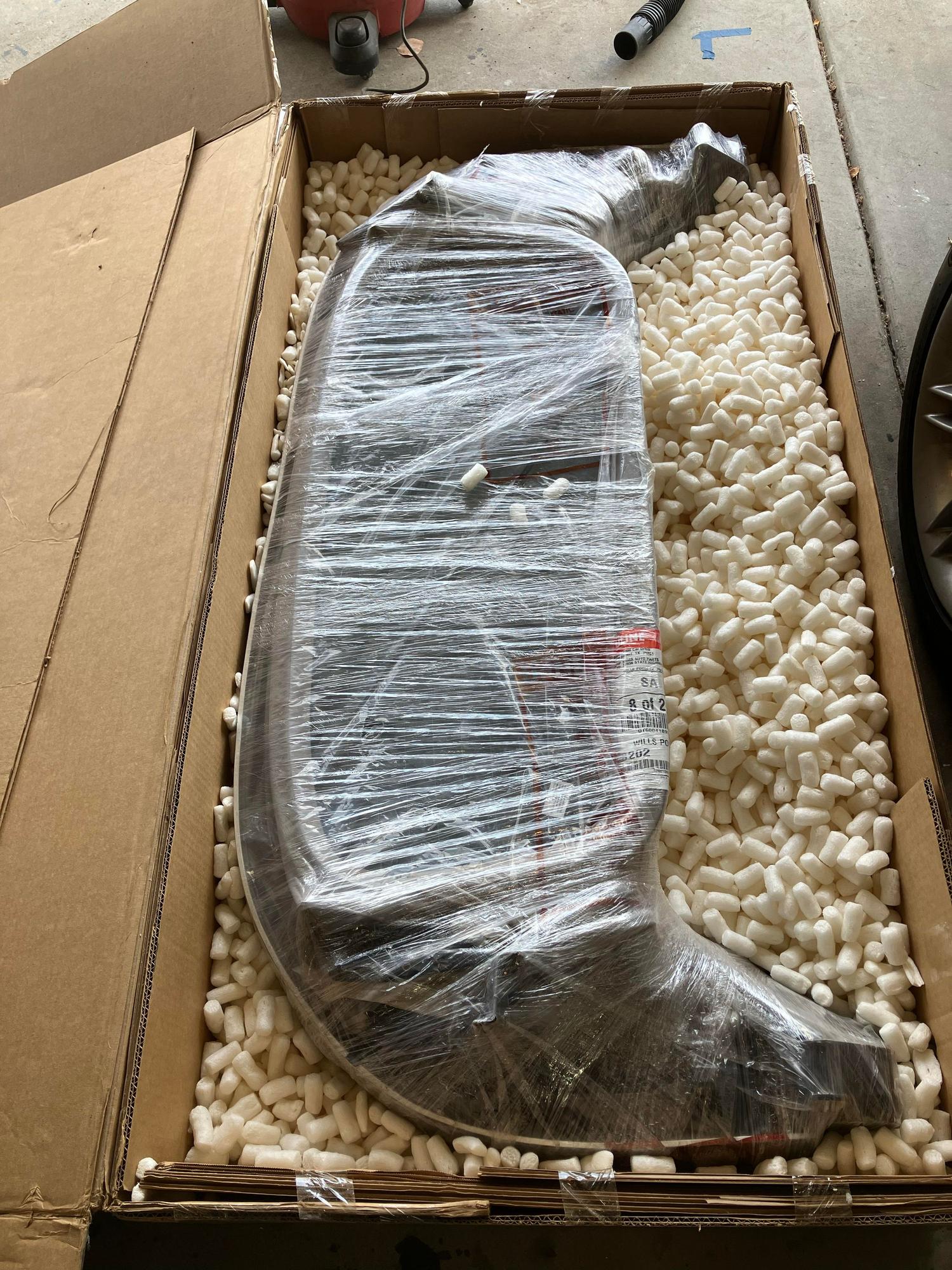

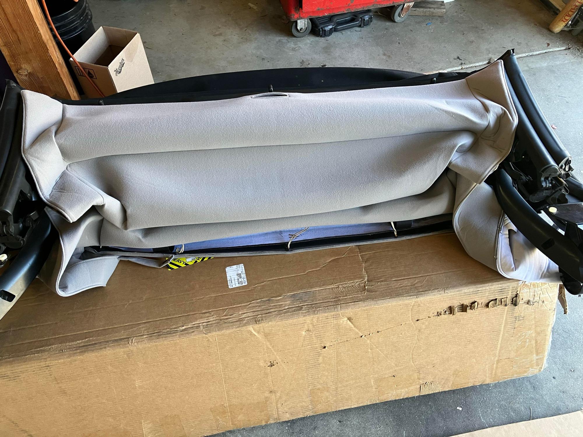

Used top arrived today
unpacked

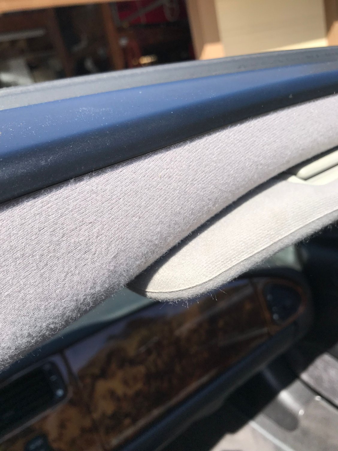

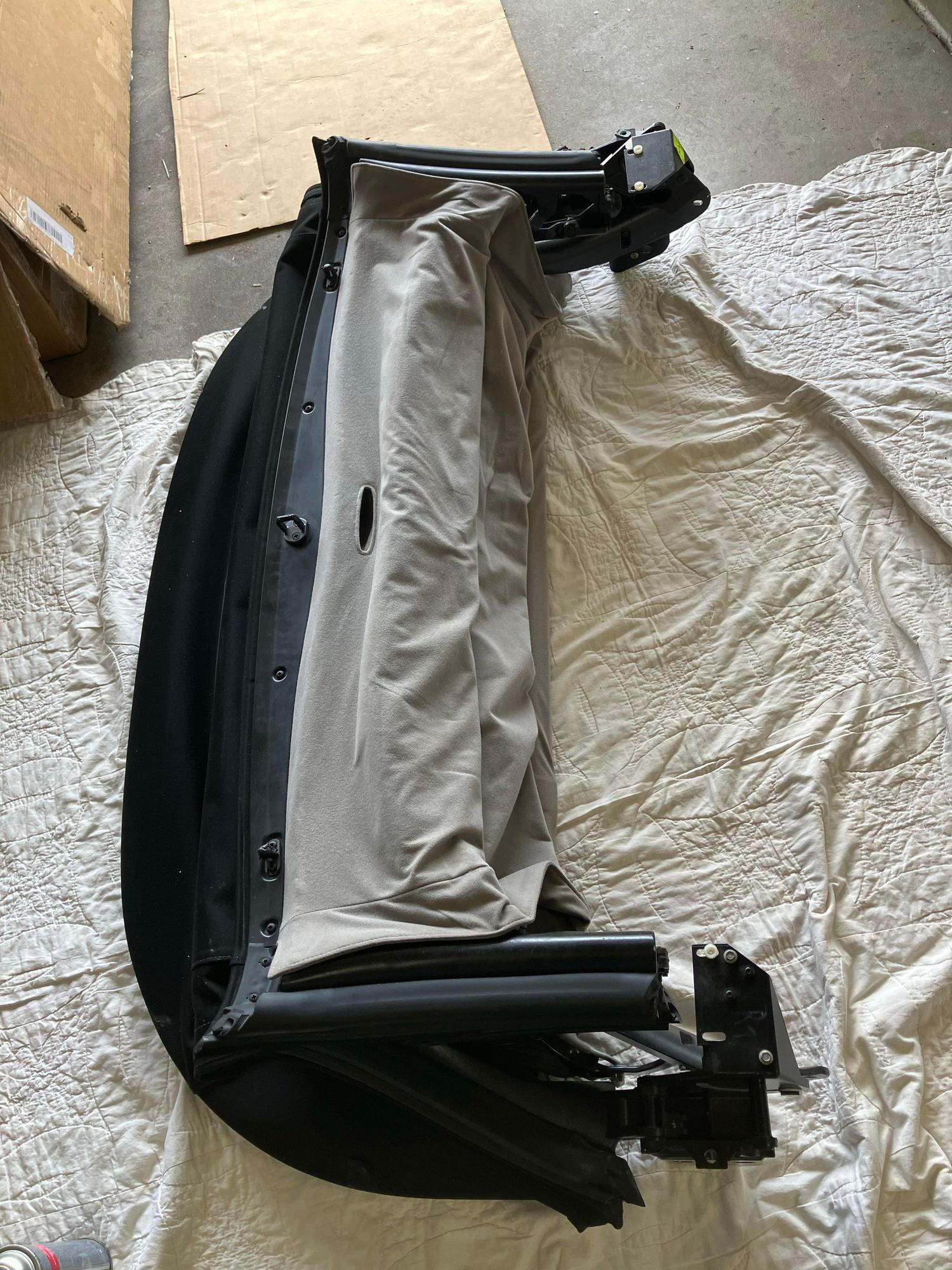

top is in great condition, headliner is one piece where mine is 2 piece., a little wear near the window.
I will clean up and maybe reinforce from back side. okay for me as I am likely to move on to another jaguar in near future.

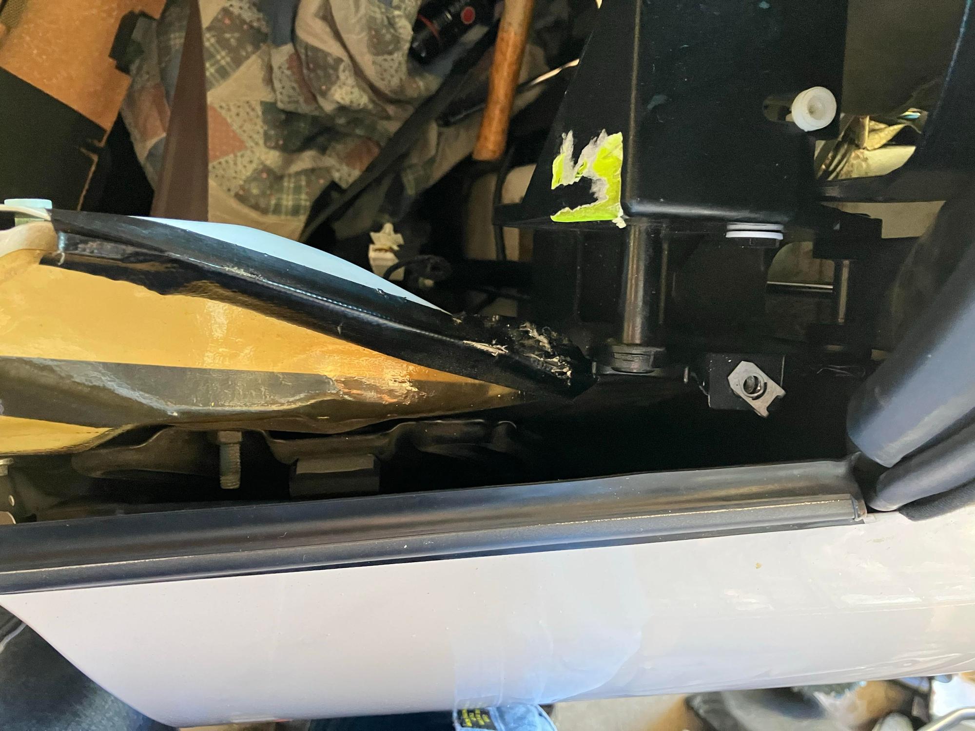

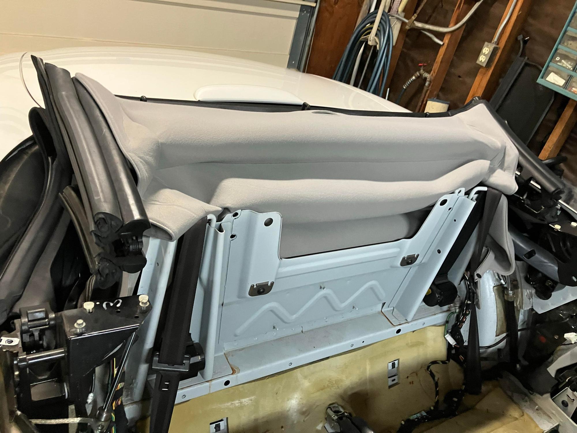

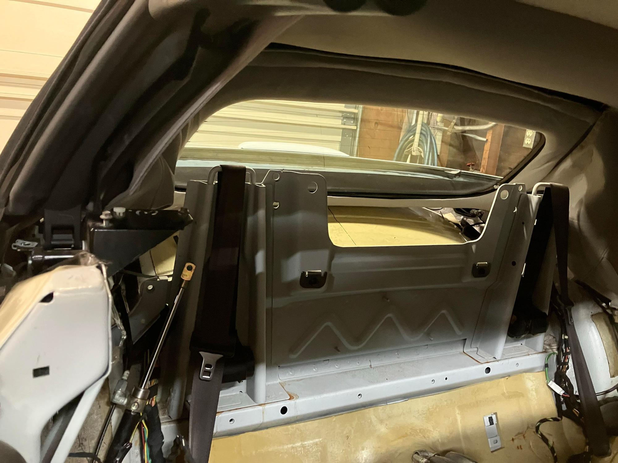

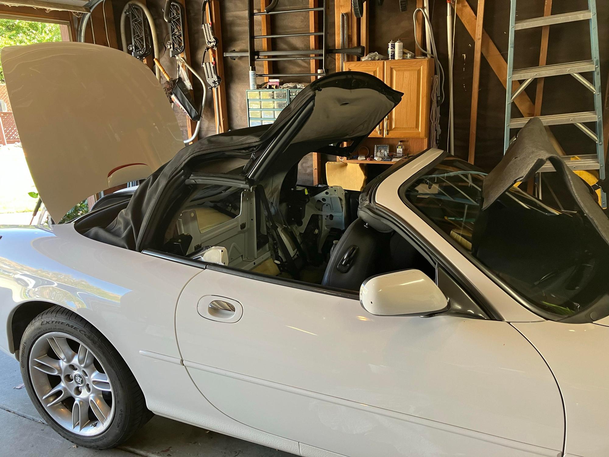

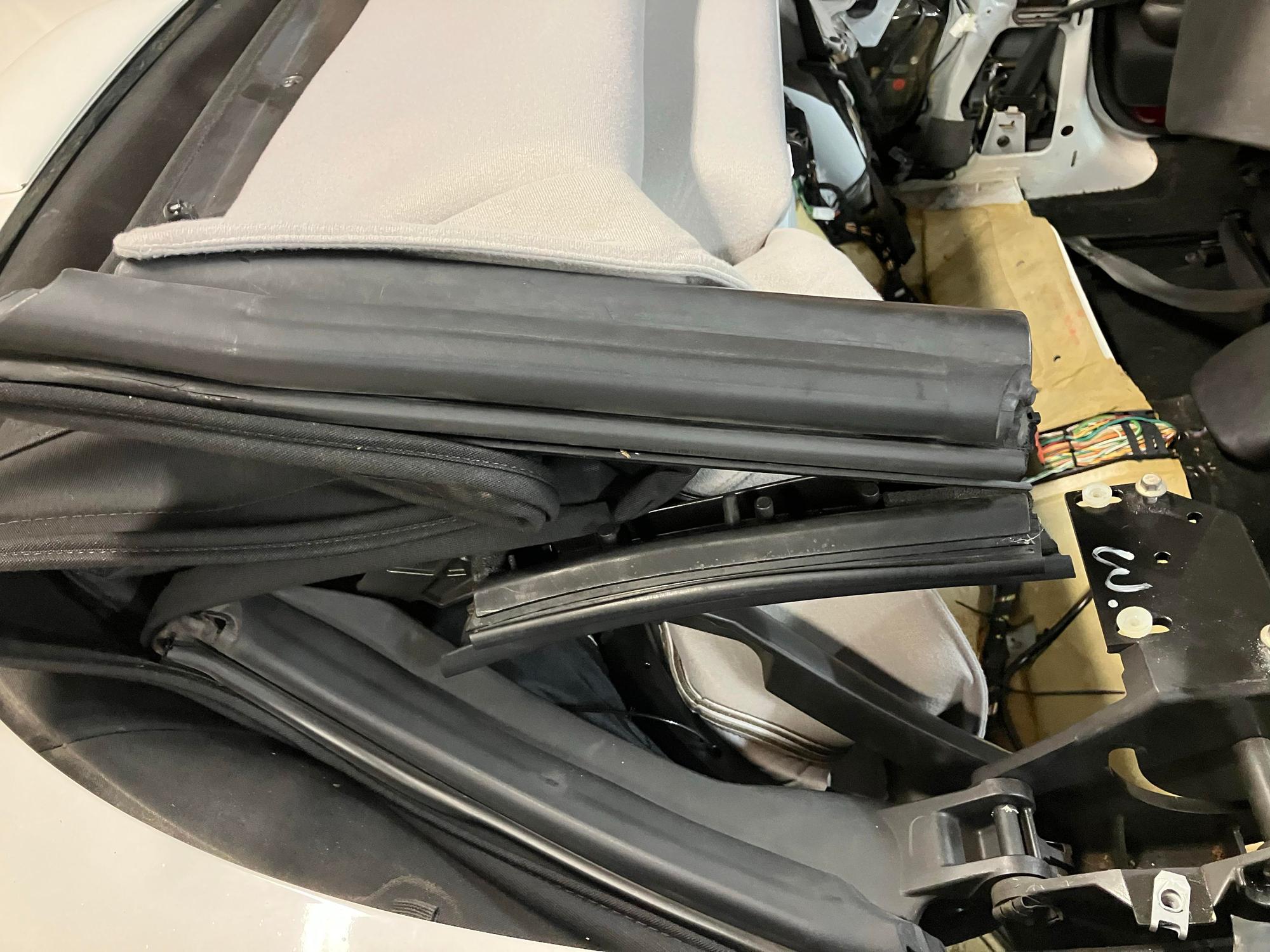

some pics before exchange

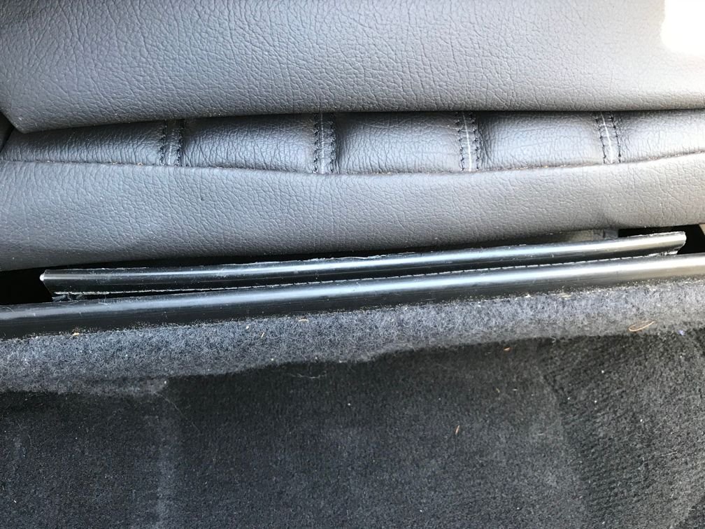

the rear of the the top fits into a well
everything disconnected ready to pull
not sure if I will remove with top extended or lowered. we will see what is easier.
Then I can R&R any of the rubber seals if necessary.

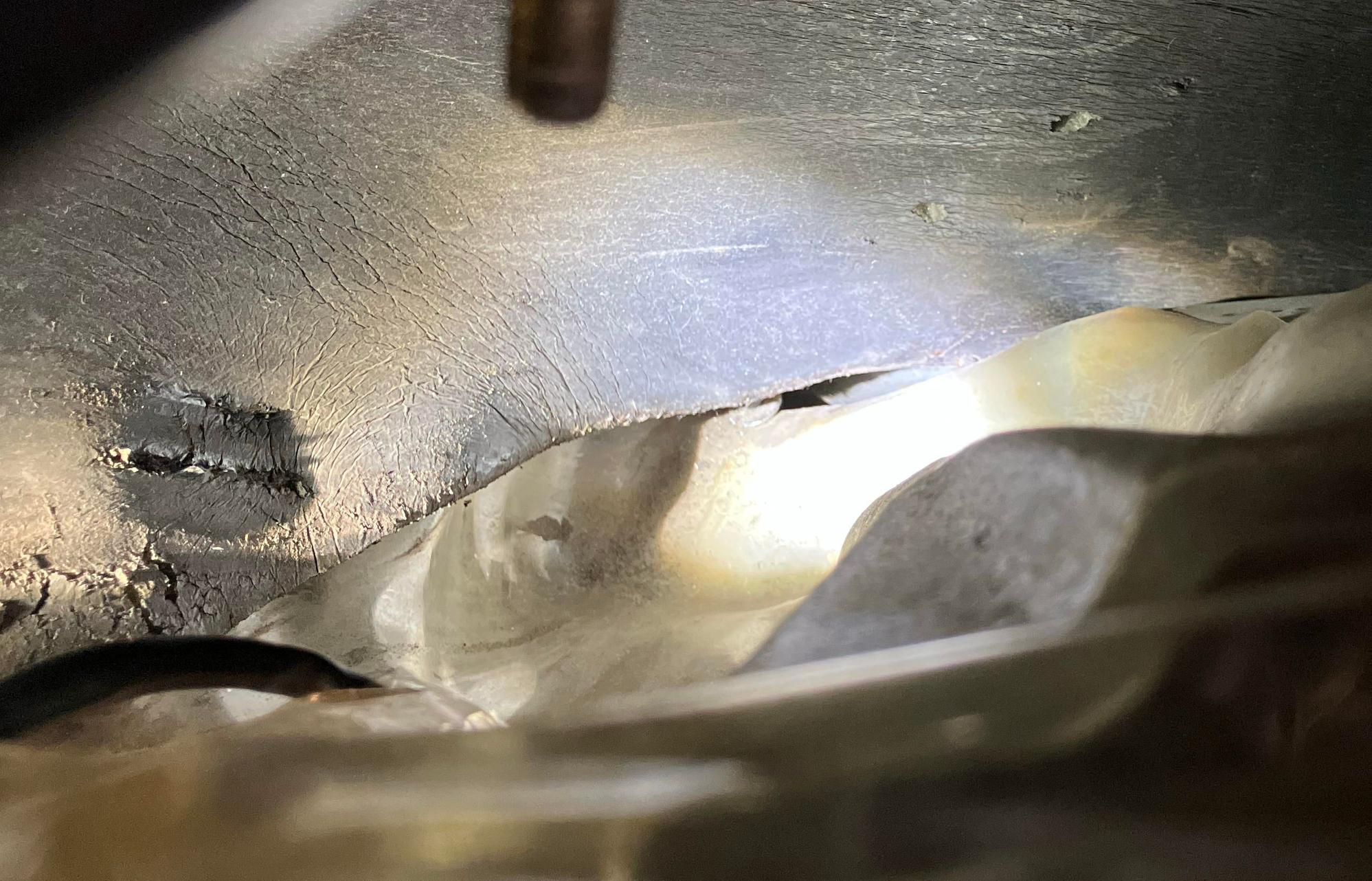

my paint looks good from five feet but the clear coat is coming off and it looks like I got sapped by a tree sometime since spending all that money on the top, so this car needs a complete paint job (estimate $15K) and I can find a really nice one for much less
The entire car is covered with these spots where the sap ate down to the paint
and all this since I did all the timing chains and top hydraulic lines ten years ago.

removed it when compressed and set aside , positioned "new" and lowered brackets to catch bolt on each side, then finagled a little to seat everything. 15 minutes. two men, my son in law helped as it was too heavy and awkward for my wife

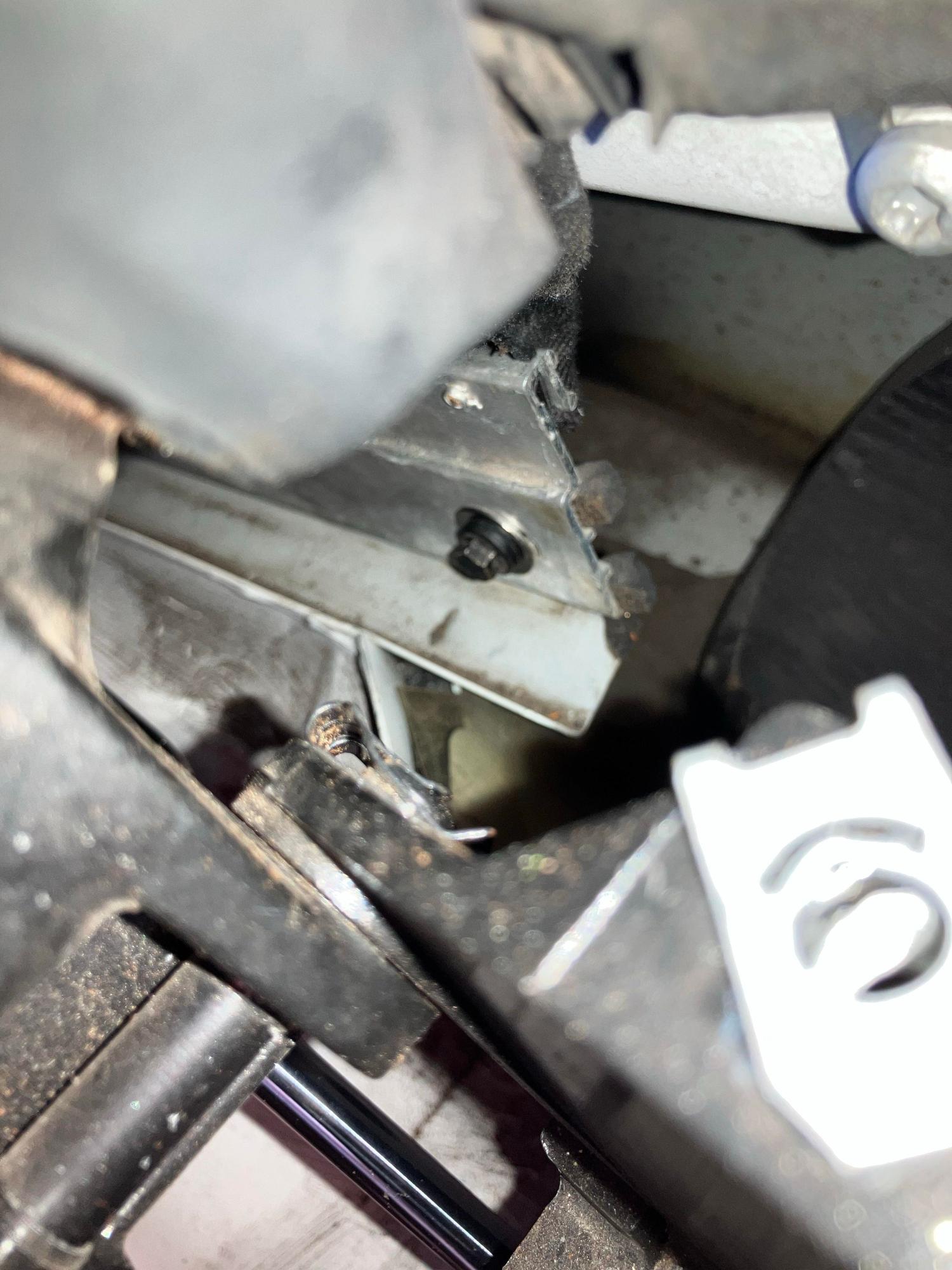

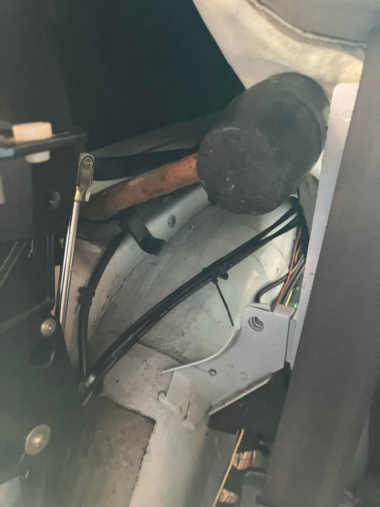

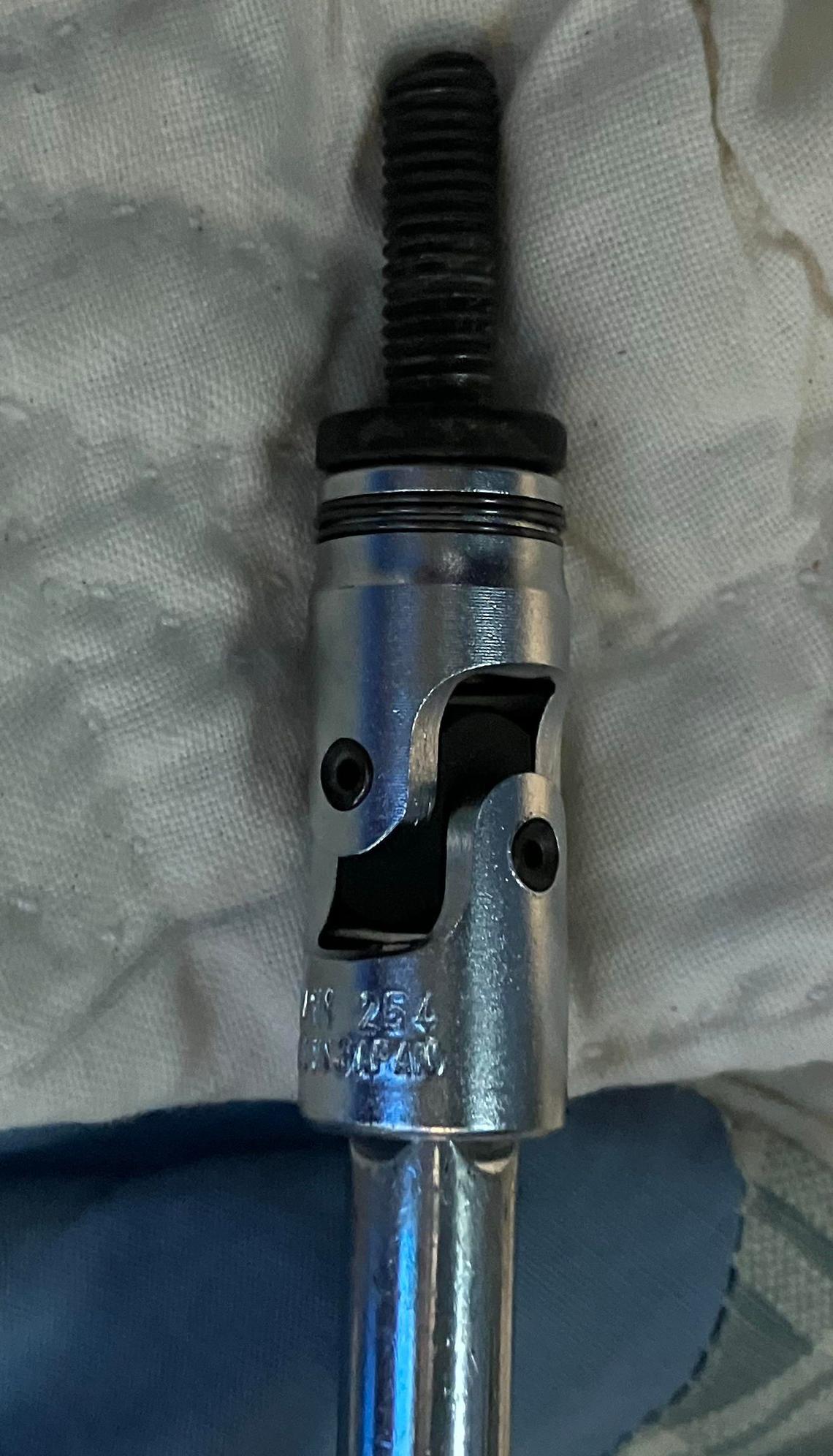

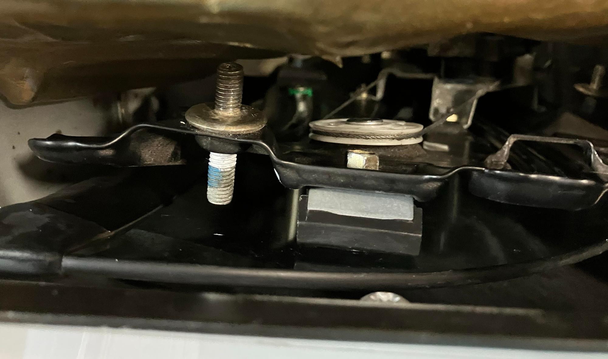

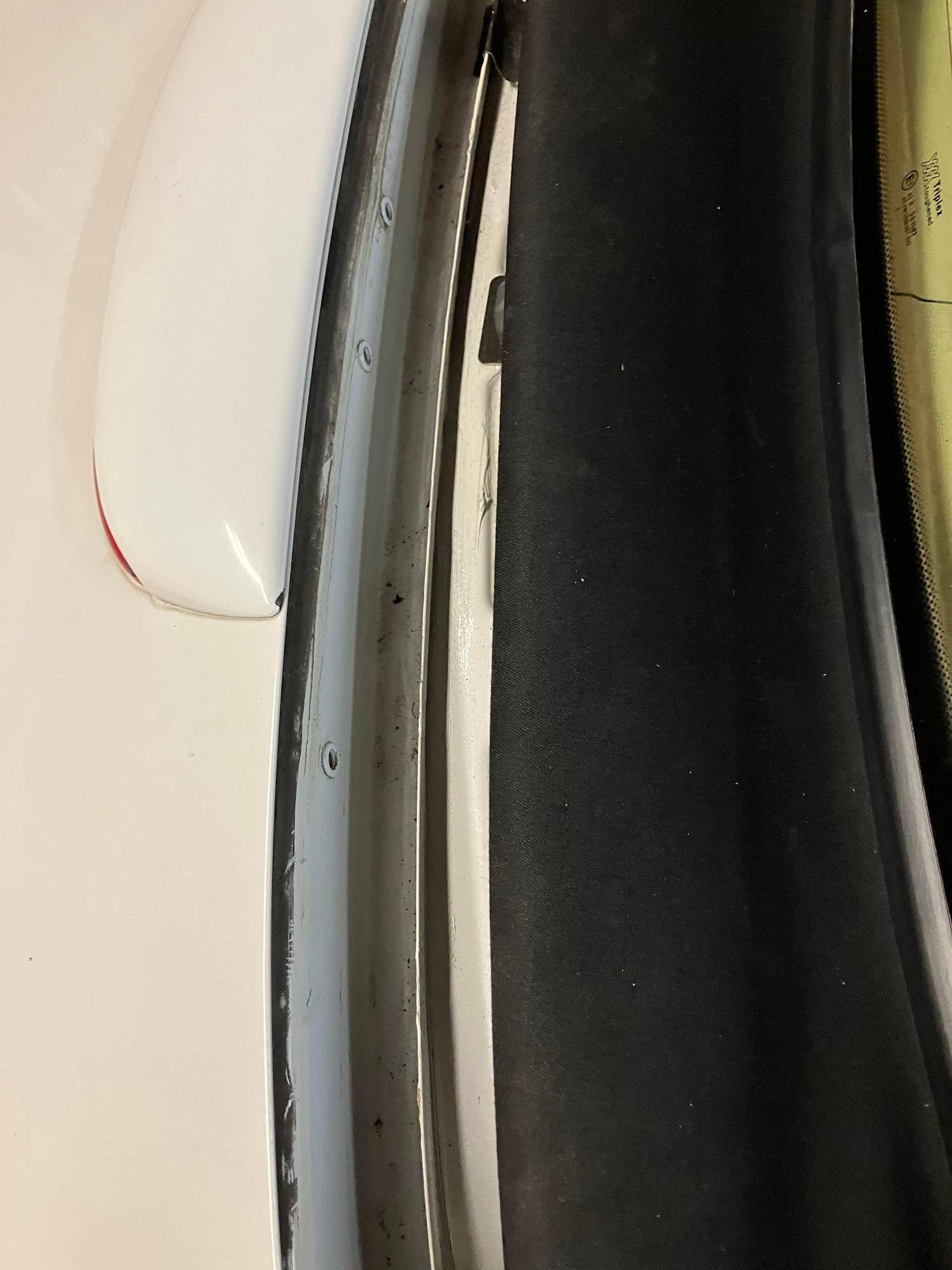

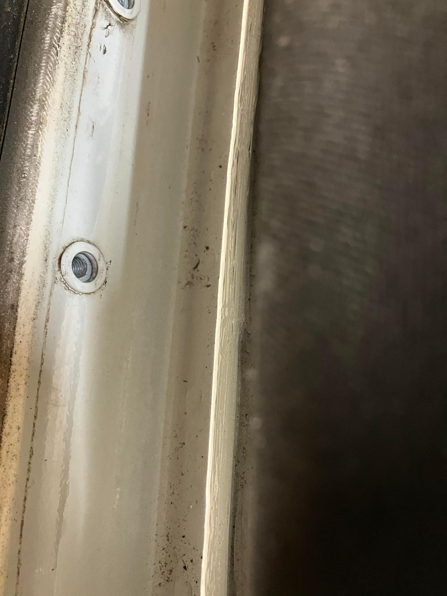

the hardest part of completing this job is to screw in the bolts attaching the tack strip to the body. locate the track strip as close to the body as you can
then get 2 long bolts to help locate the tack strip in position
then get a socket that can grip the head of the small bolts
working from the middle screw in the bolts not tight
when you get to the ends you will need to push on the tack strip to align the holes in the tack strip with the body inserts, I used a rubber mallet

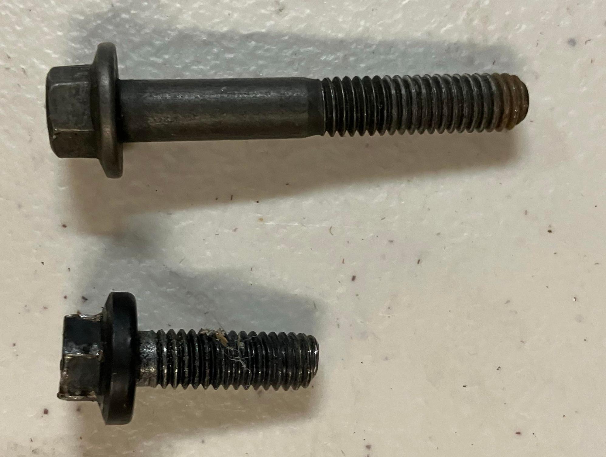

turns out I am short 4 bolts, another issue from the guys who did this before
really not easy getting these bolts in, I was getting leg cramps and sweating profusely

Well, what do you know! I was insert ing the last bolt into position and it slipped down into the rear quarter window space. Be sure to put a rag under that last holed to catch the screw. The screw fell into the channel which empties into the quarter window space. I had a spare screw and was able to screw it in as shown.
A better way to install that screw is to remove these parts and the you can get your hand into the area.

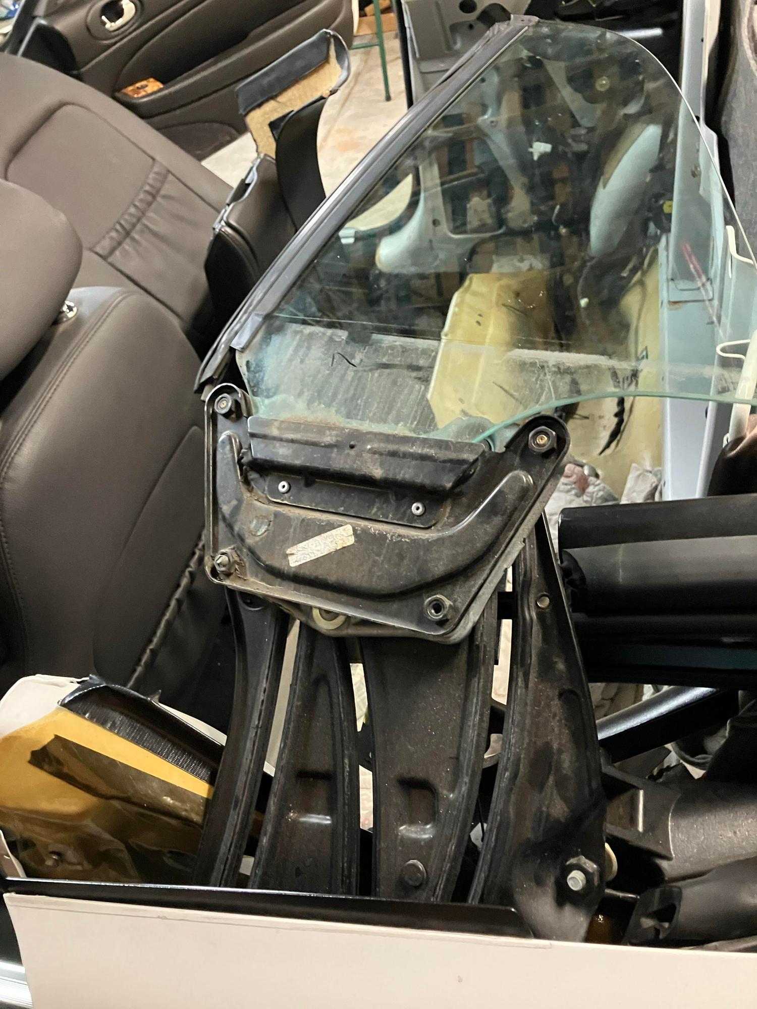

attached pdf is worth reading
to get my window system part way out I removed the window stop and the stud
both inhibit removal of the window
then it was fairly easy to lift it up
and down in the bottom was the screw barley visible
got it out and now progressing on the top reinstallation

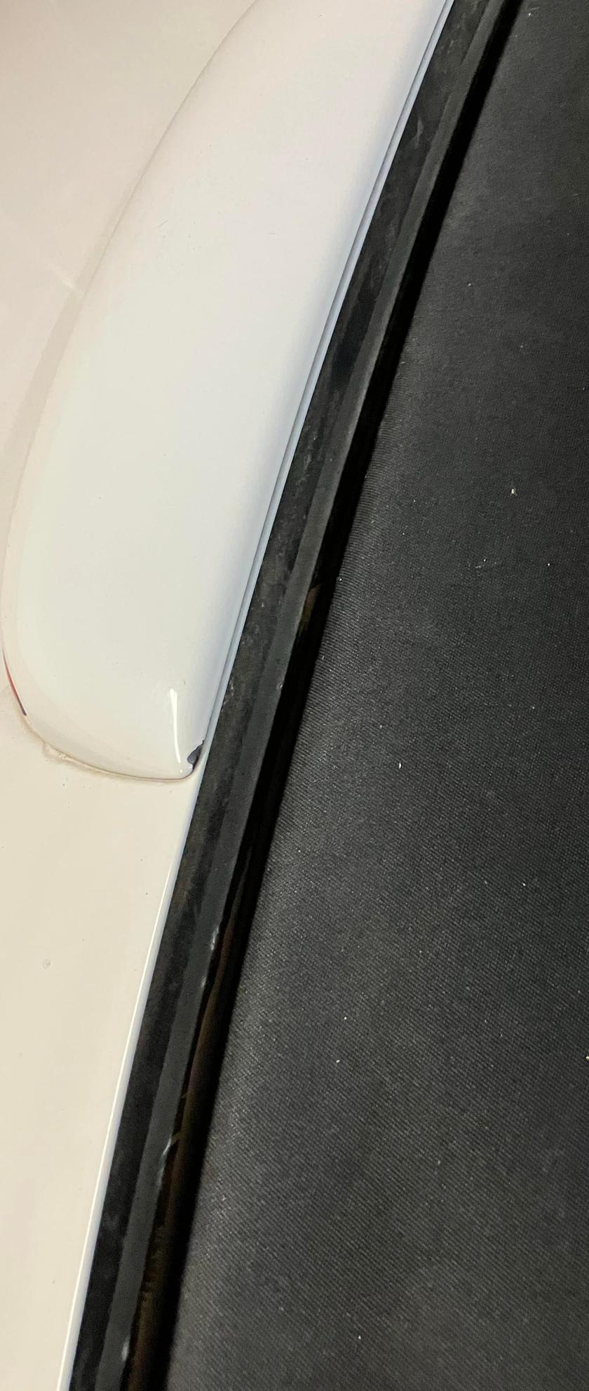

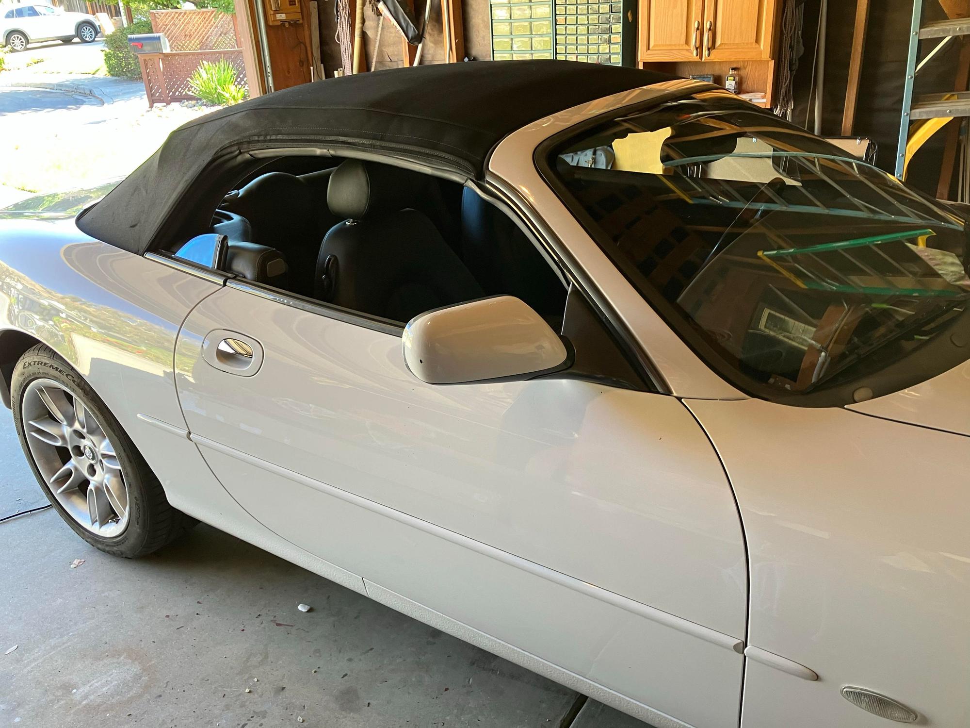

all done
cosmetic blemishes cleaned up easily
well worth the $500 with shipping

just a clarification , the edge of the top does NOT fit into that well back there, it attaches to the vertical adjacent wall. the well is a drainage well for any water that gets in there
the JTIS instructions are really useful and take pictures of every step
