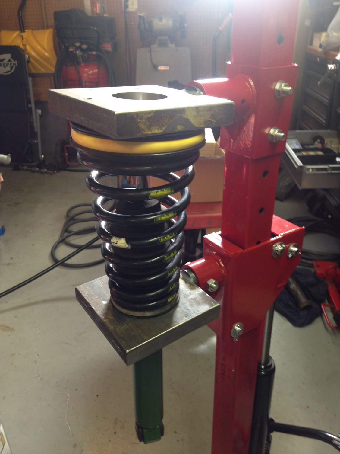

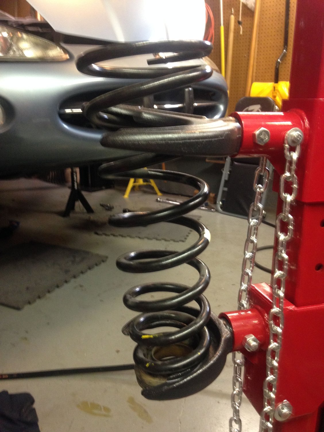

If you have a friend with a press, we had the best luck getting it fully extended and the three studs on the bottom with a hole in one brace for a stud and the others are up against the other one. It's a pain to bet the shock stud back in the hole and requires a good light and a wrench to guide it into the washer, the head of the stud wants to catch on the washer shelf. If you use this system be sure and chain the spring to the side of the press away from you, do it tight. This is a dangerous job on a good day.

The first photo is how the compressor was as I bought it. Didn't work well AT ALL. Couldn't hold on to the spring and you can see why. Second pic shows the attachments I had made it's an easy peasy 10 minute job once the strut is out. MUCH safer too. I will not struggle with this stuff anymore. I have managed to make it work for another car or 2. All struts are not created equal. TM

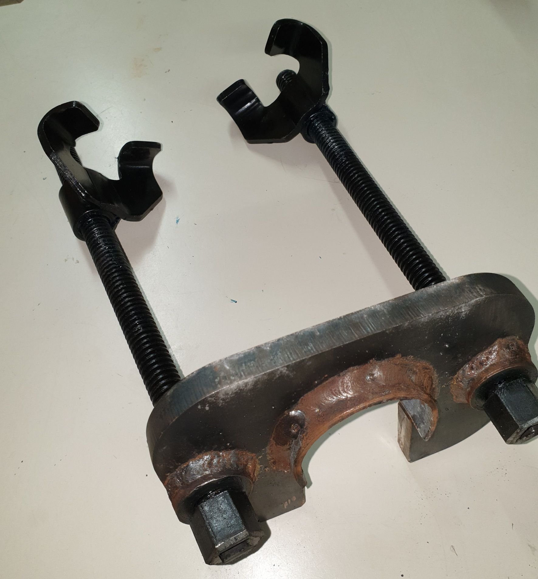

I made up a compressor that locks on to the lower spring seat, very secure and eliminates the issue of the lower coils being small diameter and tight coils.

Baxtor's solution looks to be the most secure (and safest) thus far. Wayne has the same freestanding device as Tom and also made a few mods to it, but that thing can still be quite scary....
