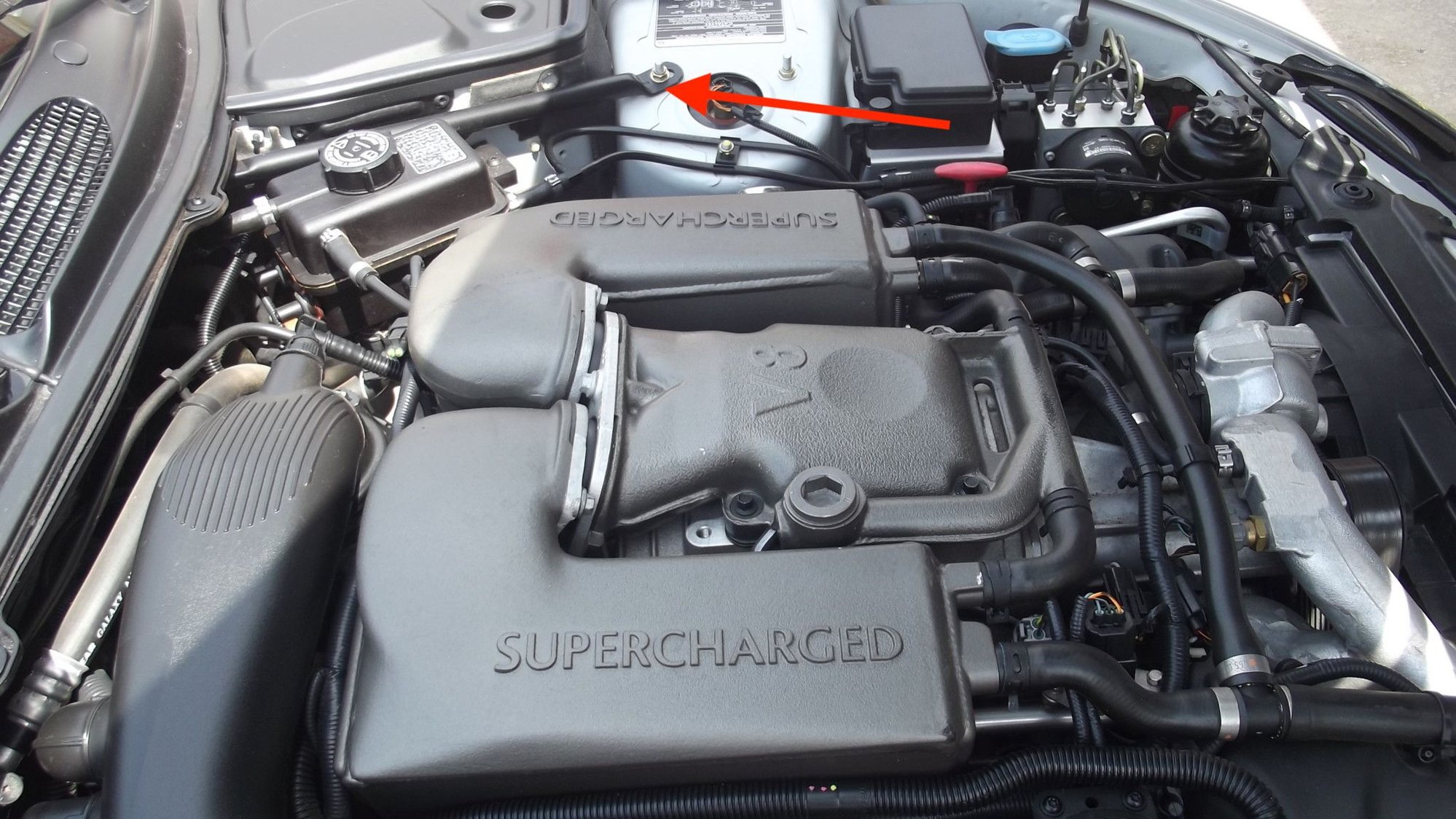

Looking through the photos of my old anthracite XK8 convertible I noticed that it has a pair of braces that run from the firewall area to the shock tower. I noticed the same thing on the XK8 and XKR convertibles currently in Bring a trailer. I'm using one of their photos because it is clearer to see what I mean than on mine. The XKR coupe does not have this.
I was wondering if fitting them on my XKR coupe would have any effect on handling? Can they be installed? I was also wondering about the aftermarket braces that cross the engine, but I don't think one like that would fit under the bonnet.

In most unibody cars, the body itself takes the upper a-arm suspension loads. That would flex the chassis and affect suspension geometry.
Our cars use an independent chassis sub frame for the a-arm's, so those loads do not transmit to the chassis in the same way.
It wouldn't do any harm to add a brace, but don't expect it to suddenly taughten your suspension.

I'm aware the coupes are more stable. I was wondering if adding the reinforcements convertibles have to a coupe would produce any further improvements?

If the parts diagrams are any indication retrofitting to coupe would certainly be possible but hardly time/ cost affective due to the complexity of the attachment method at firewall.
The torsional specs for the coupe have been published somewhere (can't remember where) and they are quite impressive, not sure any noticeable improvement would be had.

Those braces compensate for losing the roof on the convertible. Since the coupe has a roof, very little if any gain would be had by adding. In my opinion, the convertible could use even more bracing.

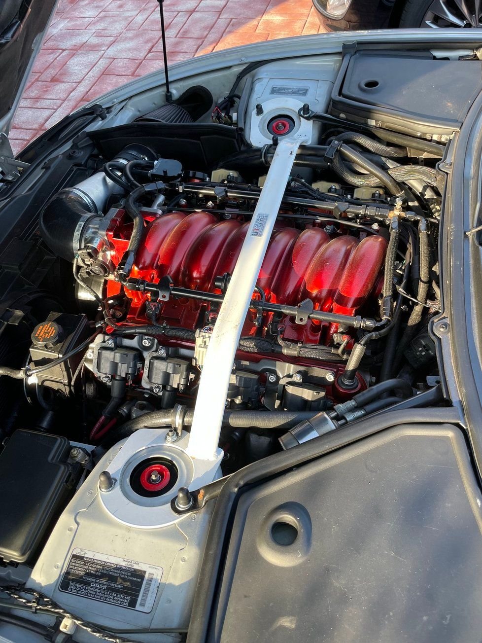

So, where did you find the cross tower brace?

No help for you but when I searched high and low there are none for the 4.2, only 4.0.

I bought this one HERE for my car. I have a 6.7L LS motor in there and it fits just fine. I can give you some measurements if you need them to see if it would work for you.

I strongly disagree with that.
The x100 conv has a tremendous amount of cowl movement (shake)
This bar lessens it enough that it is noticable.
