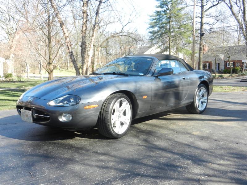

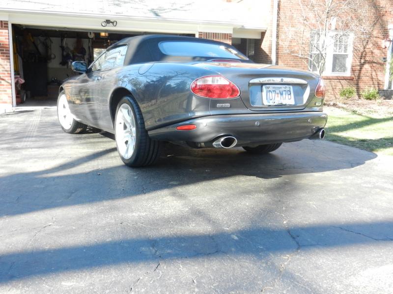

Well the jobs all done. Had er out and about no squeals and she stops as well as ever with the akebono's. So heres what I did. Removed wheels and had them refinished and replaced P zeros with PS2's. replaced brakes and the front rotors. Painted rotors and calipers. Changed oil. Now I'm
ready for summer after alignment which will happen thursday. Heres some pics!

Looks great! Another akebono convert too...well done.
