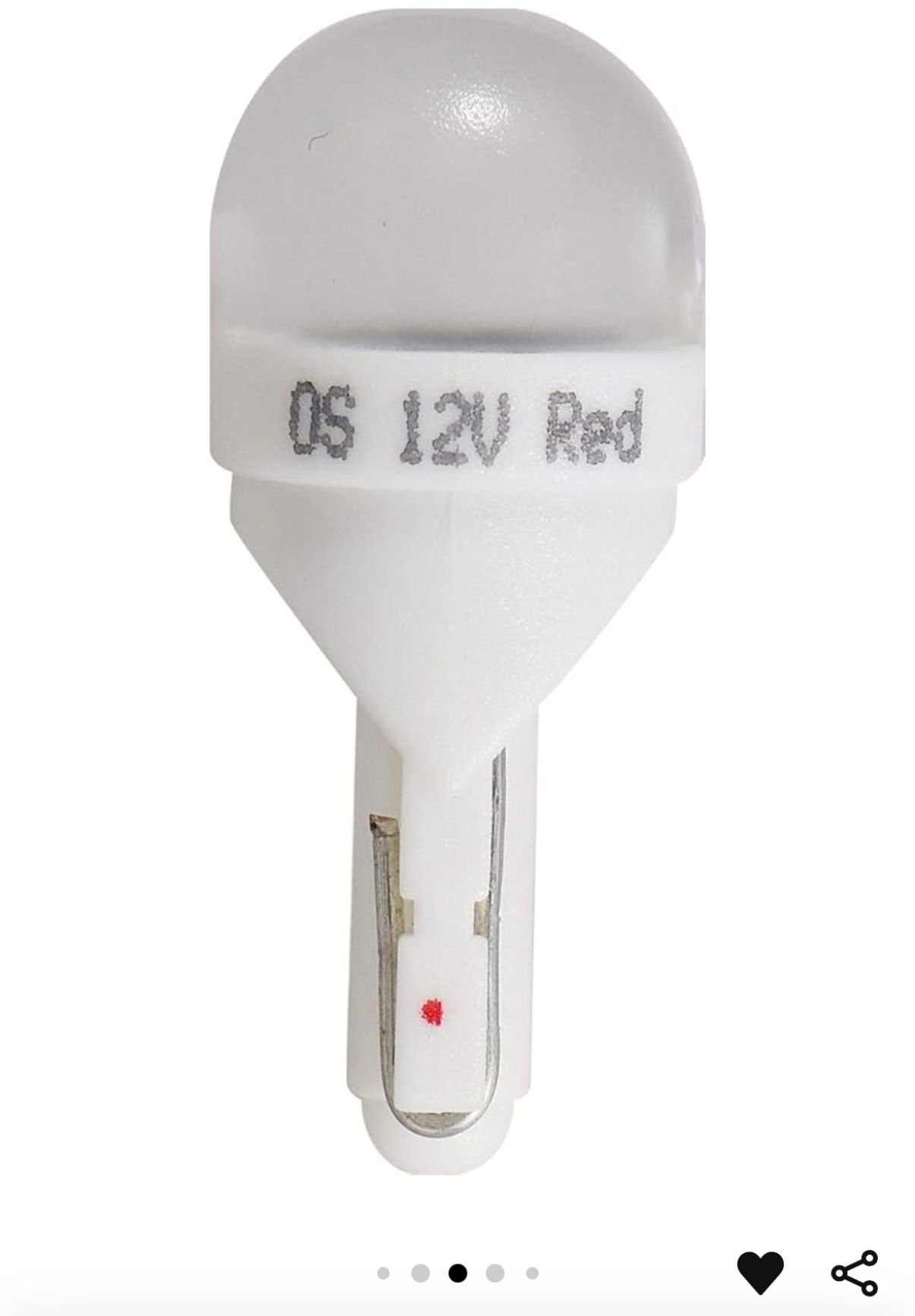

FYI, you can get the dash bulbs with the polarity marked on them. That eliminates the possibility of putting them in backwards, and no need to leave the key on…..
https://a.co/d/1iNDo20
