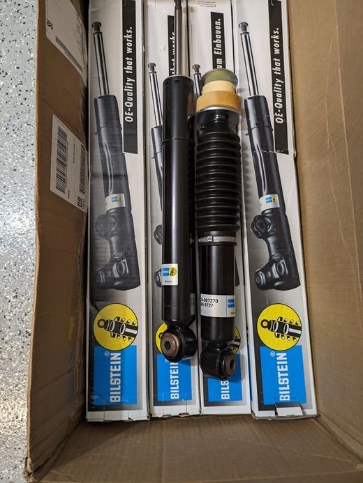

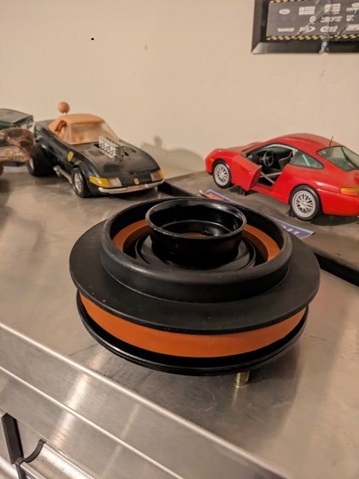

Great advice thank you. What I've started with.
Welch is out of stock, found mounts comparable at Summit Racing and Shocks on Ebay of all places set of four saved me $45 each.https://www.summitracing.com/parts/U...5/applications
Will be taking the car apart and see what else lies dried out. Arizona is hard on Bushings and rubber. At least it's a dry heat LOL.
Keeps you guys posted on progress -Cheers, Mike

Those dampers are certainly the way to go but l worry the top mounts may need to be revisited sooner than you may like.

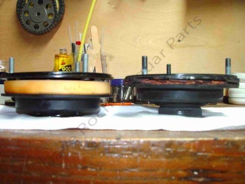

Genuine mounts have half a chance of doing the job but l gather they are not genuine. The current crop of aftermarket mounts will have you redoing install in quick succession. (Full disclosure, l sell a solution but this is not about selling anything ) "Bad top front mounts" would have to be one of the most common thread subjects on this and other forums.
Unfortunately many owners find out themselves rather than from others before them.

Just from experience, they will get you 12-18months of use and then start to look like your old ones - how do I know - have replaced mine 5 times in 11 years - went with OEM style twice, Welsh poly twice and this last time was a set of OEM style I had purchased as a spare set. My next set will be from our forum members (still have the carcass from the recent replacement for reuse)

sell the mounts you bought, on eBay or wherever. If you can get 50 cents on the dollar for them, that’s still way better than installing them and then having to do it over again in a matter of months, not years. The quality of the retail mounts is uniformly poor at best to abysmal at worst. Doesn’t matter if you buy the genuine Jaguar part , or aftermarket , they are all junk .
theres only one way to get a decent mount and that’s to buy them from the forum member who makes them himself.

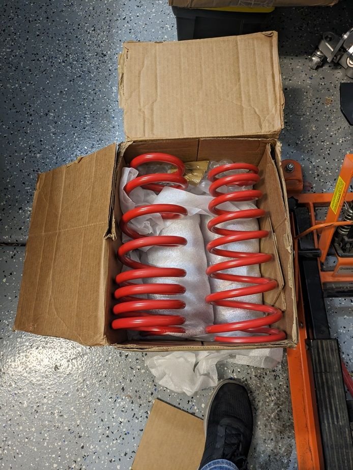

Thank you guys for the advice. I am in conversation with Steve just this morning. I do allot with Summit Racing, they may refund me at no charge. Springs are in, excited to get started.
Cheers, Mike
