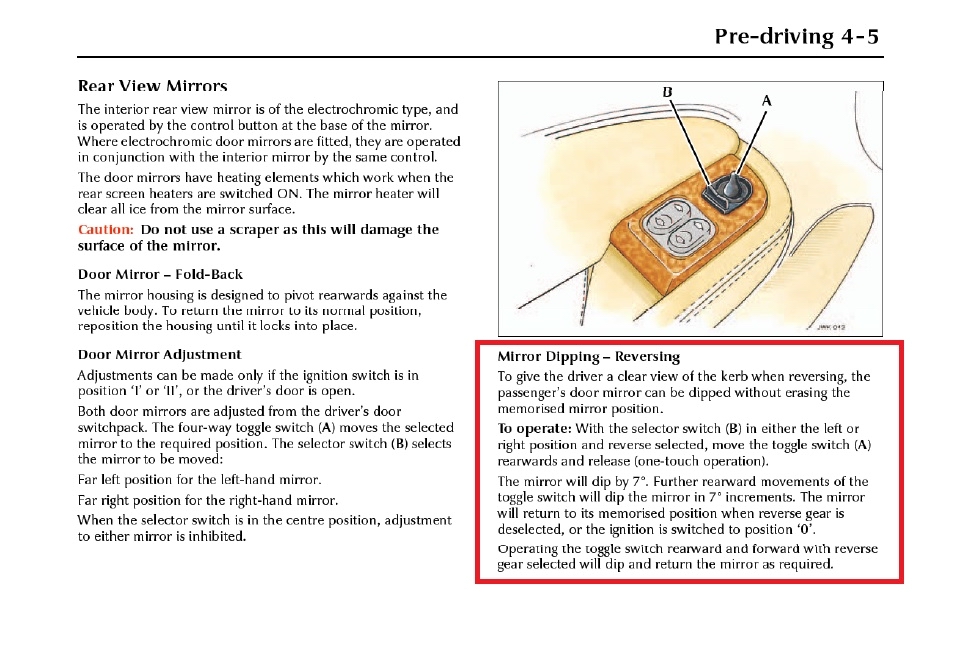

Originally Posted by 2000CAXK8
.......... Was I hallucinating?
Perhaps you were () ........ but the Powerfold Mirrors DO have a passenger dip function.
Note the selector switch (B - see section boxed in red) MUST be in the left or right position for the dip function to operate.

Ah now I understand. I must have gone to tilt it down a bit and been surprised when it took over and was dropping 7 degrees each time i touched it.

Originally Posted by frankc
..... What is the exact sequence you have to do to get the mirror to automatically dip down then automatically back up again when reverse is de-selected?
I posted the exact sequence in #4. See the red box in the graphic.
Yes, its not me. There is something wrong with the mirror memory. I followed those steps to the letter. Tried both sides. Nothing. I can adjust but it will not go back to its normal position.
I did try redoing the memory. i.e pushing the M button till 'bonged' then pressing 1. Moving the mirror. Just pressed 1. The mirror did not move.
Put the car in reverse. Moved the mirror down. Deselected reverse. Mirror stayed where it was. Pushed the 1 button on the memory. Mirror did not move.
If you move the seat at all and push the memory the seat will return to the memorised position.
Suggestions? Disconnect battery etc, reset?

Slow down Frank.
The procedure in post 4 is correct. It only affects the passenger side not the drivers side.
It doesn't happen automatically when you select reverse either.
For the mirror to dip, the selector switch has to be set to the passenger side, put the car in reverse and then pull back on the toggle and let go.
If it does not work then it may well be a dealer level switchable parameter and not switched on.
Yes I know, but I checked both sides, just in case.
It doesn't happen automatically when you select reverse either. That is not what others are saying. But I did dip it manually anyway.
For the mirror to dip, the selector switch has to be set to the passenger side, put the car in reverse and then pull back on the toggle and let go. Yes I know, I can make it dip to the road. But when you de-select reverse it is supposed to automatically return. It is also supposed to move when you hit the memory button after you have adjusted it for whatever reason.
There is a reversing mirror selection section in SDD and it is selected as on. I checked that. I also switched it off and back on.
I am beginning to suspect a dry joint or similar in the circuit board in the mirror.
