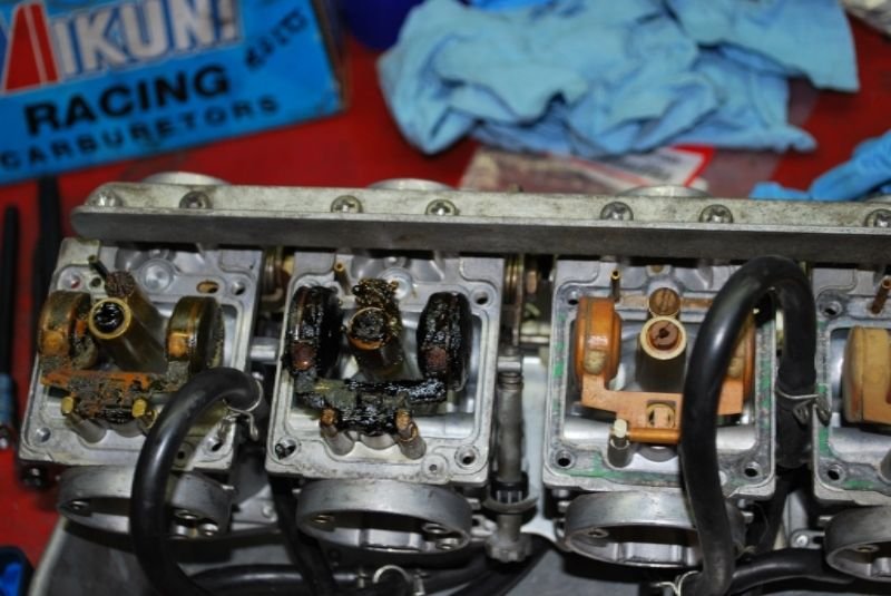

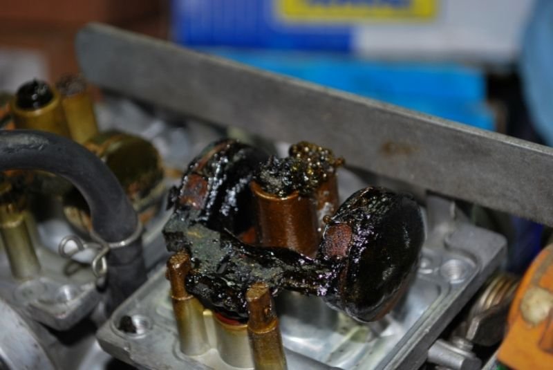

Here is the result of pure gas, not ethanol, that sat for a little over a year:
It corroded the jetting in the two left carbs to the point of uselessness.
I don't understand. I've stripped and rebuilt carbs which have sat unused for 10 years or more on many occasions from barn finds etc and I have never seen anything like that in 55 years of spannering. I've always found each of the carbs to be pretty much the same internally, with only slight differences if the bike was stored on its side-stand, so why would two floats be so badly affected whilst the other two look exactly as I have always found them?

You’re just plain lucky
the bike was leaned up against the interior wall of a climate controlled building, no side stand . The two clean carbs were on the high side and all the gas in them drained into the two crapped out carbs.
that’s all I know . I don’t have any answers, only observations that may or may not be useful to others.
I can with certainty say that if the gas is drained out of any vehicle or lawn mower, etc before storage, then these things won’t happen.
otherwise, who knows what will happen ?
Z
PS: I did work on the service side of the motorcycle and vintage restoration industry off and on for 50 years. So I saw a few thousand machines that had suffered greatly under the ownership of people who just didn’t give a damn.
