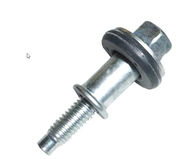

Hello everyone
i snapped one of the valve cover bolts and I’m struggling to find the part number to purchase a replacement. Anyone who can chime in is greatly appreciated.
I need to drill out the broken bolt … not looking forward to this at all.
1999 XK8 - 4.0L - convertible
cheers

There are 3 different bolts that hold the cam cover to the head.(which bolt?)

Hi, it's similar to this one.

A little late to this thread, but a word of caution on the valve cover bolts - the rear inner bolt is different to the other bolts and studs. It has no location nose to prevent interference with the cam sensor. Fitting a nosed standard bolt on that rear inner position may cause misfires.
See the page on Terry's Jag parts here: https://www.terrysjag.com/category/X...ket-40-V8.html
The standard bolts are #AJ810511
The standard studs are #AJ810512
The rear inner studs are #AJ810721 and requires the mounting #AJ810510
...or impale the cam sensor if you're really unlucky
Old Apr 10, 2023 | 10:35 AM
Hell-Cat's Avatar
Joined: Mar 2021
Posts: 176
Likes: 140
From: Western Mass
I'm not sure that it could get that bad, but it could be hell trying to diagnose a misfire after a cam cover gasket change
I'm just finishing up a chain and tensioner update on my 01 4.0l coupe and still have my covers off. All of the bolts positions are through holes with the exception of the 2 centre bolts and the rear inner which are blind holes. The rear inner bolt hole is 5mm shallower than the centre bolts.
Trying to pull a standard nosed bolt down in that rear inner position will probably result in......snap !
