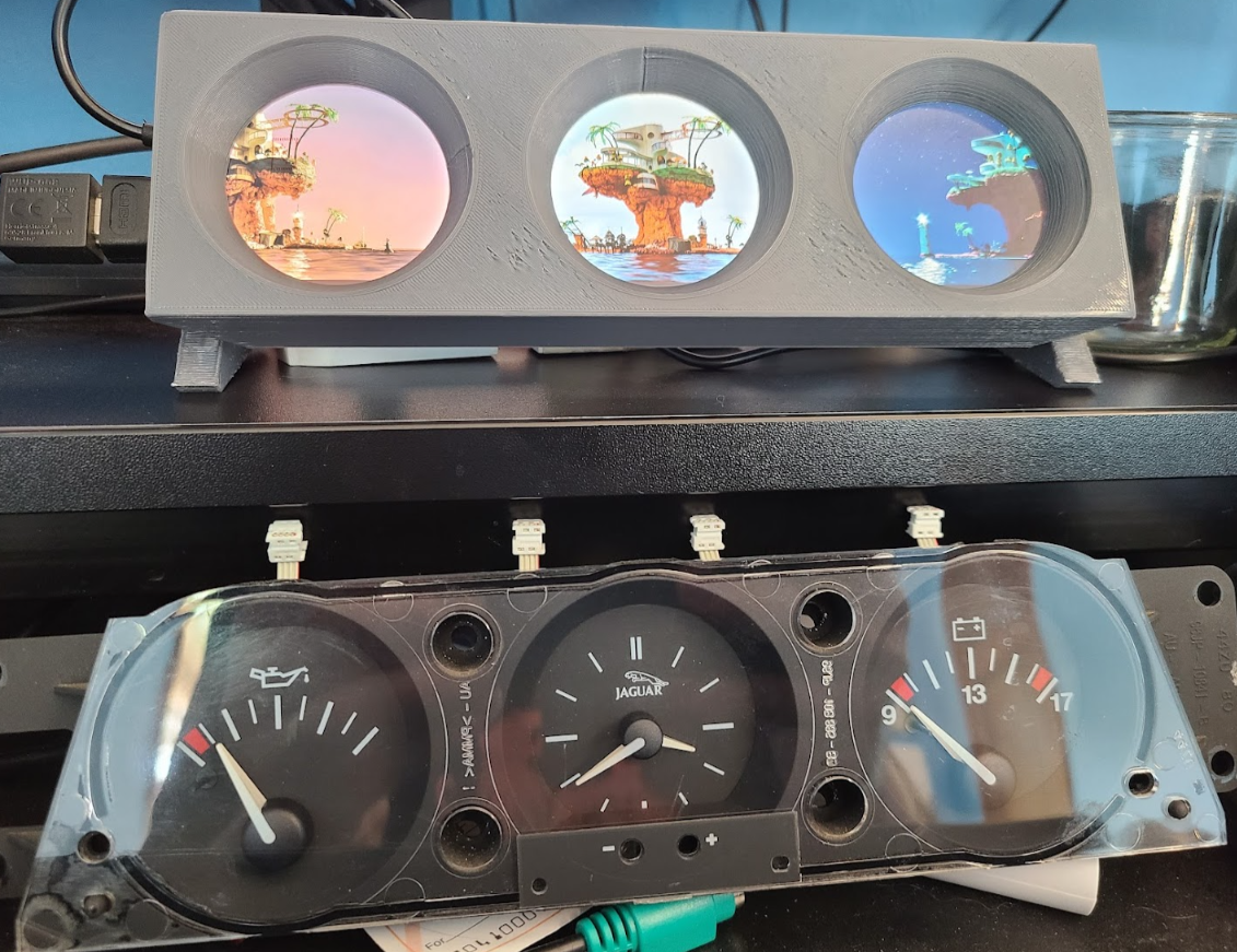

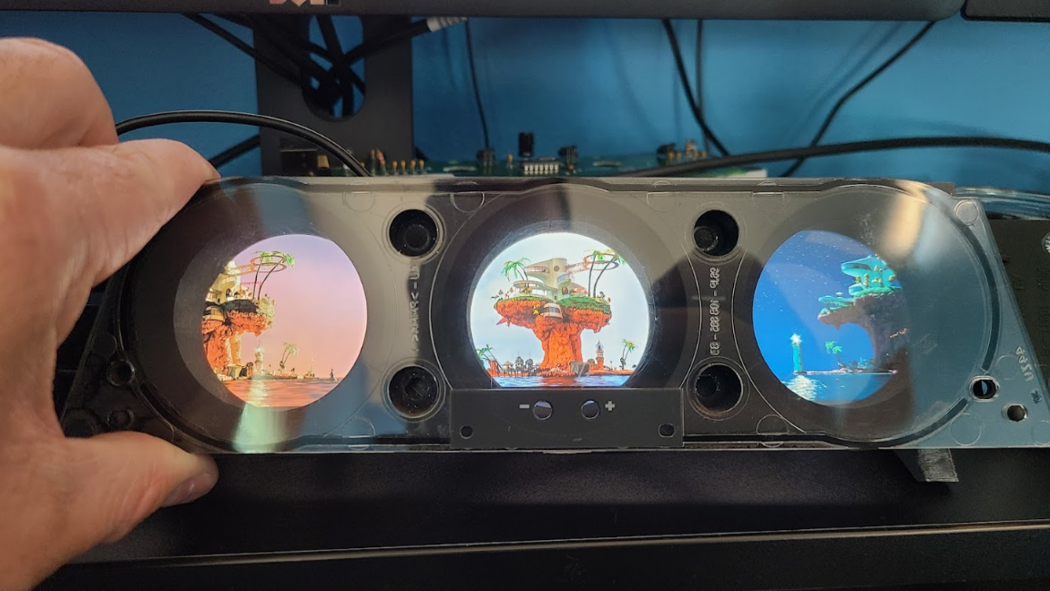

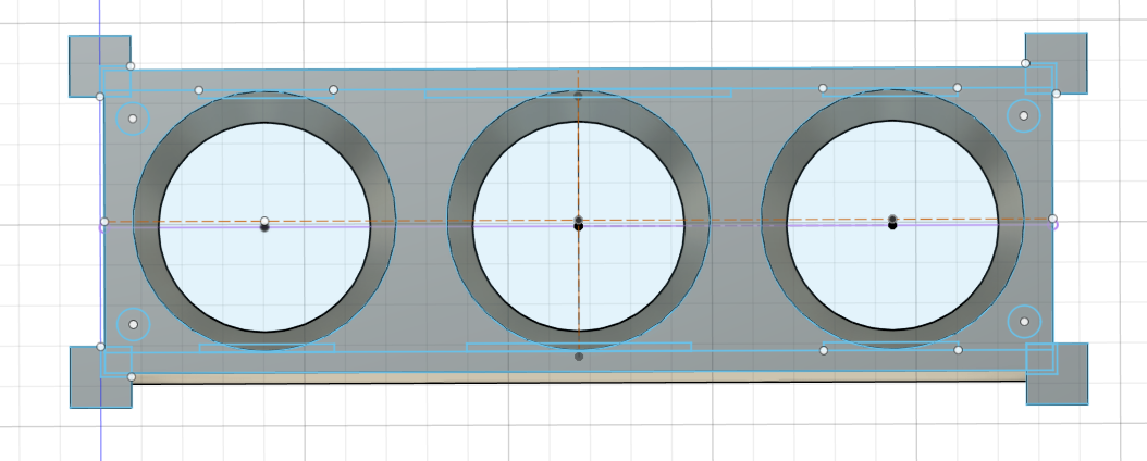

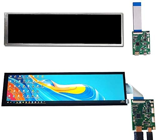

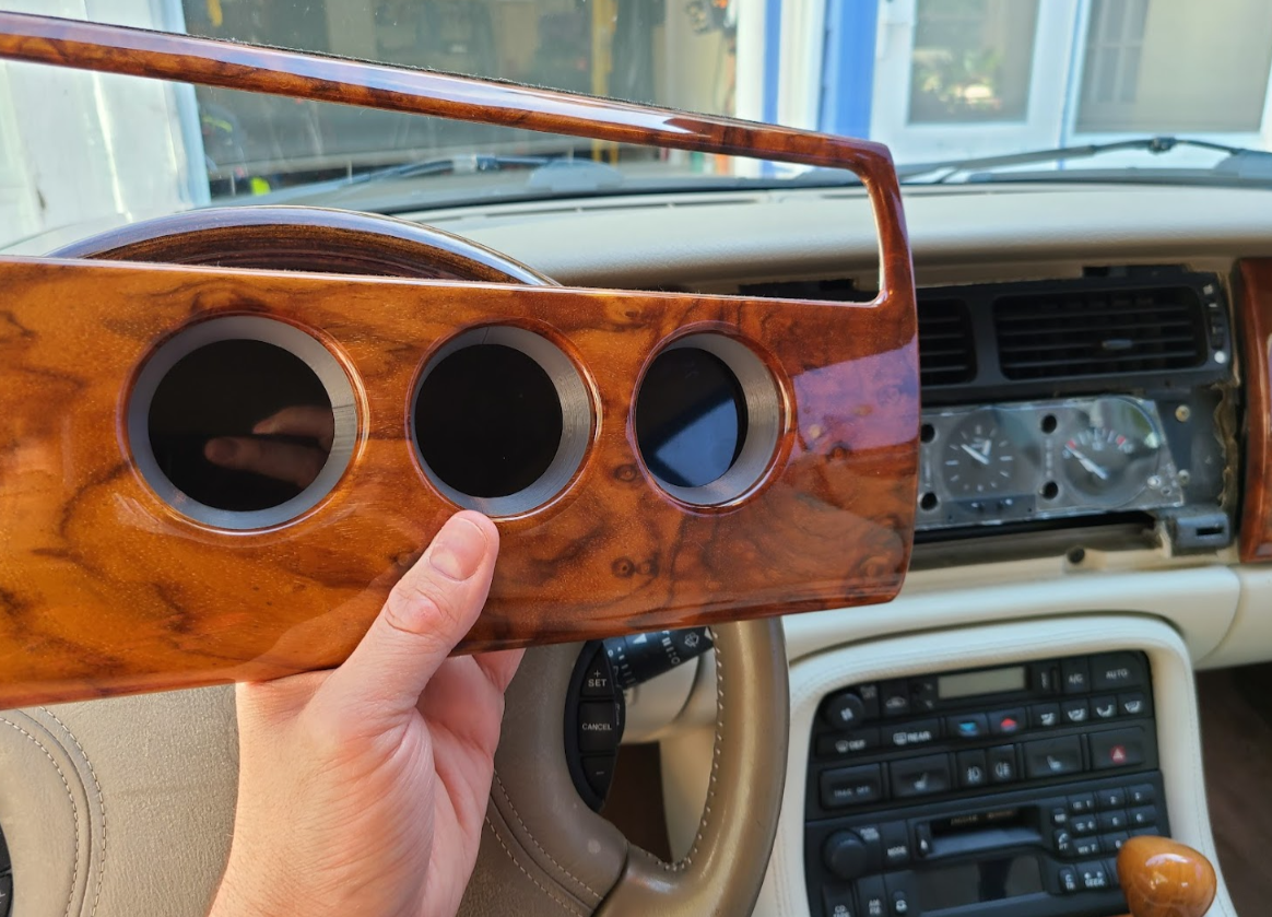

Things are gettin' experimental in this house.
Last winter in the midst of a lockdown haze I bought one of
these screens these screens
on a whim.
It's an 8.8" IPS LCD screen 1920 x 480 @ 60Hz, runs on USB power, it's very bright and does not feature touch,
The form factor seemed fascinating to me - 8.8" of incredibly wide high-res, bright, vibrant IPS picture. I mucked around with it for about a half hour... but couldn't think of anything to do with the screen so I shoved it back in my nonsense drawer. I figured I'd get around to tinkering with it again at some point (once I had an idea). I had a cool plan to put it behind a mail slot for Halloween but I don't have a mail slot so...
Then, last week, out of boredom, I picked up a broken triple-gauge cluster, similarly just to tinker with. And then it hit me.
So what's the plan now?
Perfect the 3D-printed bracket, make it fit behind the fascia properly - so I can screw it in place and permanently affix it to the car if I decide to. Get it rigged up with a Raspberry Pi 4 with power so that it powers up/down cleanly with accessory power.
And then put it in my nonsense drawer until I think of something to actually do with it, lol.
I like the idea of putting OBD-II gauges there (so that they're actually useful) and it'd also be cool to wire it into my head unit so that I can stream Australian radio over the Internet in the 'states. I've got zero experience with Pi-OBD though so if anyone has knowledge and wants to chime in, well, I'll make the finished bracket public here too.
