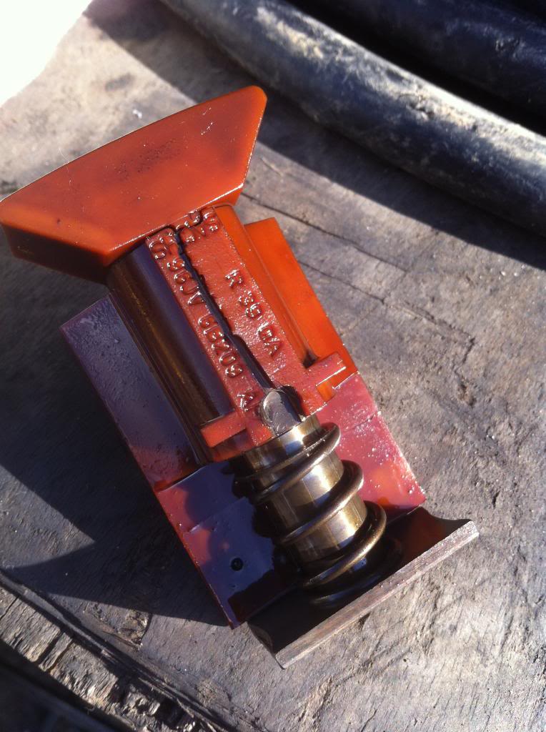

Not sure if this is the worst tensioner ever removed that had yet to fail, but it is likely a contender. 1997 XK8 with 75,000 miles, just done.
Show us yours (failed, or broken of course are worse but how close can they come??)

Looks fine to me

WOW, It looks like you were one cold start from destruction. Way to go.

Man, you are lucky to have caught that when you did! I'd go buy a lottery ticket in case your luck is still with you.

Both of my secondary tensioners were split fully down the middle, too. The "shoe" from the bottom of each is apparently in the sump since each plastic "shoe" was missing. My 1999 XK8 coupe has 78,000 miles on her.

Wow we were lucky. Exactly the same as mine i did a few months ago.

Now there's a real mechanic. Cleans up the old part to "look new" condition........well done.

It's just a crack, put some filler in there and go with it.

1998 XK8 with 84k miles and no obvious noise or rattle coming from the engine.

Mine looked similar, but with some pieces missing from the rails
