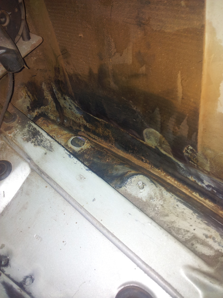

Started today with the carpet removal, found my rusty floor panels.
And also found something else.... Rust on the side of the tunnel on the passengers side ! Is this common ? What can i do about it ?
I ordered the floor panels from eBay, they arrived today and look OK !
Going to see a welder tomorrow hope its not to expensive :O

Floor pans are fixed Used the ones from Jaguar XK8 and Jaguar XKR Parts and Accessories. Tunnel rust repaired . Wheel arch repaired (both sides) and repainted.

Mine just had that very same job done to pass the UK MOT inspection. Also the rear of the sills are worth checking...
Best wishes, Colin
