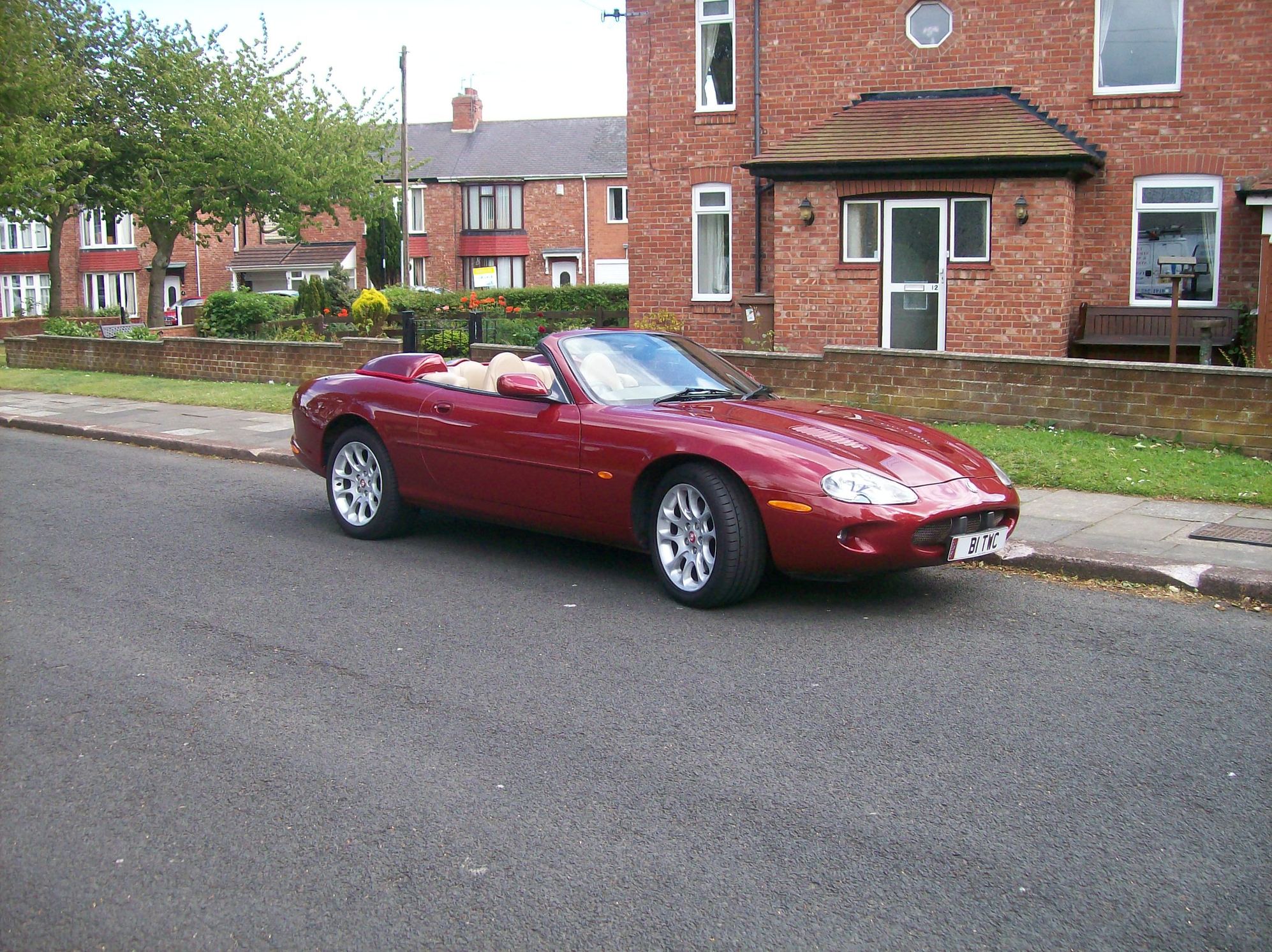

Got a picture and a price. I know someone who is looking for one.

Now that is a very nice looking car. On a private plate too. Do me a favour next time you go out to the car give the ignition keyhole a spray of WD40 and a gently tap. Sometimes the key hole chip plays up.
I will pass on your details.
