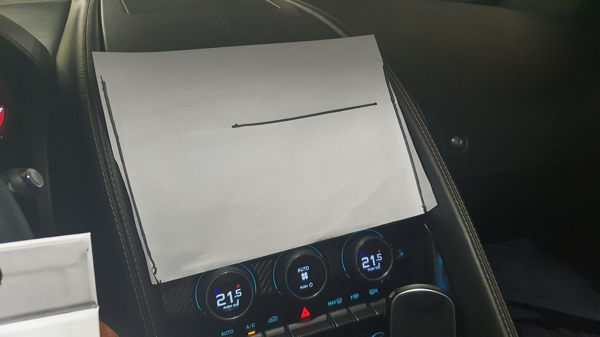

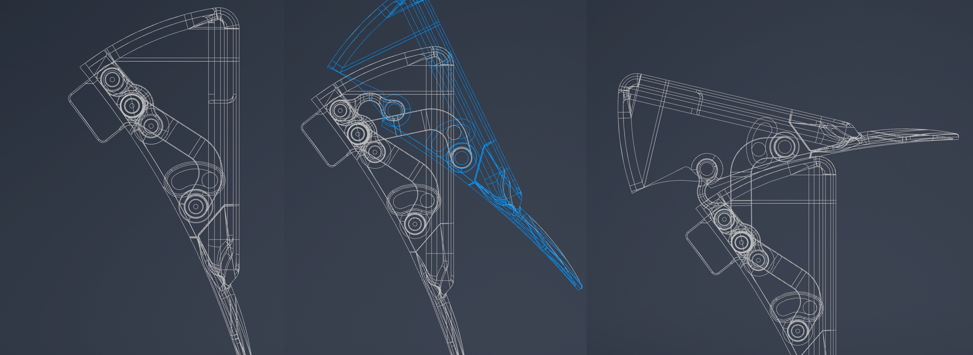

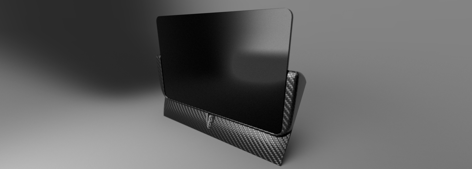

I made some prototypes but still unsure, so looking to collect ideas (or steal ) a good concept.
Main issue, screen resolution, size and software is inferior and looks dated. (mine a 2015) so idea is have a tablet above with a mechanism that rises tablet and reveals buttons/screen stock unit.
Req:
Design good for a future carbon fiber mold
Automatic hinge (magnetic for now)
Base completely flush to look "almost" stock with new car trends of floating screens

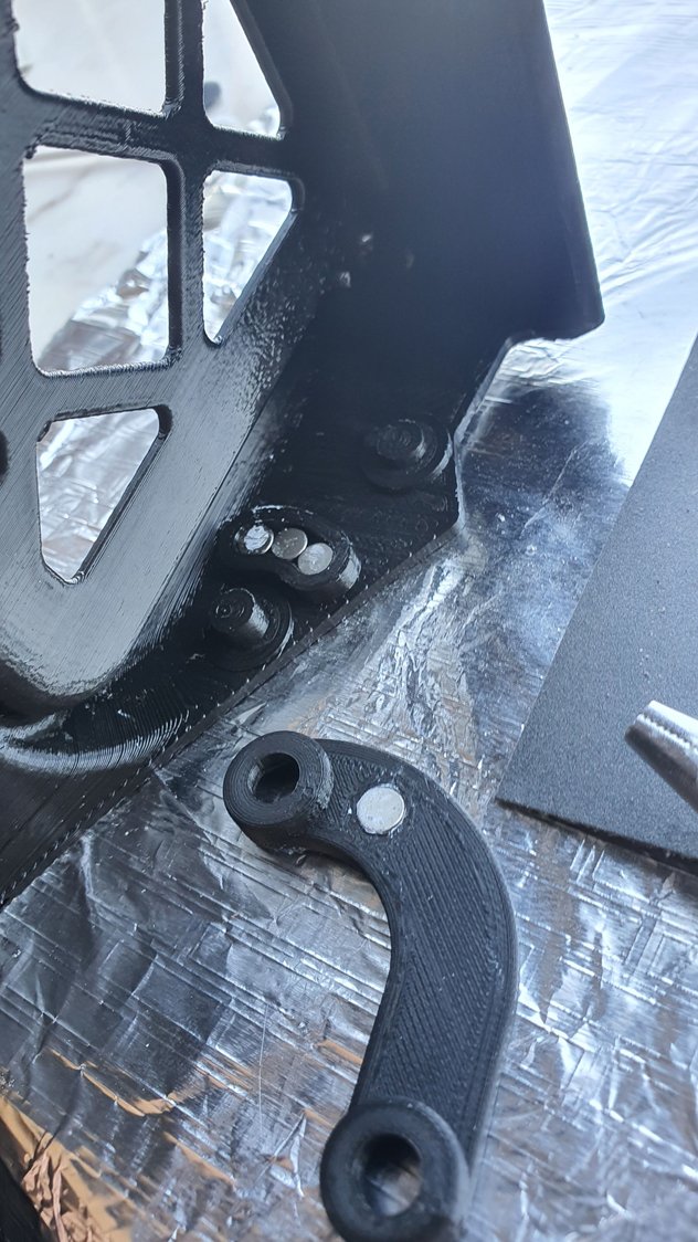

Progress:
magnets with rotated pole in middle to help lift, works ok but not there yet.

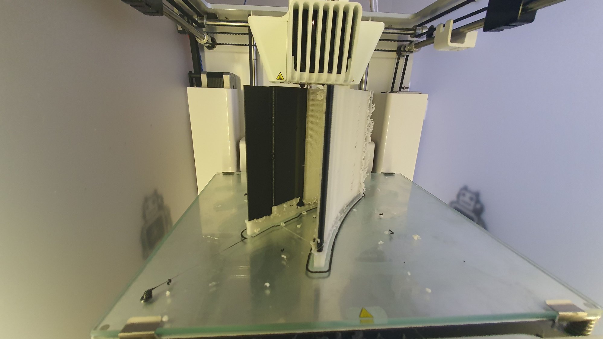

some improvements and this time print with resin

This looks amazing. I will be happy to help print parts if needed as I know the printing portion takes the longest or provide you with filament!

This is in every way awesome.

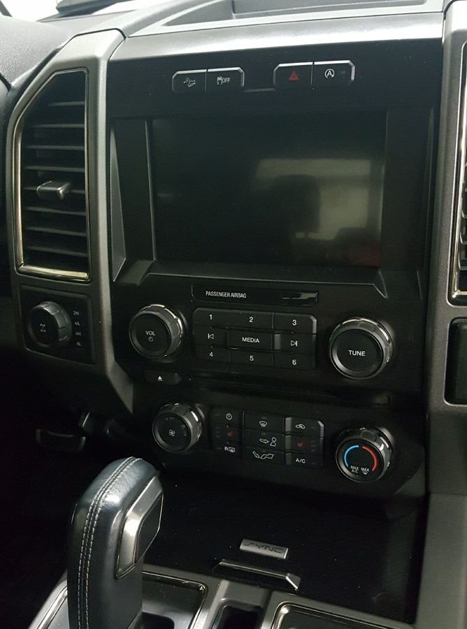

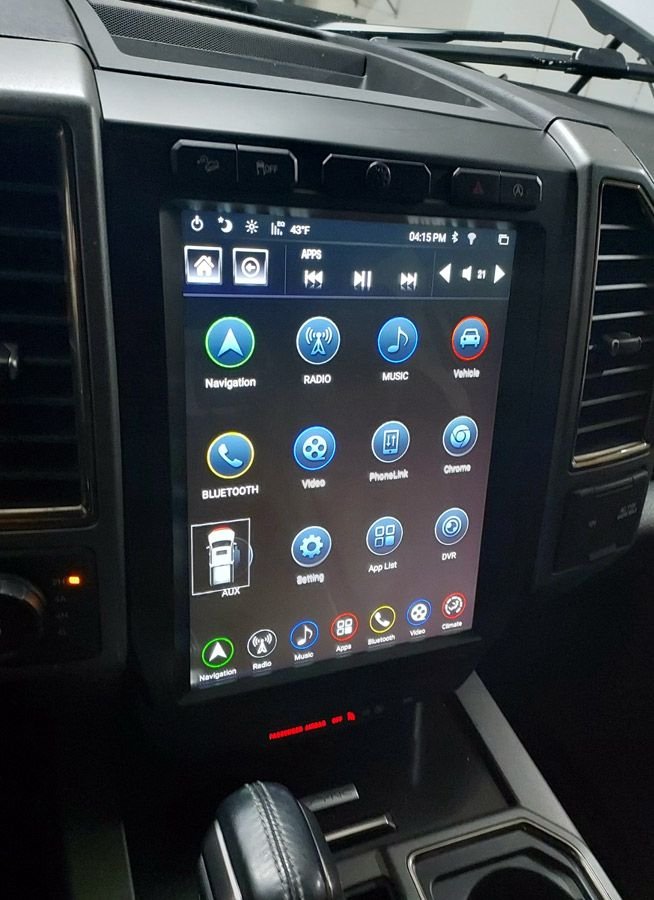

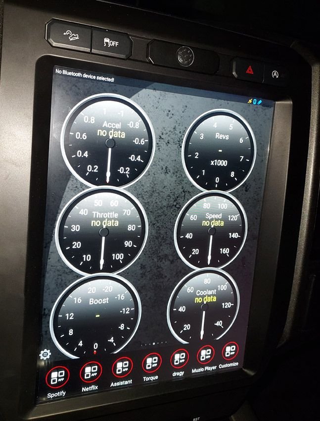

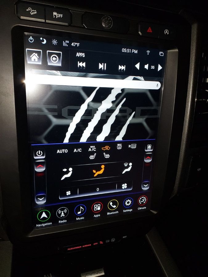

Hey...Very cool work! Given there are now, quite a number of F-Types, and most everyone would like some upgrade...It is a shame someone does not make something like this for the F-Types. I just put this in my Ford Raptor recently and it is soooo much better than the crappy Ford SYNC3 that was in there...It even has a CanBus decoder so all factory options and steering wheel controls work...And Climate controls are now digital and built in to the UI. Maybe someone will decide it is worth making one!?
DC
Factory - OEM - Before
After !
Climate
Torque Gauges

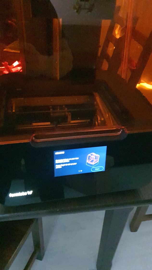

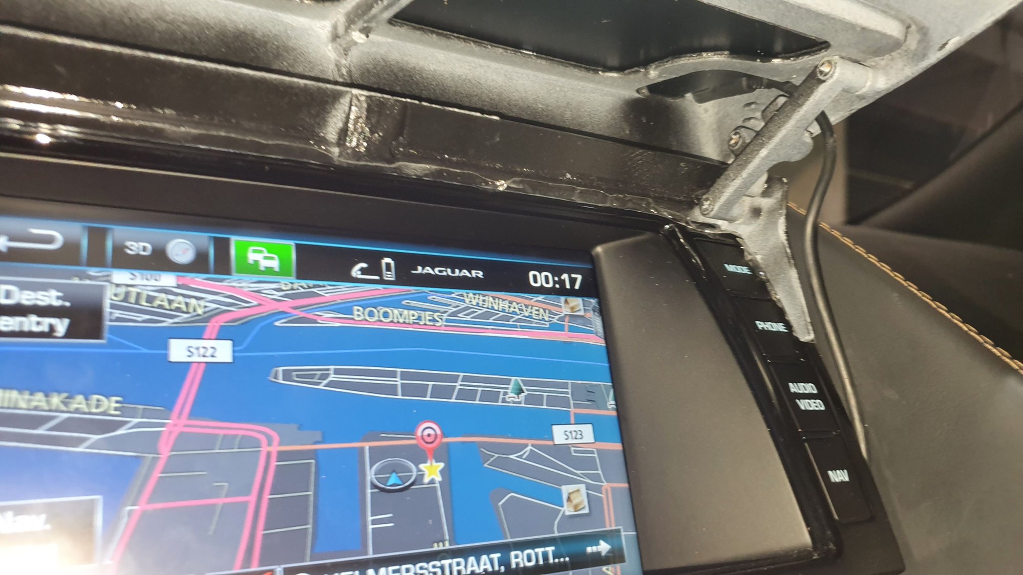

Thanks but did print in resin. When is finalized I can share the files to you print to yourself.

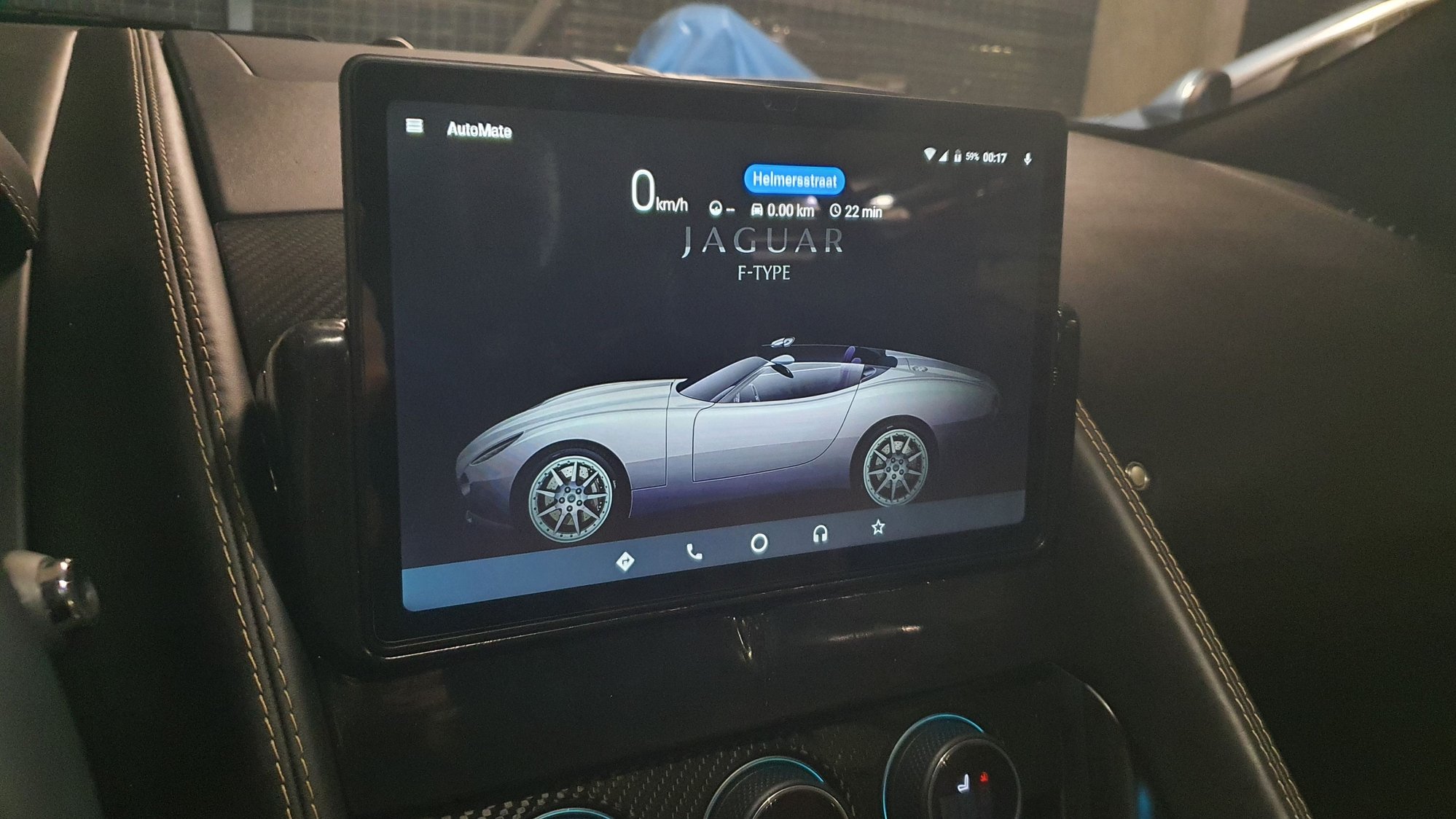

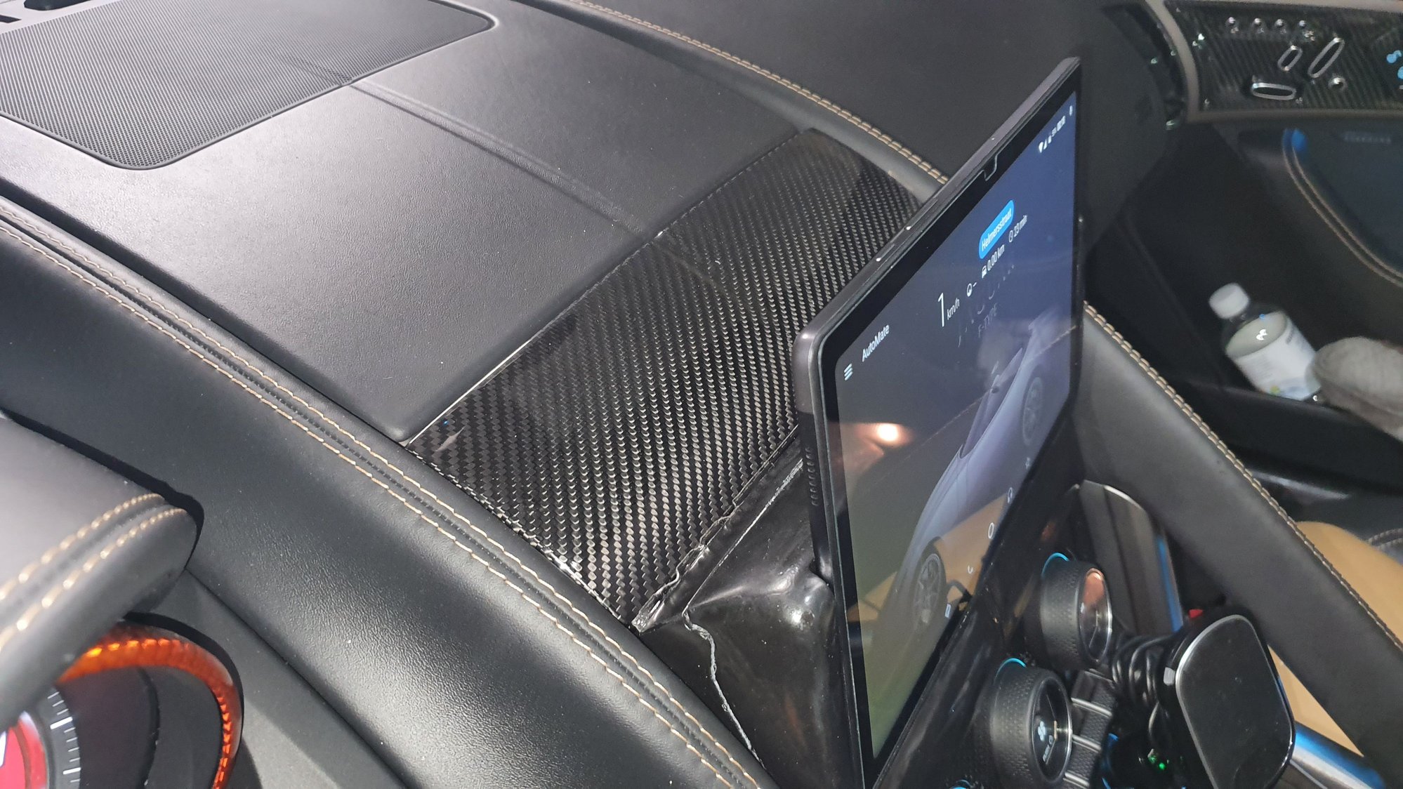

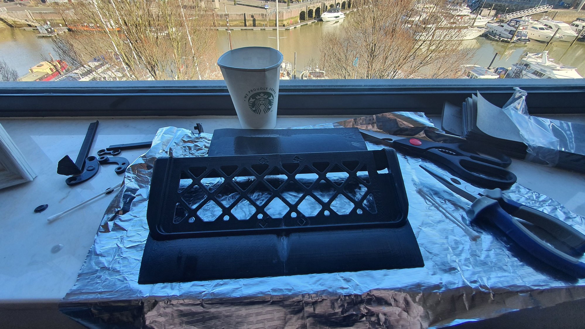

Progress:
After several designs to select best for CF molding, choose this one, some fast s*** paint and some vhb tape to check if I could still access buttons and see stock screen:
Next:

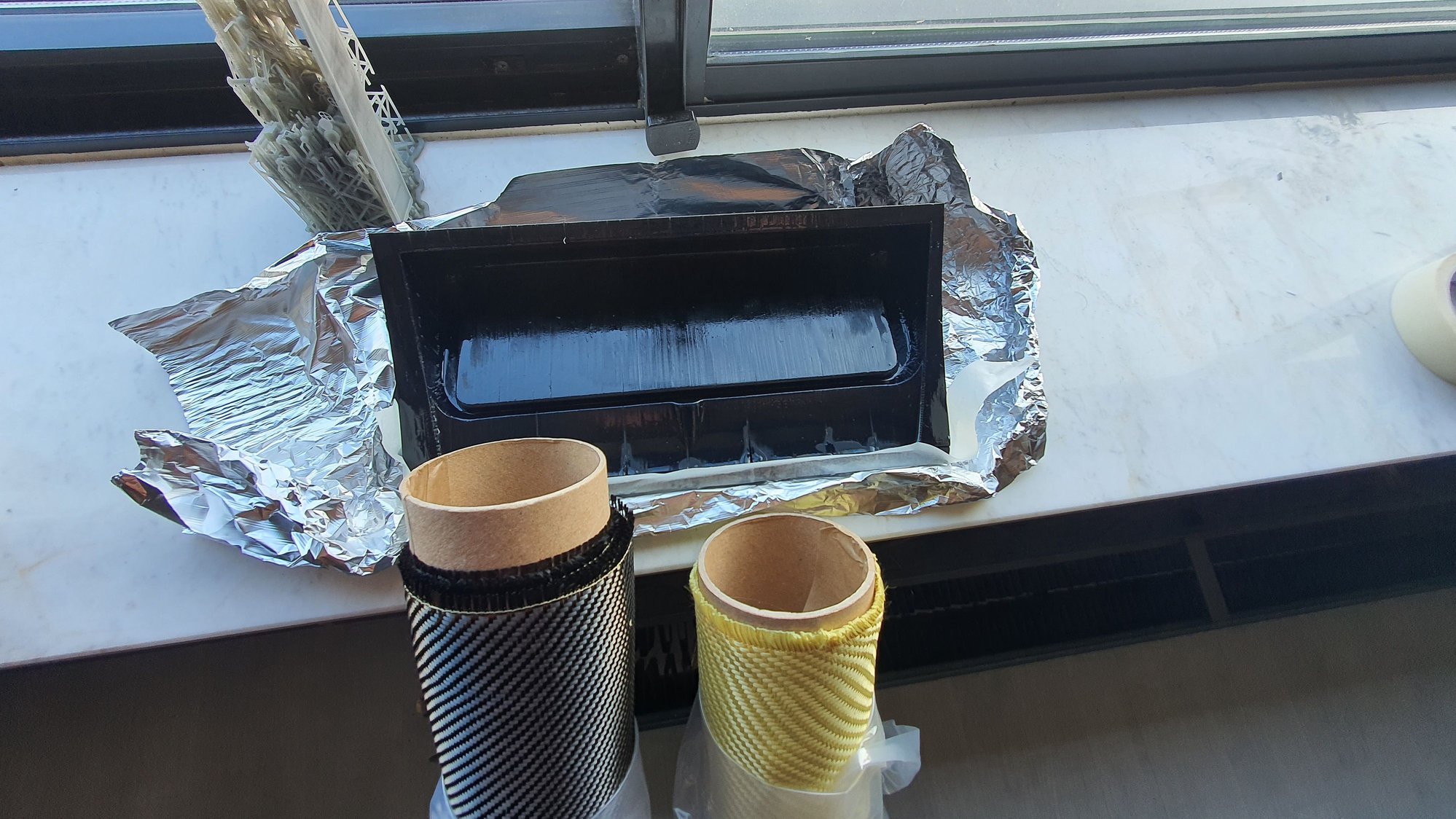

-Make mold and make CF get parts, measure it and adjust design to thickness
-Think how and where place motor, would be cool lift up down with a IR sensor or soft touch for the up/down or in reverse for the camera.

I will test with back layer of Kevlar to check if works on reducing layers when applied on CF twill back. I plan to make other parts as the front grill.
