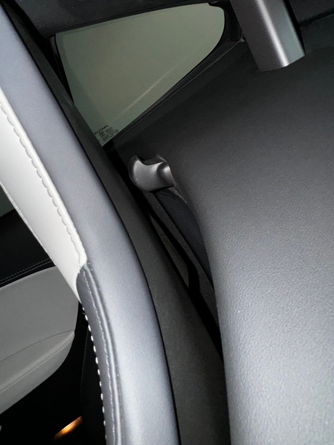

Greetings all,
Has any noticed or tried to remove the coat hooks right behind the passenger seats? I’m tall and could use just a few more inches to recline the seat to have a perfect seating position, and those dang hooks appear to be the only thing stopping my from reclining the seat that extra amount before it hits the bulkhead. They appear to be molded into the plastic/leather rear bulkhead but wondered if anyone had taken a look at these.

This was discussed a few years ago, and on the Performance seats at least there is a hollow in the back of the seat which fits around the coat hook so that the seat can go all the way back without fouling the hook. Can't remember if the Sports seats (ie base seats) have the same hollow, and dunno about the later (MY2019 on???) seats which replaced the Performance seats (which you appear to have going by the pic).
Moral of the story - move your seat all the way forward and then lean the backrest all the way forward, and take a gander at the back of the seat where the coat hook would hit/foul, and maybe you will see a hollow.

Unfortunately the slimmer facelift seats don’t have the hollowed-out section to account for the hooks. I wish it was just an easy screw I could loosen and pop them out. Any ideas from the group would be more than welcome!

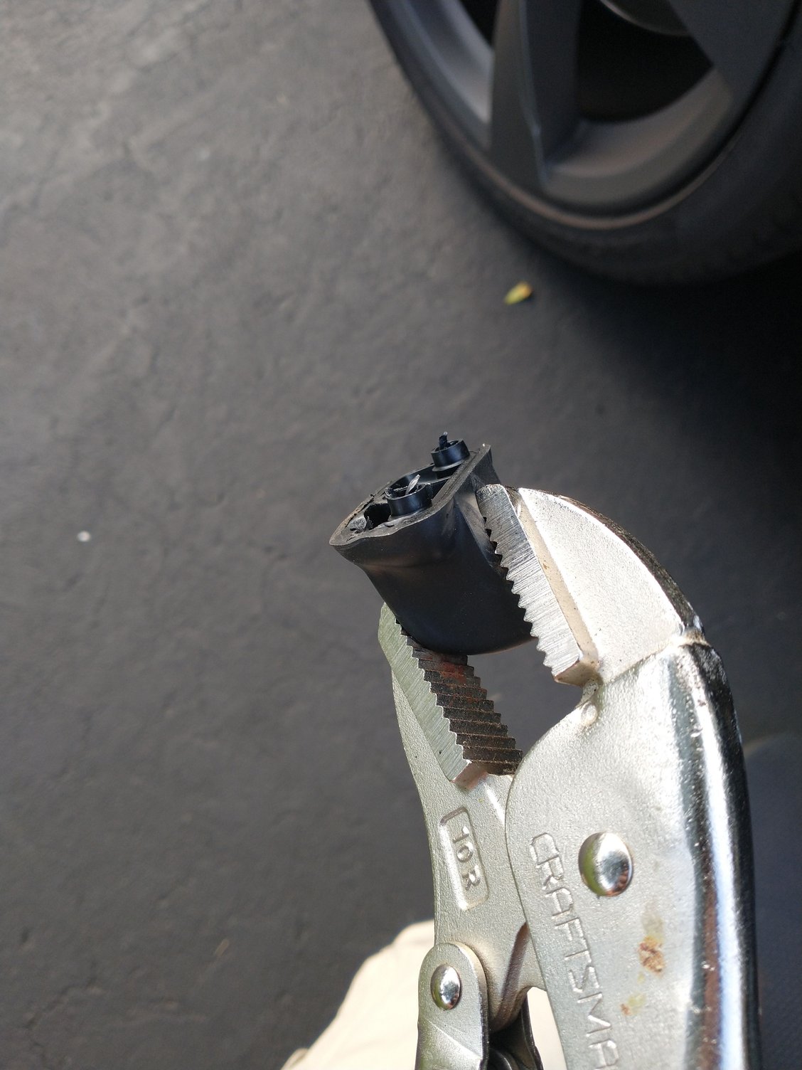

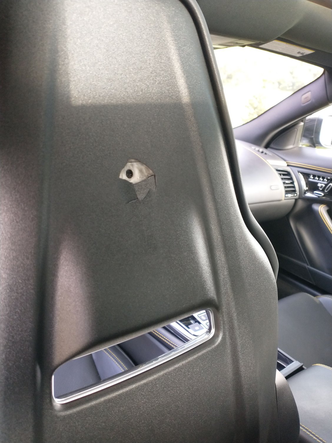

Take them out before they puncture the back of your seat! Not thrilled with the design of the coat hook or seat settings on my 2018 400 Sport coupe. I'm 6'5" and need all of the leg room I can get. Apparently where I place the seat put enough pressure against the worthless coat hook that it fatigued and punctured the back of my driver's seat. I quickly decided that the coat hook had caused way more damage that any good it will ever do me so I removed both. I used a Dremel tool for the first one which made a mess and took awhile but I learned it is 2 small screws holding it on so the second I removed with a large vise-grip pliers and just pushed the screws out the back of the top trim piece. It leaves 3 small holes which I'll cover with some black tape but in reality they aren't seen unless someone is moving the seat forward and looking behind it.
If you have similar seats and keep your seat back against those stupid coat hooks, I'd suggest being proactive and removing them. Really poor design placing something behind a seat that can puncture it and/or not placing a physical stop on the seat from preventing it from hitting it.
