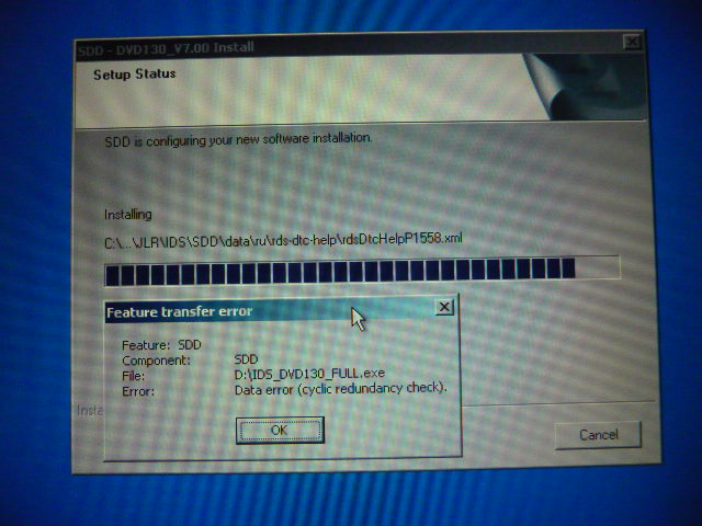

I am making slow progress.
1.I got another laptop--Dell Inspiron700---1.6 MHz,2GB ram,60GB hard drive,WindowsXP Pro---all for $80.Works great.
2.Loaded Mongoose drivers and tool connected---drivers from the vendor and Drew Tech drivers worked.
3.The files on the CD provided by the vendor appear to be corrupted or something---anyway SDD will not install.See attachment.
4.Took a look at the download site mentioned earlier---time to download 11hours wtf.So I have ordered my own SSD CD130.07 from e-bay.

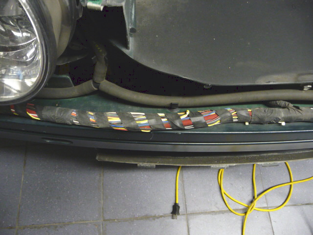

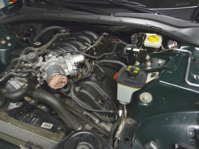

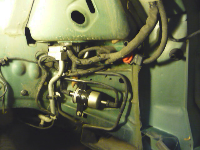

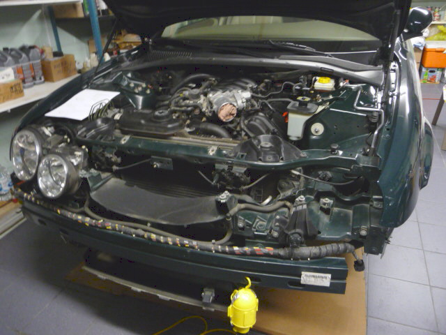

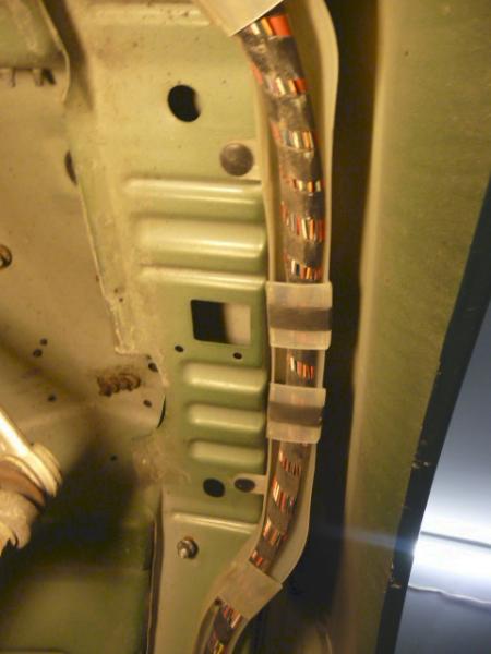

My JLR SDD disc arrived today--DVD 130.V7.113.It loaded as it should and activated the JLR Mongoose.Hooked it to the car and voila read the VIN and asked if I wanted to open IDS since my car is a 2004,4.2 NA.Took a cruise around and found a bunch of codes in the auxiliary systems.Total cost(for now)$330 including used laptop(and software).
I have taken my car off the road for winter and to perform my maintenance program.The plan is to change all filters and fluids---so far have changed diff fluid,spark plugs,oil/filter.
I also have to fix the DRLS and low beam H/L--unfortunately it looks like a wiring problem(s)--bulbs,fuses and GECM are OK.
Have attached a few pics for interest.
