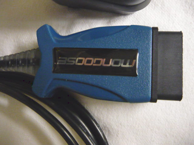

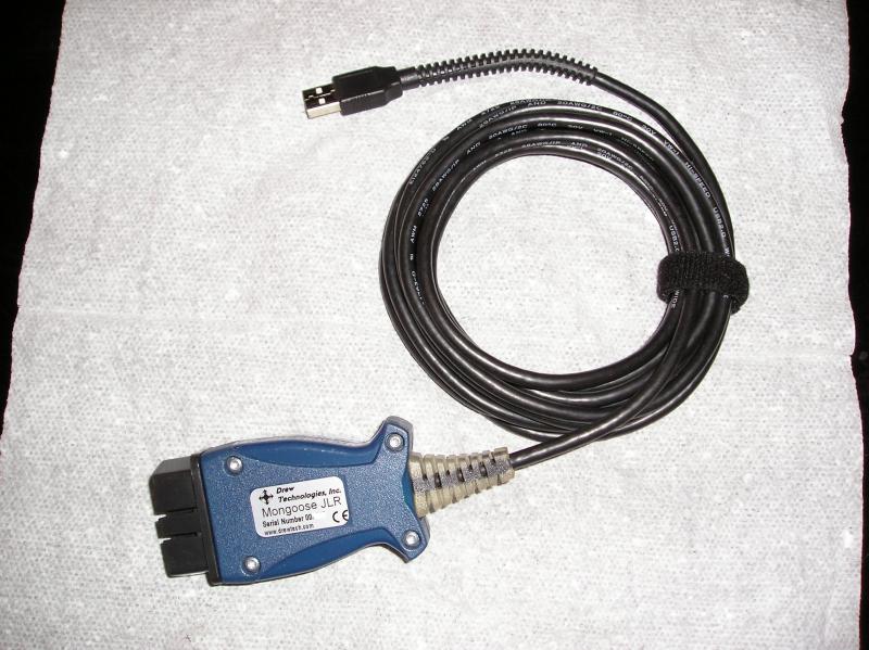

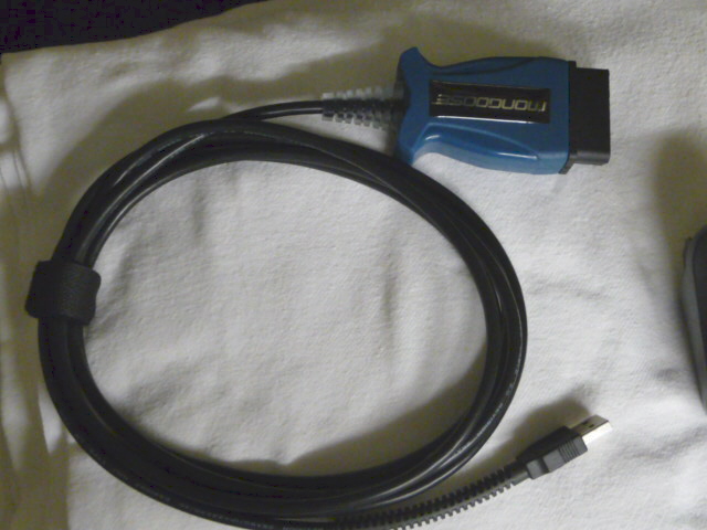

Default Mongoose Arrives
My "Mongoose" arrived today.Pictures are attached.I have loaded the drivers and my laptop recognises the tool.So far I am not able to load the IDS/SSD from the CD sent with the tool.I may have to buy one off ebay.

Thanks for the pics. The label is certainly very similar to the real deal. Notable the label is reversed on the tool, don't know whether it means anything. I have two of the interfaces, and paid full boat for each. Not worth it to me to have to deal with the quirks of the cheaper knock-offs. I also see that yours is put together with cross-point fasteners, both of these here are put together with Torx fasteners.
I don't know what to think about the SDD software, or why it won't load. If you get another disc from eBay, let us know how it goes.
