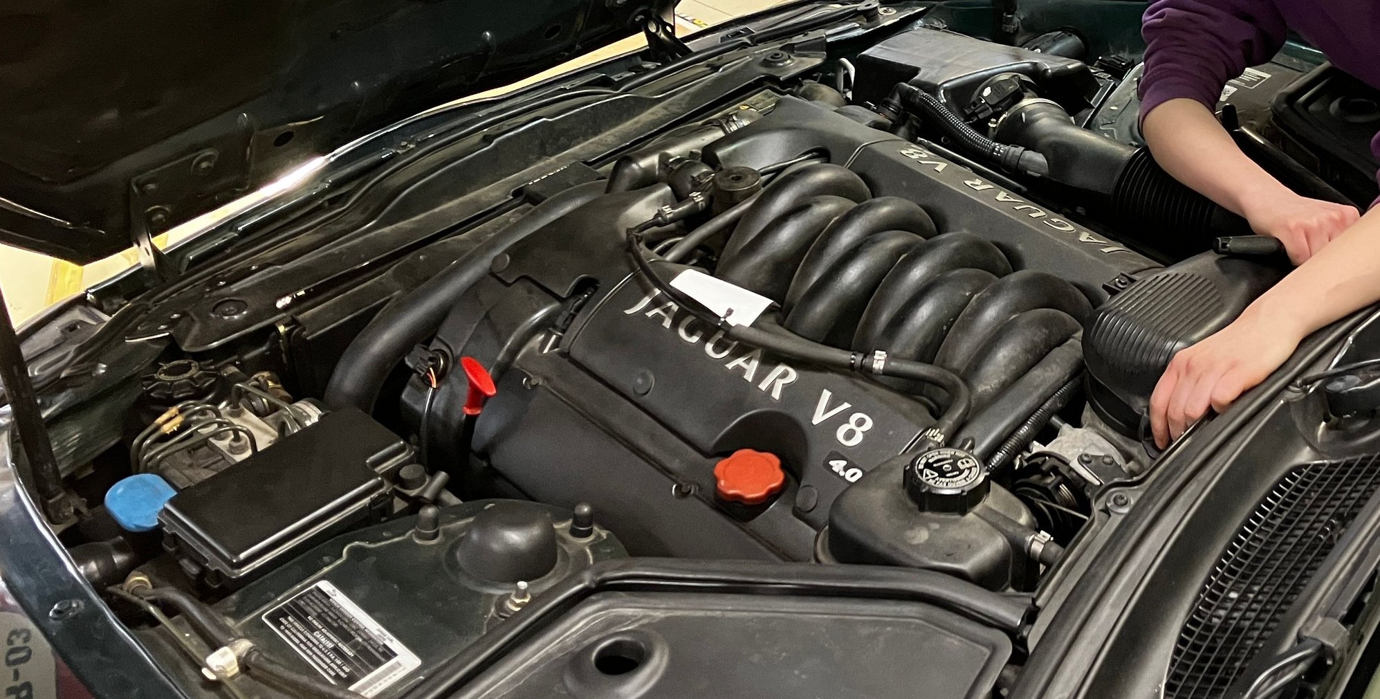

I wanted to order a set of valve cover gaskets, both secondary tensioners, the thermostat tower and other little things before starting work on the car. But the seller requests information about the type of engine. And so I got stuck and traveled here in search of an answer to this question. The car was built in February 1999. I found the engine number with the help of local experienced members! (Thank you very much gentlemen!)
The engine has a build date of 2003 04 09. So is it the whole engine or just the block (?). In the form of the registration office it is stated - engine 3AJD M 8626, engine change on September 18. 2003.
Okay. Is it AJ26 or AJ27? In the US VIN, it is in position 11. C - that is, AJ26. And could such an engine be installed in a block from 2003? I really don't understand this!
To find out for sure and order the correct parts, I'll have to open up the engine and see what the puzzle is.
I am not happy about this scenario at all!
