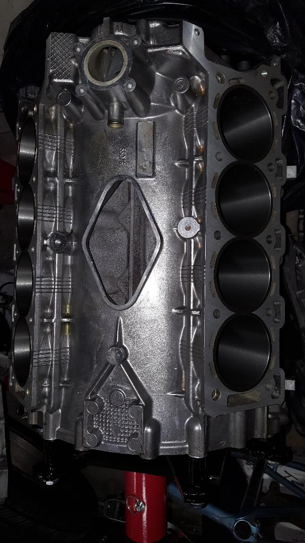

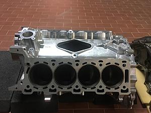

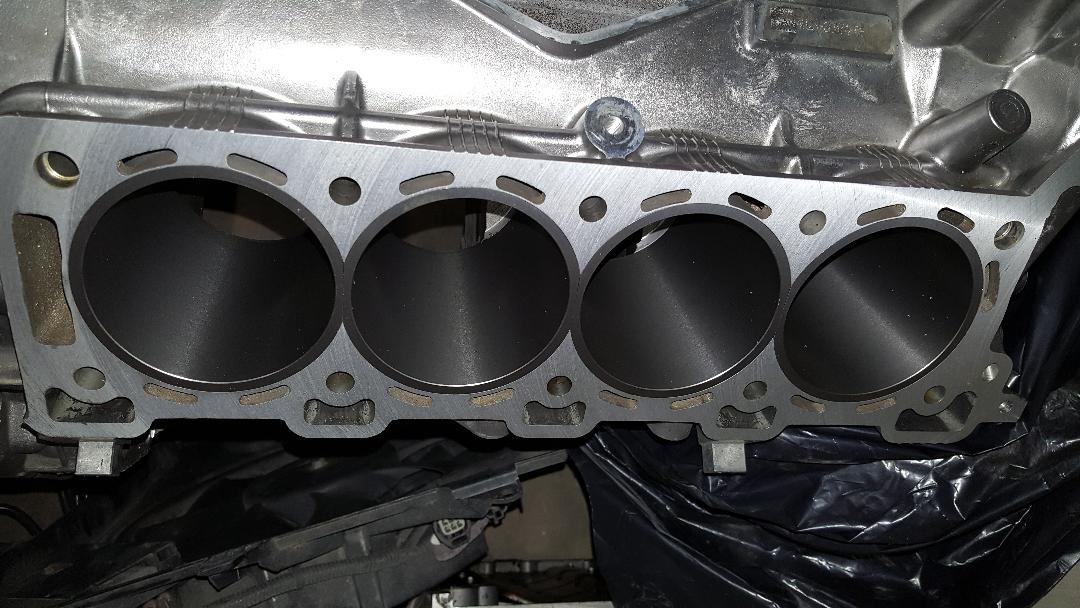

Today start my new project.
Just arrived from Tony Gentilozzi of RSR JAGUAR USA his racing block 4.8L for my xkr coupe year 2005.
Big bore with 92mm pistons .
This is real an exciting day for me !
I'm probably the only private person in the world to have it. ... of this car:
In photos : oem vs RSR JAGUAR

I don't know but for me that looks like standard V8 block...just Darton-sleeved to 92mm? Like some others here in the forum have done.
RSR has made some special bloks for their own racing engines: https://www.jaguarforums.com/forum/j...tom-end-96033/

It looks indeed like a normal standard bored out block, cleaned but take it its used by an old lady who never pushed it ;-)
Maybe the price was ok comparted to make it yourself, that's for duece2000 to tell, it depends also on possible other parts not shown in the picture as only a bare upper block is shown.
There is certainly potential now as I have experienced, its just the intake part that will be lagging behind if he doesn't throw away the Eaton.

Looks like my block that is sleeved to 92mm....
