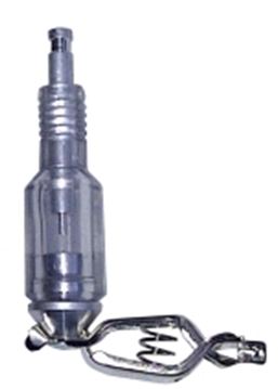

I just got this very cheap tool for checking your coils. It's only about $11 at most parts stores. I think it's too cheap to NOT have one. KD #2756
Maybe get one and check all your coils?

The coil tester I posted came from KD and they have now updated the tool so it's easier to see the spark.
Same price and part number just make sure it says for HEI ignitions. They have a standard one with less gap to jump and that won't stress our coils enough if they are marginal.
This is the one I use
Link http://www.autozone.com/autozone/acc...questid=138015
But I am leaning towards this
Link Heavy Duty Spark Plug Tester - Teng Tools Australia
