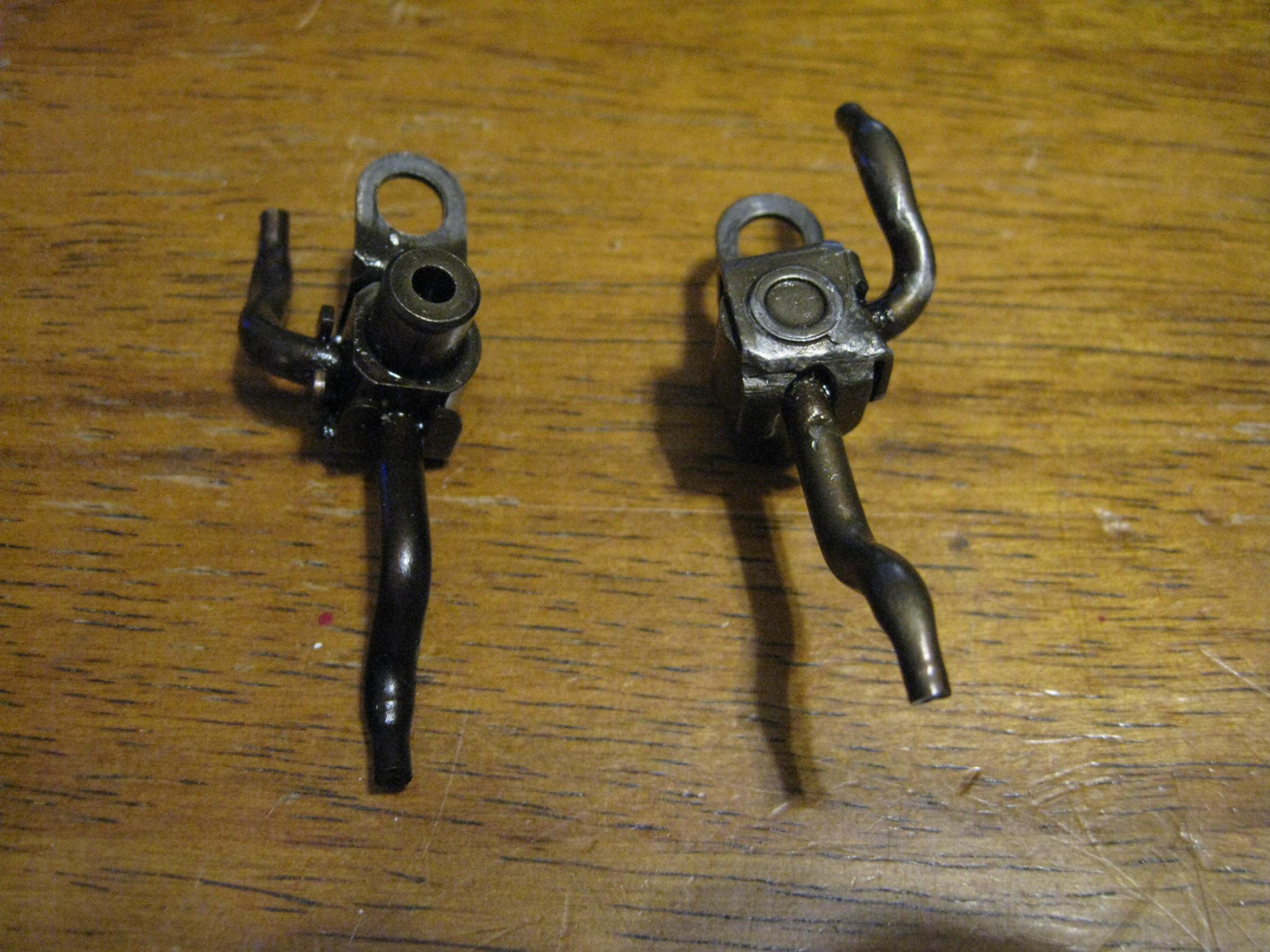

I need to find a source for a couple of AJ34S Piston Oil Squirters.
I've searched the internet and as far as I can tell, they are nowhere to be found.
I am fairly confident that they have been installed in all AJ34 Supercharged engines between 2003 and 2009.
Anyone know of a source? Who makes them? P/N?
Thanks.
Joe
Attached Thumbnails AJ34S Piston Oil Squirters-img_0119.jpg   AJ34S Piston Oil Squirters-img_0118.jpg

Hi Joe;
I have been looking for them for several years and Jaguar does not list them seperately except for the diesel. Those Diesel oil squirters look different so they won't work.
Have you tried used? Maybe someone with another blown up engine?

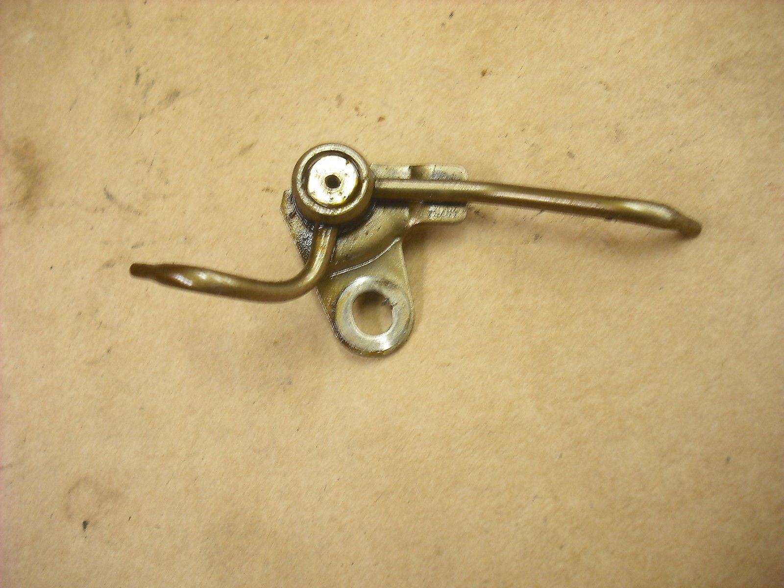

Originally Posted by avos
I saw those and contacted the seller. He states that there is no ball and spring inside them. he sent me the rough diameter of the outlet and it is significantly small than the Jaguar ones. I did purchase these today off of E-bay for a Mercedes CLK. They at least have the possibility of being adapted to work.
I believe that the squirters are considered part of the block. Perhaps one reason for a different P/N between NA and SC block? NA blocks don't have the drillings for the squirters, SC blocks are drilled and tapped and fitted with the squirters.
