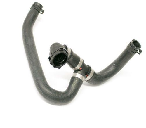

XR849447 is the part number.

Other than the part number, were there any external differences between the new and old hose assemblies? To help the next guy determine if he's got the new or old style assembly, I'd like to be able to say look for large green dot at this tee fitting, or something like that.
Do you have a picture of this hose installed? It would be very helpful to say exactly where to look.

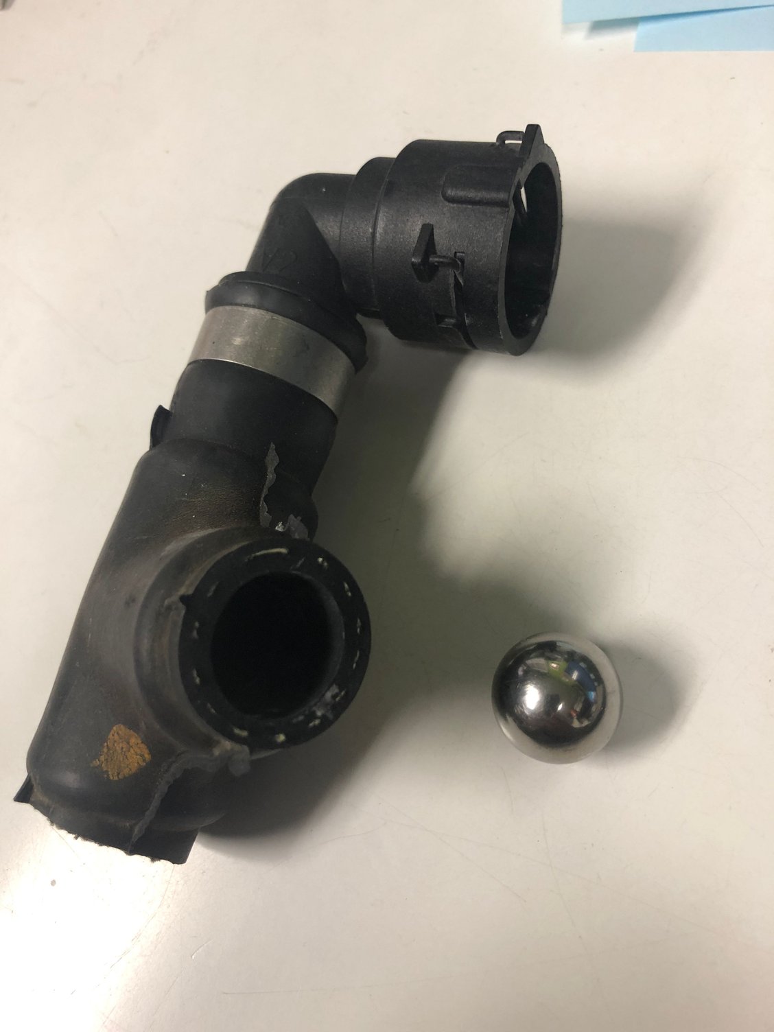

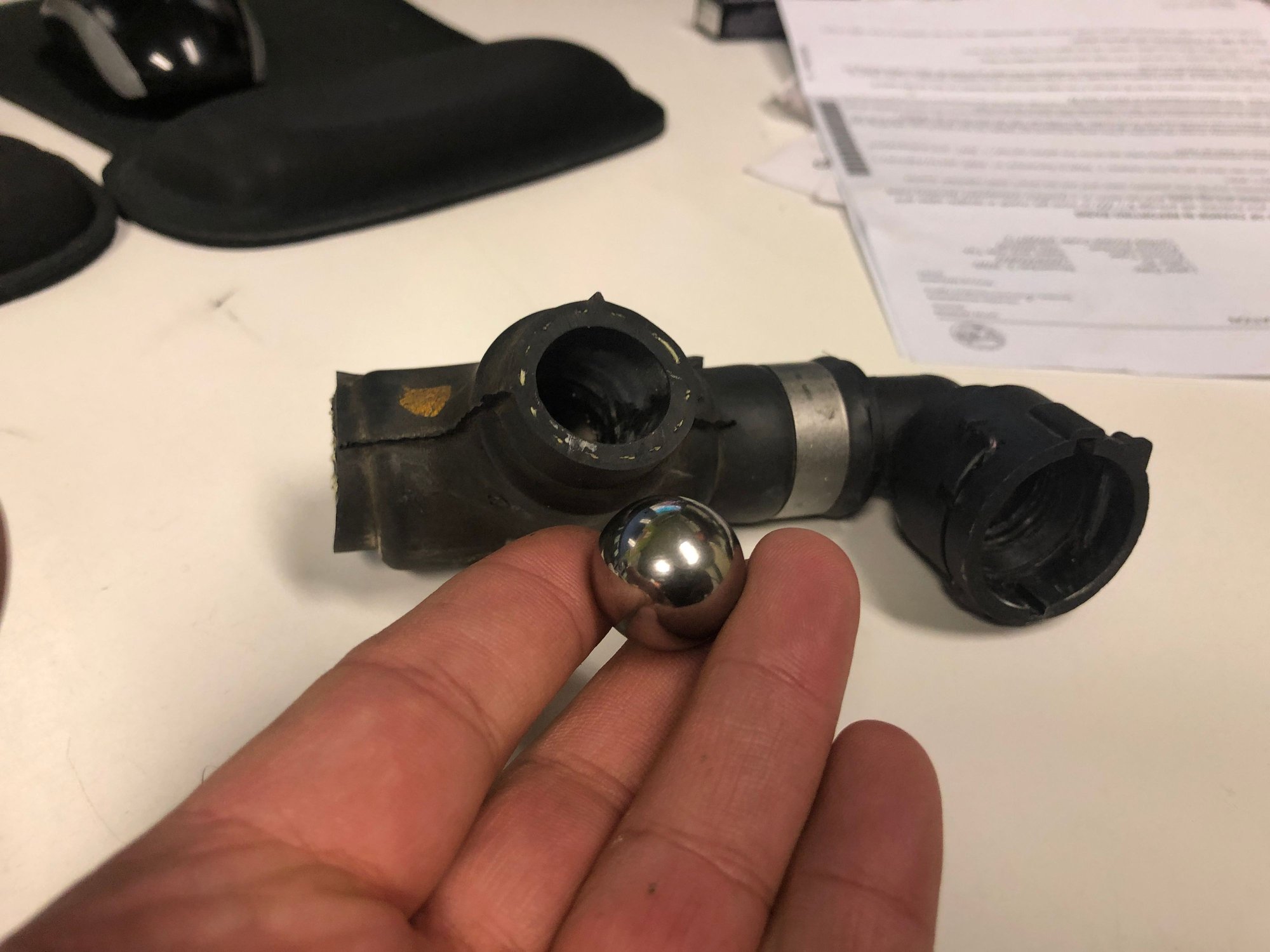

So we made a mistake. There is no valve inside. We cut it open and found a huge ball bearing inside which kept the car from getting heat. Our idea is that the used car dealer was selling this vehicle during the summer and the heater valves and/or a/c control panel were not working, and this was the only way to stop the flow of water to stop the heat from keeping a buyer from buying the car. If someone can edit my original post and clean this up, much appreciated.

Wow, that was some find. We certainly appreciate the update. Your theory makes sense of a quick "fix" by an unscrupulous seller. I've heard of mechanics doing something similar, blocking off vacuum lines by inserting a BB. This would disable the associated component, but everything still appeared intact.

I don't think dealers are that smart. Is there any chance this is a flow stop check ball for liquid going the wrong way? Get a few hoses on backwards and the check ball works. If I see a box of ball bearings on the shelf at a Jag service center, I'm leaving...fast.

It's funny that is exactly what we thought the bearing was. It's possible for sure.
