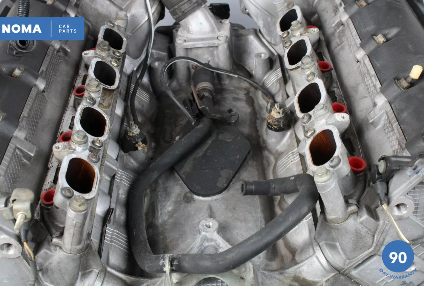

If you need to change the sensor, see pages 790 and 1082. Code P0328 is applicable to the RH sensor, which is on the US passenger's side. The two sensors are located on top of the block, inboard of the heads, hidden under the intake manifold. The following picture, shameless stolen from eBay, shows the two sensors on each side in the middle:
More pics of the same engine here:
https://www.ebay.com/itm/235869702894

With the NA engine it will be far less work to remove the intake manifold to get to the knock sensors. The NA engine also has a coolant hose under there so I would be planning on changing that. I would also replace both knock sensors since it is a bit of work to get to them and you will have everything apart anyway.
