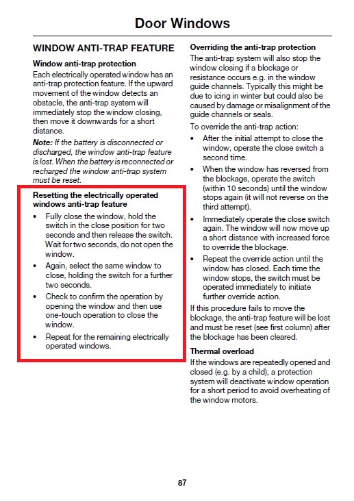

After a battery disconnect, the ANTI-TRAP feature is reset as follows:
This is from the 2008MY Owner's Handbook.
