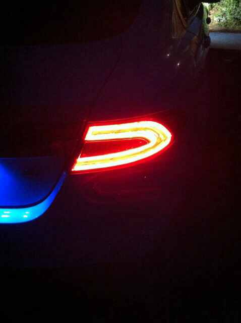

Old Dec 16, 2014 | 08:37 PM
philhef's Avatar
Posts: 2,916
Likes: 544
From: North Carolina
Already added the center boot lights. I wired them to the license plate wiring. Works perfectly but I unwired until I have entire assembly in.
