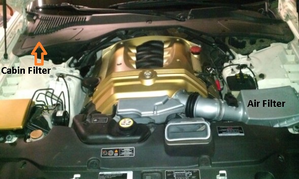

Oil filter or Air Filter? At $115.00 it might be the engine oil, oil filter, and the air filter.

I saw where it goes, upper left side
not oil, then.

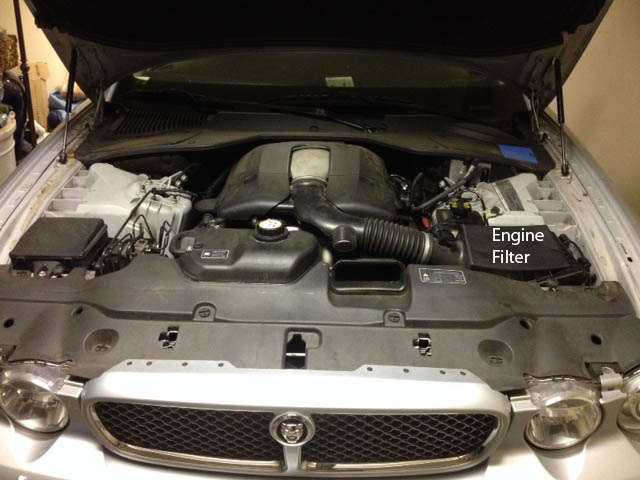

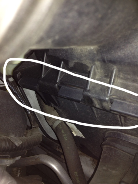

Okay, here I am now. Thanks to Reyesl for photos of where the "engine" air filter is located. How how to remove the cover. The front of the cover is easy, pushing the clips back to unhook. But it is holding in the back. I can't tell if I were to lift (might brake it) push, (might brake it) or what. How do I physically remove it. Here are the photos

Back of case, how do I release the back of the case. It won't lift, it's tight. Whats the trick. The service guy said something about being careful not to brake the clips on the bottom.

Lift up where the clips are, then slide the cover towards the engine to unlatch the tabs on the Engine side. It sounds easy but it is a little difficult. Since I clean my filter monthly and replace it at every oil change, I removed the tabs and are currently using 2 screws to tighten the cover.

see https://www.jaguarforums.com/forum/x...charged-98339/ which has the video

It's possible to wiggle the top off without removing the elephant's trunk, but I suspect that after you've spend half an hour on it, you'll give up and take the pipe off. The top will be in your way otherwise, and I think you'll want to clean out the dirt, swarf and leaves from the box.

In the top pic, you can take the tubing off up to the first "jubilee" (curved silver) clip or right up to the supercharger. Unclip MAF connector (the electrical lead near the filter box) first. Don't forget to reconnect it. (Same with any others you need to disconnect - might not be identical to my STR but looks like it.) Also, don't overtighten the jubilee clip when reconnecting. You just need a seal not a strength contest

I was able to squeeze the engine filter in it's place without remove the whole cover and not destroying the filter.
