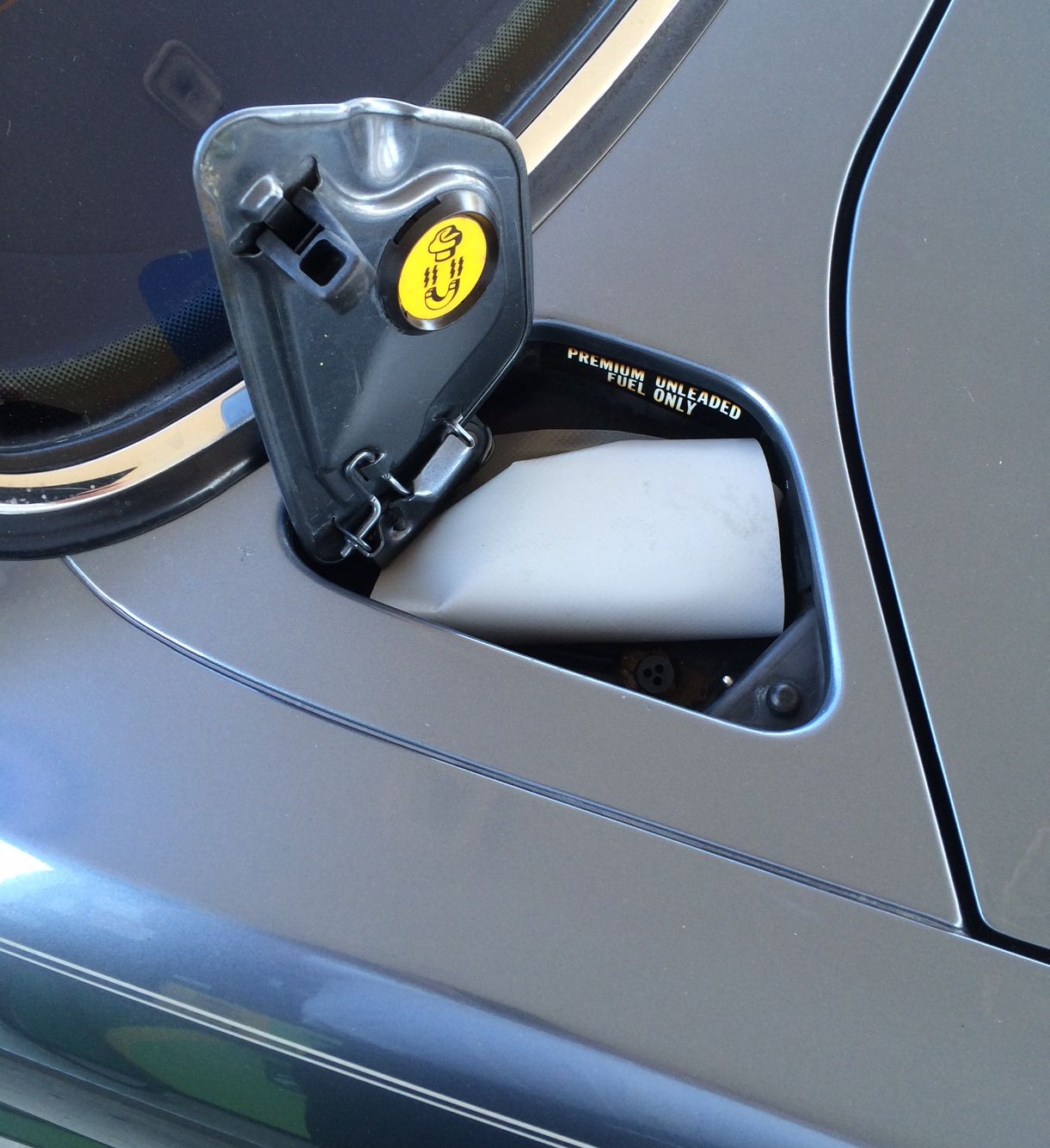

Lightbulb Fuel filler bib or protective flap
Not sure if someone else has already covered this elsewhere, although a quick search didn't turn up any posts on the subject....
Although the rear deck fuel filler on the X300 is a nice styling homage, I've always found it a little less than practical, especially with regard to potential physical and chemical damage to the surrounding bodywork.
So, I looked around for one of the many protective "bibs" or "flaps" that have been available for years on other makes/models of cars to project the area surrounding the fuel filler during fueling.
I didn't find one specifically made for the XJ (which I find surprising, or maybe I just missed it), but I did find one made for Porsches that fits with some minor modification.
The bib/flap is for a Porsche 911 (1965-1973) and 912 (1965-1969). If you find a reproduction of this flap, it will fit if you increase the fuel filler neck hole just a small amount. I think I increased the diameter by about 1/8". It may have also been possible to gently heat the flap and stretch the hole, but I didn't think of that until after I had trimmed it
Anyway, if you like this solution, these flaps are dirt cheap.
I bought mine here (no personal association):
Porsche Fuel Filler Flap 911 912 65 73 | eBay
Attached Thumbnails Fuel filler bib or protective flap-photo-1.jpg   Fuel filler bib or protective flap-photo-2.jpg   Fuel filler bib or protective flap-photo-3.jpg

Originally Posted by mgb4tim
Karman-Ghias had them, as well as the New Beetle. I just grab a paper towel while it's filling to cover the nozzle when removing it from the car.
Yeah, I looked at the NOS/repro bib for the KG, but it has a big rubber seal, etc that I thought would probably not fit. This flap is flat and very simple, and once slightly enlarged just "pops" over the lip of the filler neck.
I had been using a paper towel as well, but that was a minor inconvenience to go find one, plus a lot of stations are often out.

Al, just want to share with you the consequence of having to put a bib versus not to put anything there, the gasfiller tank is designed with an existing molded soft plastic with a drain strainer plug (usually debris would clog up that drain strainer) all that's needed is to pull that plug out, clean and replace, with a bib it will cause that area to flood in case of a down pour or car wash, causing the gas tank cap and its lips to rust/corrode will post some pictures soon
Old Jun 9, 2014 | 12:54 PM
al_roethlisberger's Avatar
Posts: 3,750
Likes: 688
From: Sanford, NC
Thumbs up
Hi, thanks for calling that out.
I had accounted for that issue, and this bib in no way blocks that drain.

After reading these I decided to try a make one from an old inner tube I had and you can see the result. Just cut freehand in about 5 minutes and any thin rubber would do but, it works and is free!
Good job! That actually covers the entire area better than the one I bought
BTW, mine has worked out great, no issues with drainage and it has absolutely protected the paint around the filler. I'm really glad I found this cheap option.
The only minor caveat is that you do have to work a little harder to clean out debris that gets in the cavity as it can get under and behind the flap. But it just takes a little effort to do so.
