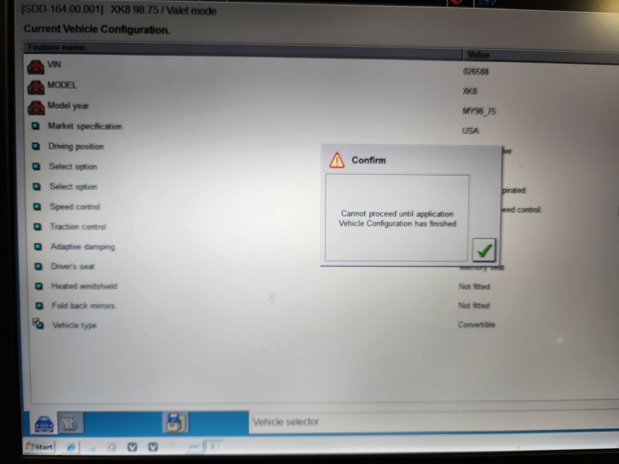

When I run the IDS, it lets me see dtc's, but when I try to navigate to other functions, I get these screens. Then to close I have to run task manager to end task....any ideas?

It looks like you are running SDD in Legacy IDS.
I have no clue how to proceed because when I enter the VIN it asks if I want to read DTCs.
If I answer NO, I can go anywhere with the upper or lower tabs.
I am running IDS with a Rotunda VCM just like I did at the dealer.(no SDD)
Not familiar with SDD at all. I left the dealer before SDD was issued.

I open up the program that starts with sdd, but when I put in the vin, it prompts me to start legacy IDS, which I do, I am able to read dtc's, but then I does the configuration screen....is there any way to download a separate IDS only program?

Yes you can use IDS without SDD but NOT with the Mongoose type 'dongle'.
You NEED a Rotunda VCM and the two cables. (USB and OBDII in/out cables)
It is all in the training documents.

Like Bob, I have only ever used native IDS rather than through SDD.
However, looking at your screen shots something is not right. The VIN number shown doesn't look like an X300 number (which I think should be in the range 720125 to 812255). IDS is interpreting the model as 1998 XK8.

I have 2 cars, a 1998 xk8 and a 1996 xj6, hence the x100 vin, but the question is about IDS, I have to start SDD, and when I enter the vin, the program reverts to legacy IDS. The problem begins when I start to navigate through the levels, I get this screen......
