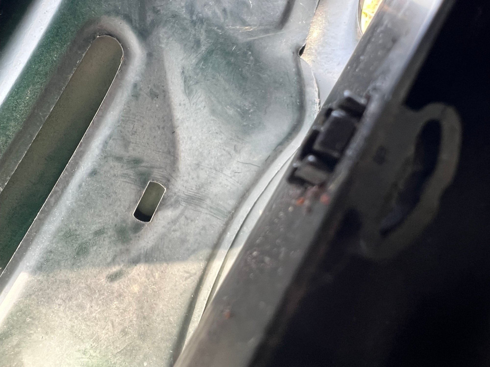

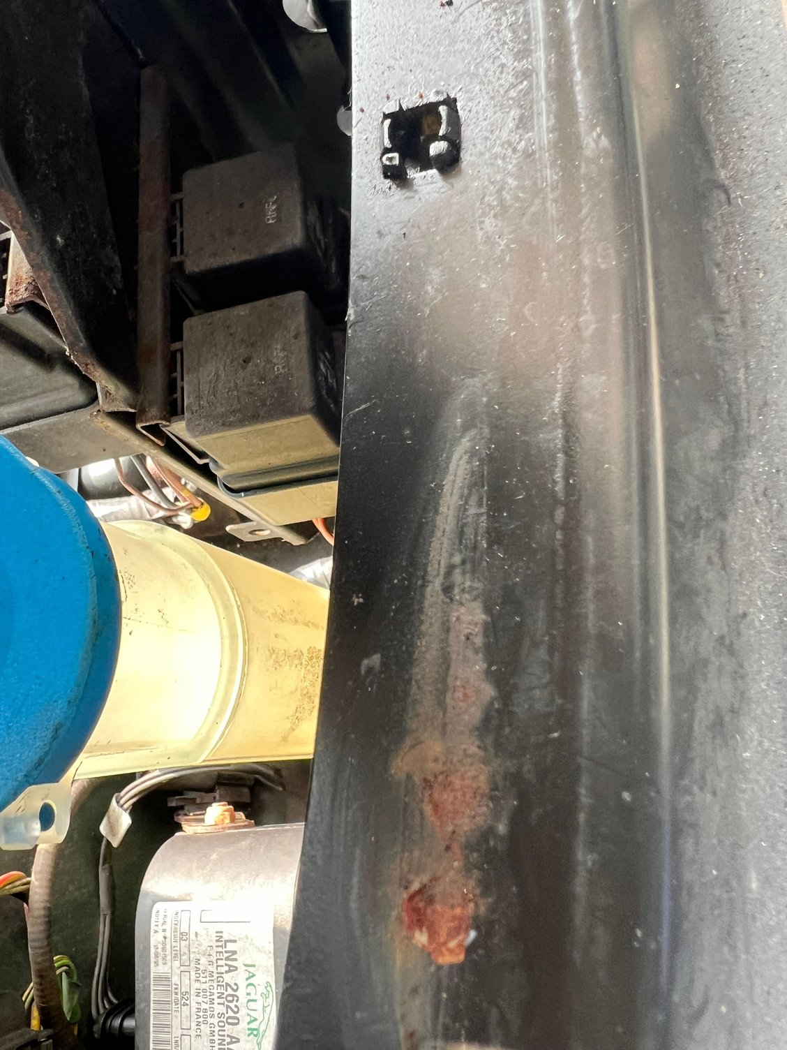

The engine compartment has several plastic panels that have ¼ or ½ turn screws that hold them in place.
I need a handful of the sockets that the screws engage in.
what are they called?

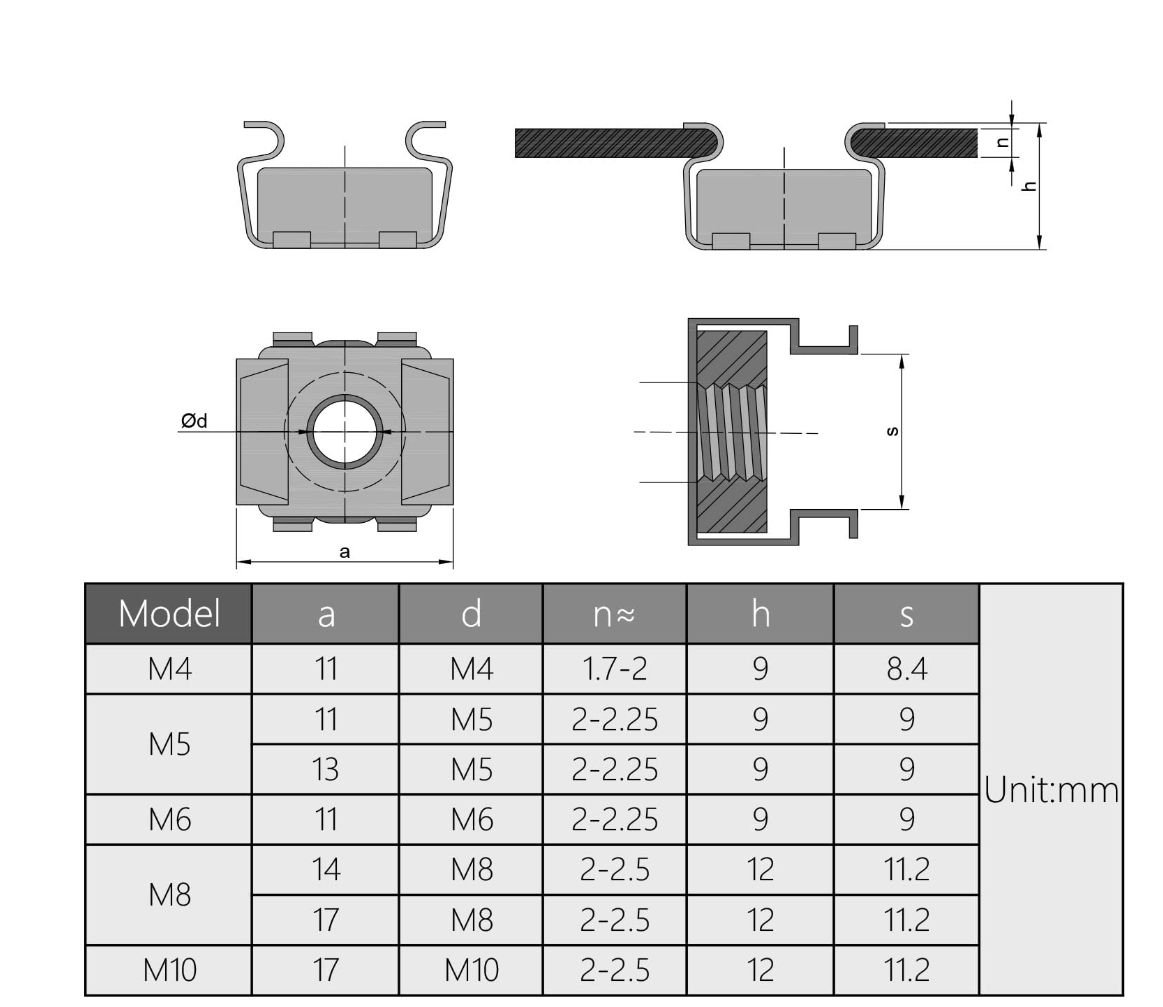

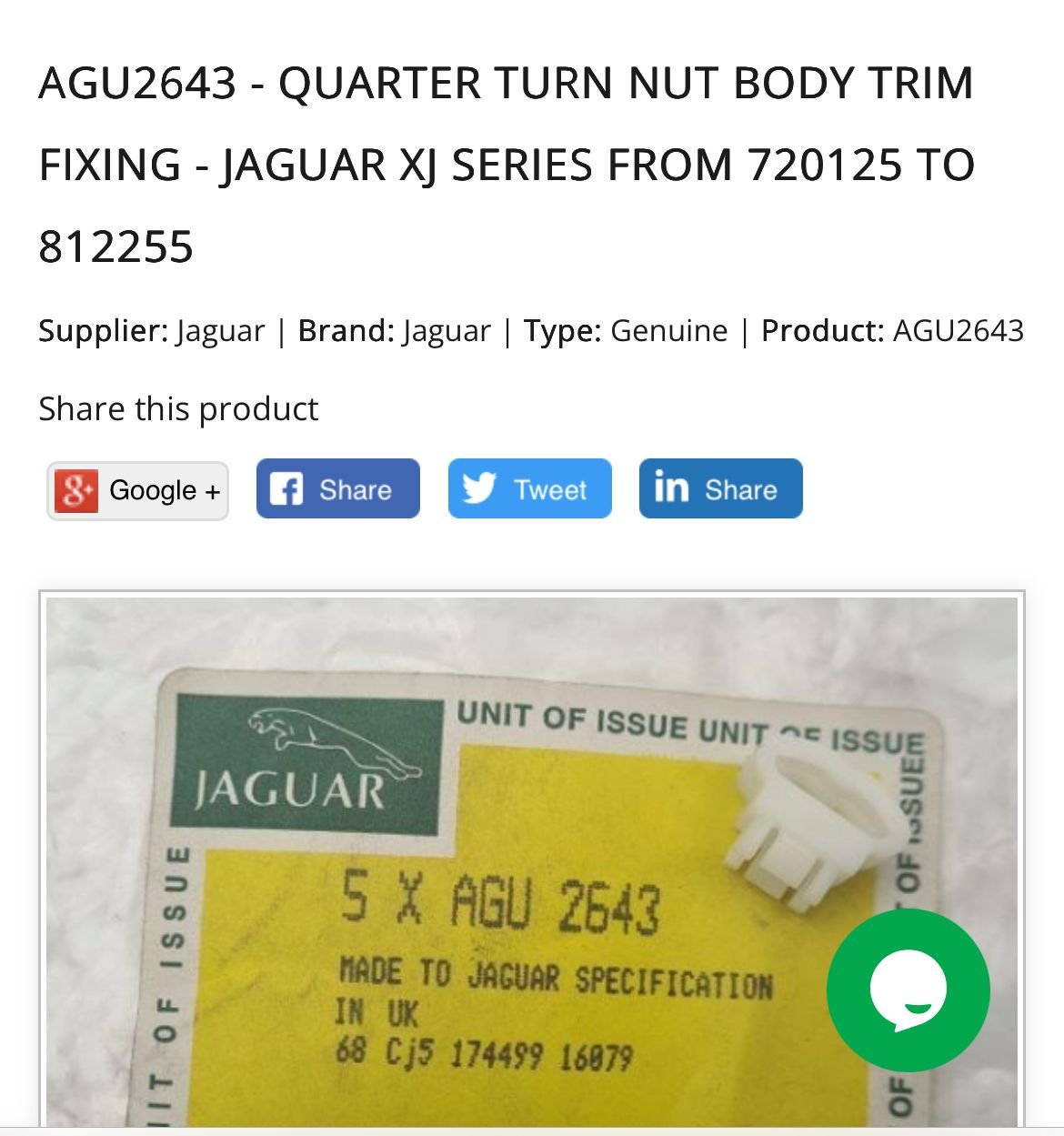

They called "Quarter turn nut AGU2643" and you will be quite surprised on price... People use cage nuts and regular screws as an affordable fix. M5/M6 size fits pretty well.
Nylon mushroom screws will look pretty much stock BTW.

I lost a couple of the nuts into the abyss behind the headlights several years ago and after I got my replacement nuts I glued them into the hole so they don't fall out.

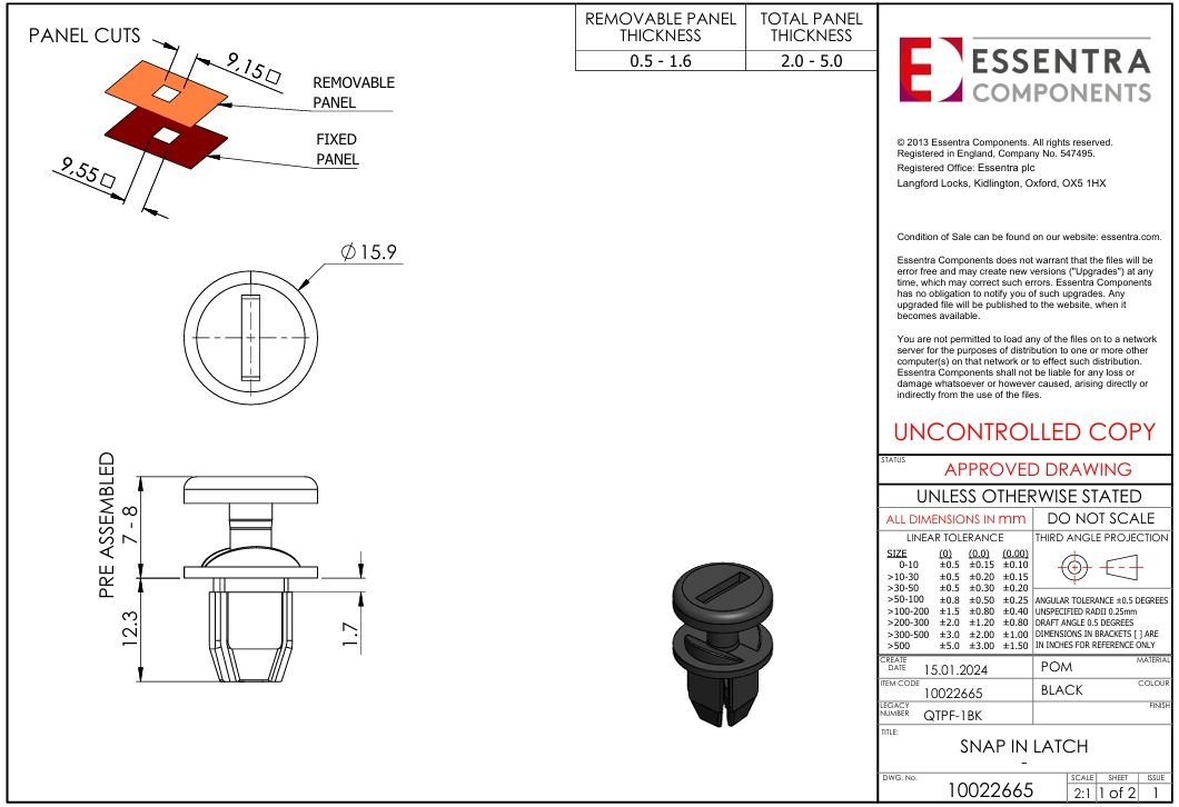

https://www.essentracomponents.com/e...k?indexed=true
This might be a solution. DigiKey has them in smaller quantities.
https://www.digikey.com/en/products/...PF-1BK/3814563
