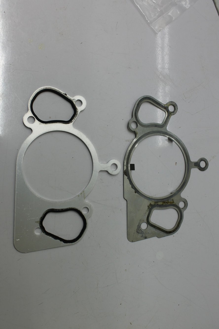

I had the blower off and replaced all hoses along with the water pump about 10k miles ago. Here's a pic of the old gasket (right) - about .01" thick metal with a raised bead around all of the ports that compresses when installed. You can see where there was leakage between the center and right chambers - not sure where the leakage was to the outside. The new gasket is .06" thick with rubber gaskets around the outside chambers. I assume I install this dry? Or should I use some gasket compound - I think I have every product Permatex makes - Ultra Black, Hylomar, Ultra Grey, The Right Stuff ... never know which to use in any given application. Appreciate any advice.
You can install it dry or with a smear of silicone.
