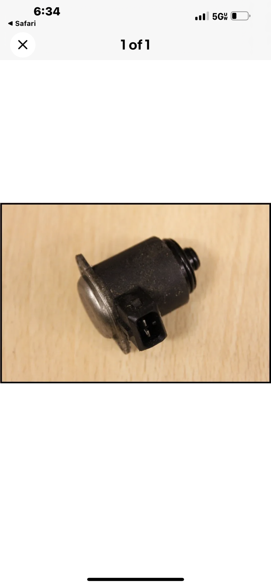

Hi, my 2002 x308 is in need of a “steering rack transducer” also known as variable assist power steering solenoid. Can anyone help me to find one? Only one I see is in the UK and they will not ship to the USA. Thank you in advance.

This is the part I need- thank you! Sorry trying to upload a picture of the solenoid

I believe it’s part number ZF 7039-442-214 it is variable assist power steering solenoid.-also known the steering rack transducer. According to the dealer this part does not have a Jaguar part number. Thanks again!

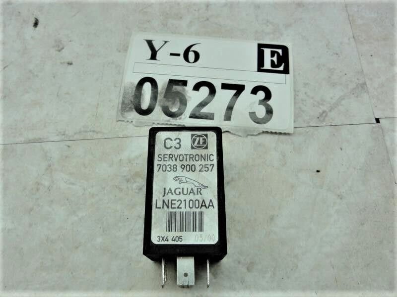

You should go by the Jaguar part number. LNE2100AA (the one shown on the provided Ebay link) is correct for your 2002 car because it is for use on VIN 853936 (~1999) and higher.
he needs the rack solenoid not the VAPS controller
Thank is correct

But when given the link "tinyurl.com/msmw3bxx" (which shows the part on the pic below), VDP P said "This is the part I need- thank you!". Perhaps this needs to be clarified.

Yes the solenoid was tested with an ohms meter and was out of spec, thus sending incorrect pressure to the pump/rack

Thank you - actually a 2002 super v8, new solenoid solved the problem!
