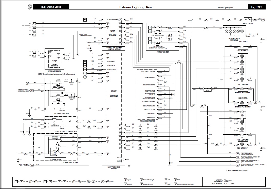

I know this is an old thread but I seem to have run into an odd issue. The circuitry for the right brake lamp is okay - no shorts or breaks. I am still not getting any power from the right stop lamp pin on the SCLM even though I replaced the chip with the Mouser one. I opened up the SCLM again and resoldered the connections, checking continuity afterwards. Still no joy - 0 volts on the pin with the brake pedal depressed. I'm running power from the trailer connector to the right brake lamp to be legal. Has anyone experienced failures within the SCLM besides the driver chips?

The BPM (Body Processor Module) is also part of the control circuit for the tail lamp units.
Reports on the forum suggest it is a more frequent fail than the SLCM.

The tail lamps, yes, but the SLCM drives the brake lamps. I'm getting no RH brake output voltage at the SLCM. The other side works fine. I believe the BPM only monitors for bulb failure. The wiring and bulbs all check out.
