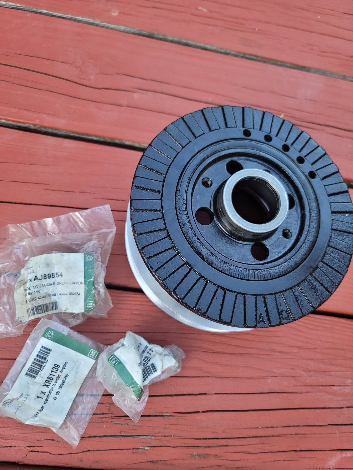

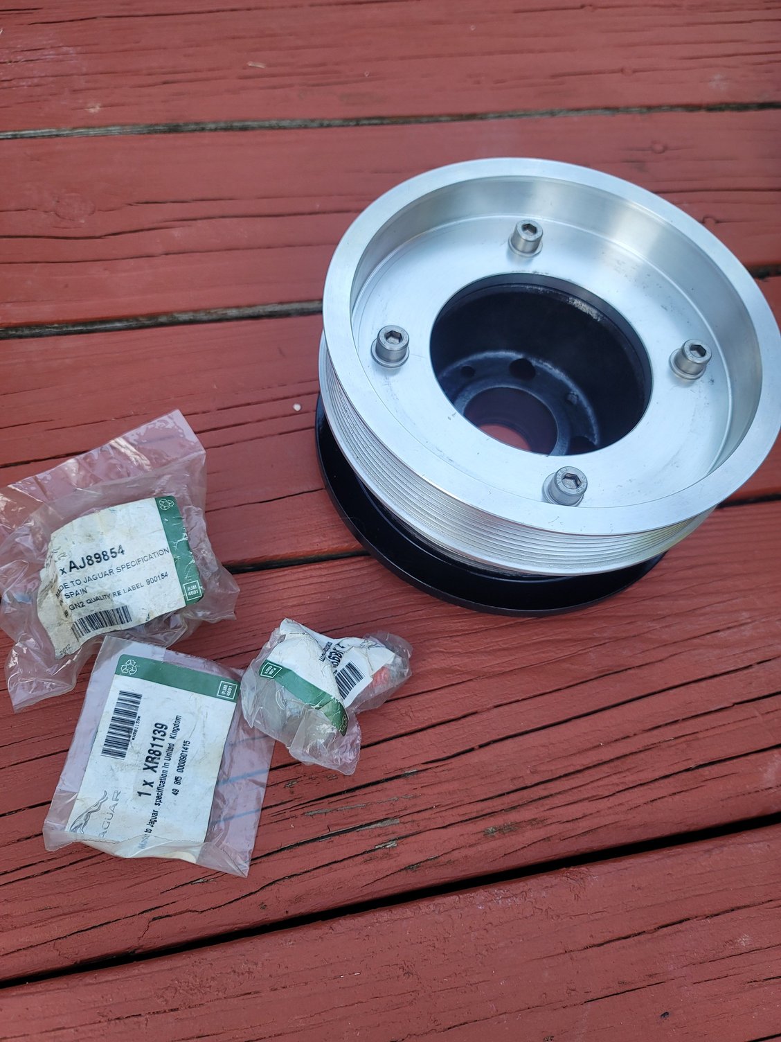

i have the crank pulley up graded by powder house UK

I only ever installed one of those on a customer car.
Since I have two XKRs, I should get at least one?
You know you want to Bob!
Go for it!
