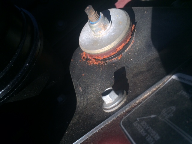

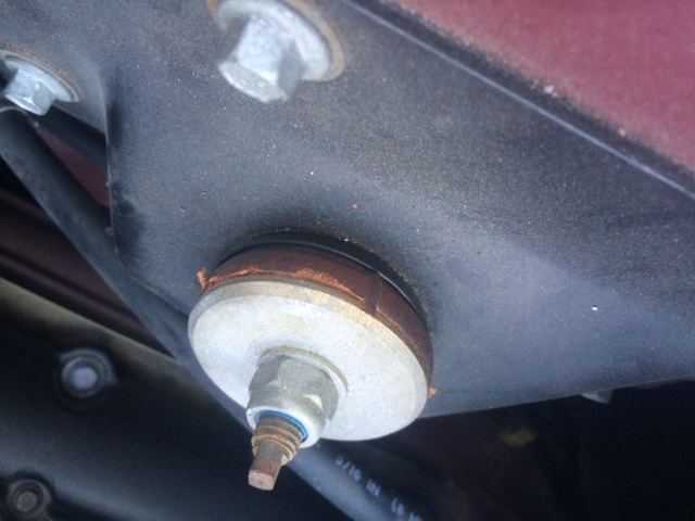

Had one of the aamco guys take a peep at these he says nothing to worry about yet.
Just wanted a second opinion.
Question 1: What are these even called?
Question 2: When should i have these replaced?

Those are your front, upper, shock mount bushings. Extremely common on these cars. I may tend to believe that there is some life left in your bushings. I would investigate replacements and plan on replacing in the near future.

I disagree. That rubber is dead. This is a easy DIY if you buy the pre-assembled mounts.

+1 they are dead. I would plan to replace them as soon as possible to prevent any possible damage from complete failure. There are many threads on replacing them.

Agreed. I'd replace at any sign of any serious flaking , cracking, or bits and pieces rubbing off, especially like your first picture shows. Unless the bushing is still solid and pretty much smooth all around, I'd replace them. Even cheaper if you have access to a press or someone with one, that can just swap bushings instead of having to buy the whole assembly.

If they aren't clunking you have some time. Can be replaced with poly shock bushings if you have a press or a vice, or the whole assembly can be replaced (an easy job).
When the bushings go you will get clunks when the front wheels go over bumps. Until then, it's really not that dire.
