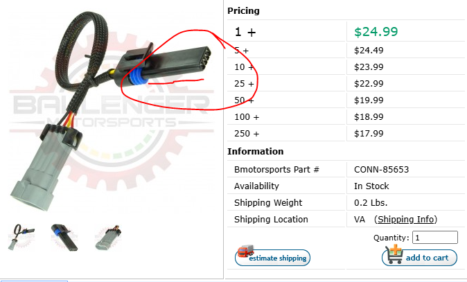

I'm an expert on the optispark and Lt1 system in general. Here is what you can do to get started. It's a very simple system that mostly relies on a hitachi optical trigger wheel inside the optispark unit with a hi and lo resolution signal that the PCM uses to trigger ignition, spark and injector pulses. .
Hook up a spark tester to the coil output, when cranking you should get spark, fuel injector clicks and fuel pump.
- If you do then you have a good hi and lo res signal from the opti unit, check for spark at the plugs and fuel delivery to the rail.
- if you only get fuel pump, the high res signal may be bad or the ignition module may be bad, or the opti pigtail is bad, replace all three (start with the pigtail)
- if you get injector clicks, the hi and low res opti signals to the PCM are good, if no spark then change the ign module
- if you get neither fuel pump, injector clisks or spark, the Low res signal may be bad, replace the opti and check the pigtail.
- if you get fuel pump and spark for only a few seconds then stops, you have a VATS problem (add VATS defeat device or program PCM and remove VATS, I can do this)
When checking and replacing the opti there is an unusually long plug with connections deep inside the opti as shown below, you must be EXTRA careful to make sure you have a good connection here with no misaligned pins. It's kind'a easy to misalign the pins inside the opti when removing and replacing things. If any of the pins inside the opti plug come out of alignment you lose the hi, low or both signals from the opti. I have fixed MANY LT1 opti cars that didnt run but where "everything was replaced" and a few mis-aligned pins inside the new opti from a ham handed mechanic was the only problem.
More difficulty arises when the retrofit installations are not done properly, and most are not. I've seen where an inexperienced installer will wire the fuel pump and fans directly to a +12 ignition source so those PCM triggers can't be used for diagnostic purposes, that's not helpful , its unsafe and needs to be corrected if this is the case.
