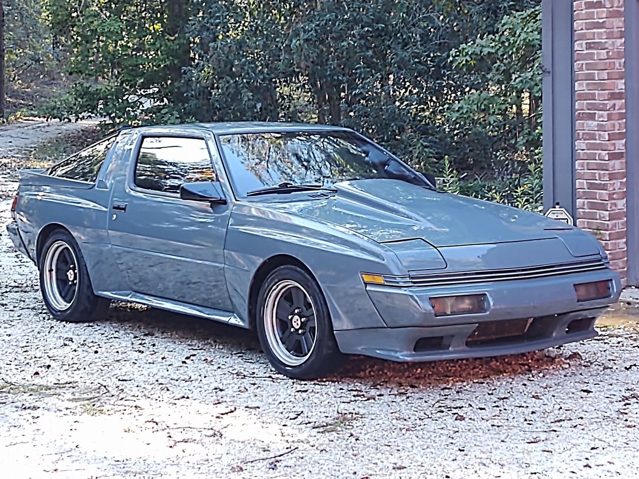

I've had 10 Jags and 5 Conquests/Starions. I'm a bigger fan of the G54B engine than most but swaps are almost more common these days than the original engine due to a combination of reliability (head gaskets, etc.) and difficulty in getting them over about 280-300 hp without having to do tricks. The MPI version of the engine, which was not sold in the U.S. market, is a much better setup. The first swaps for that car centered on the 5.0 Mustang engine, but you're much more likely now to get an LS swap or a 1JZ/2JZ.
We're doing a 3.7 Slant-6 in another one at the moment that's probably going to make close to 275 hp and 350 lb/ft when it's all said and done, using a Holley Sniper setup. The focus will be reliability over raw performance (and the iron block/head combo for the Slant-6 will make that particular car more of a GT than a true sports coupe).
The big hangup in the V12 project is that I hate automatic transmissions universally, and this car will have to have a manual unit of some kind. I'm running a 700R4 in my '89 XJS right now and it's a great match for the motor, but I don't want to repeat the setup in the Conquest.
Conquest pic for attention:

good lookin car !
