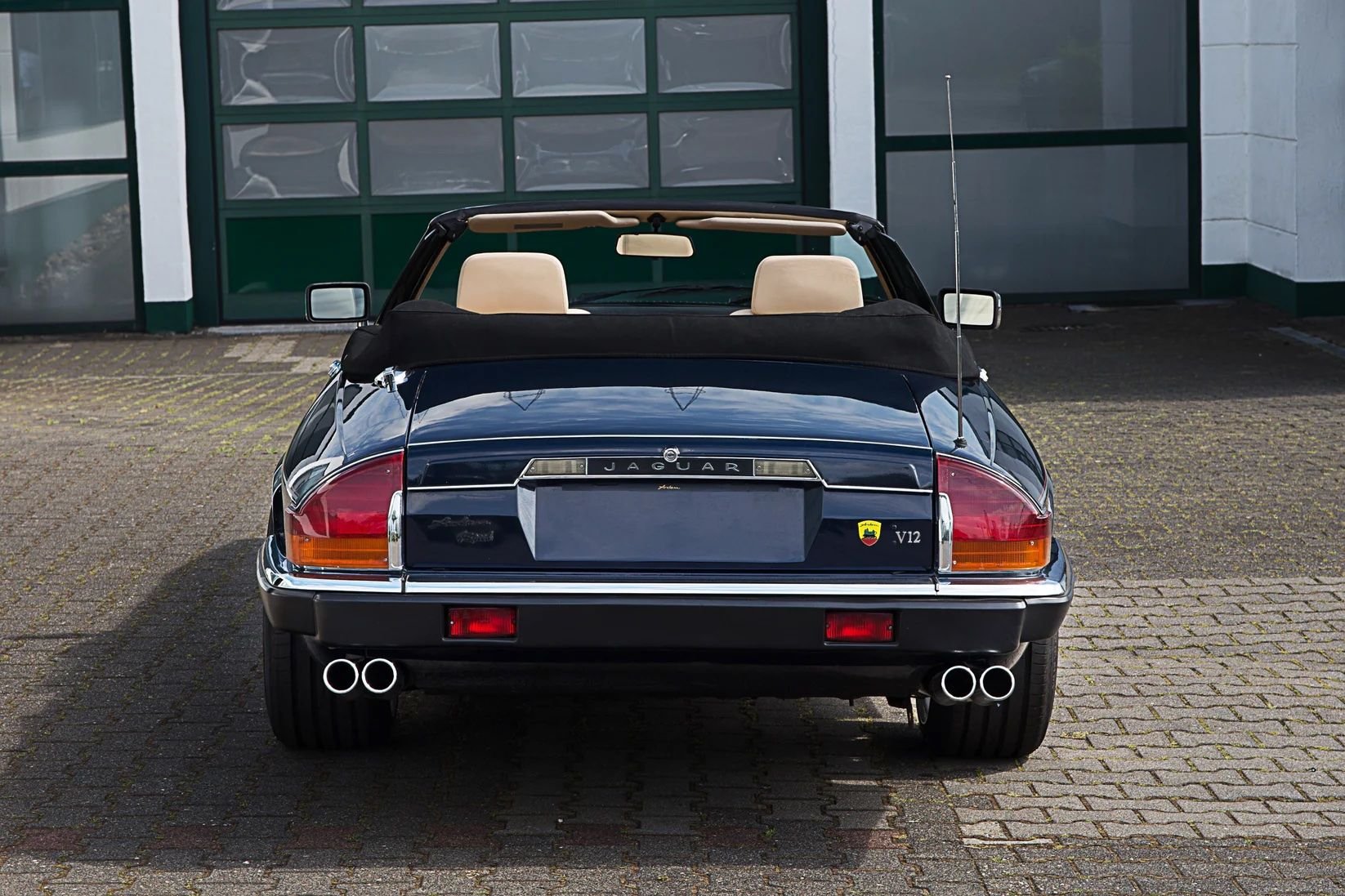

The one thing I did differently than Tibbetts was exhaust tips. I choose to try to replicate the XJRS and Arden dual tip style. From Arden or Simply Performance they are quite spendy, which I didn't want to do on an experiment that might not be permanent. The tips were the hardest find of the whole thing. I ordered and returned a couple sets that were just too large and looked out of place on an XJS. I finally found some on Ebay that were the same proportions as the Arden tips (~2 3/8"/60mm diameter). Other than the Arden crest, the attached photo looks identical to my car.

I don't suppose you have a link to those tips on ebay?
They look nice.

Beautiful looking rear photo along with the tips. Been looking for some myself without good success. Like Doug, could you send me a link too?
What rims are you using on your car? I think I see some daylight shining through them to the underneath. Looking at some possible options for mine.
I just checked eBay and that seller no longer lists any exhaust tips. They used to have about a hundred different listing for tips, so I don't know what they're up to now.
btw, the car in the photo isn't mine, it's from the Arden website (though it looks identical to mine except for the Arden emblem).
